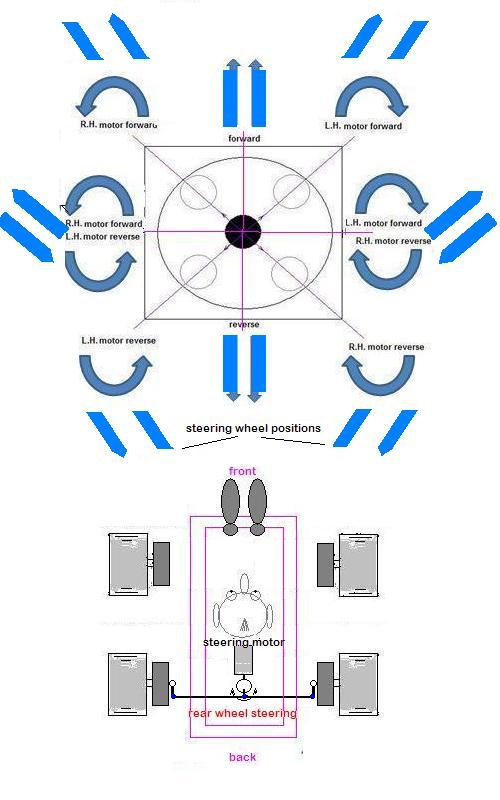

Re: Invacare gb motors
Postby LROBBINS » 31 Dec 2011, 16:17
Woody,
My understanding is that in Dynamic systems the "brain" is actually in the joystick box. It not only sends instruction packets to the PM or CLAM, but also receives packets from them. So, for example, if the CLAM's packet includes a "slow" inhibit because an actuator is moved, the joystick "brain" receives, interprets the % slowdown as programmed, and then sends that as a packet that is received, and acted on, by the PM. If the "brain" were in the PM, as I think it may be in P&G systems, the joystick box would have a more limited role. Actually, every module on a CAN bus can both receive and send, but some don't do much with received information while others do - as is the case for the main microcomputer in the "master control remote = joystick box". The attendant joystick module is a "dumb" joystick and there has to be a "master control remote" somewhere else in the system. (Dynamic does store a backup copy of the program parameters in the PM, in case the joystick module fails and a new one is put on, but the brains are in the "master control remote".) I think JoeC could correct me if my memory has failed me on this.
A possible problem in Denis.B's setup is that the joystick analog that feeds the rear PM may be only a joystick so that the slave system actually has no main computer and the PM gets only raw joystick information, without the modifications that would be applied by the programming. (That could also create situations where the two sets of motors are fighting each other causing problems with regeneration as well as turning.) I don't know if that is true, but until the master and slave systems are isolated it's hard to know what's going on. If the joystick analog is like an attendant joystic, one solution would be to add a second "master control remote" between it and the rear PM - a good one might be the no-longer-manufactured SCR (specialty controls remote) that has no joystick pot, but has a brain; I think Martin actually has a used one in his shop.

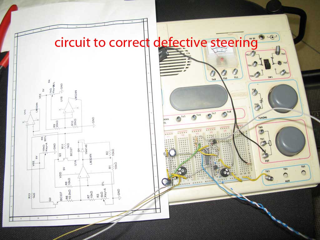

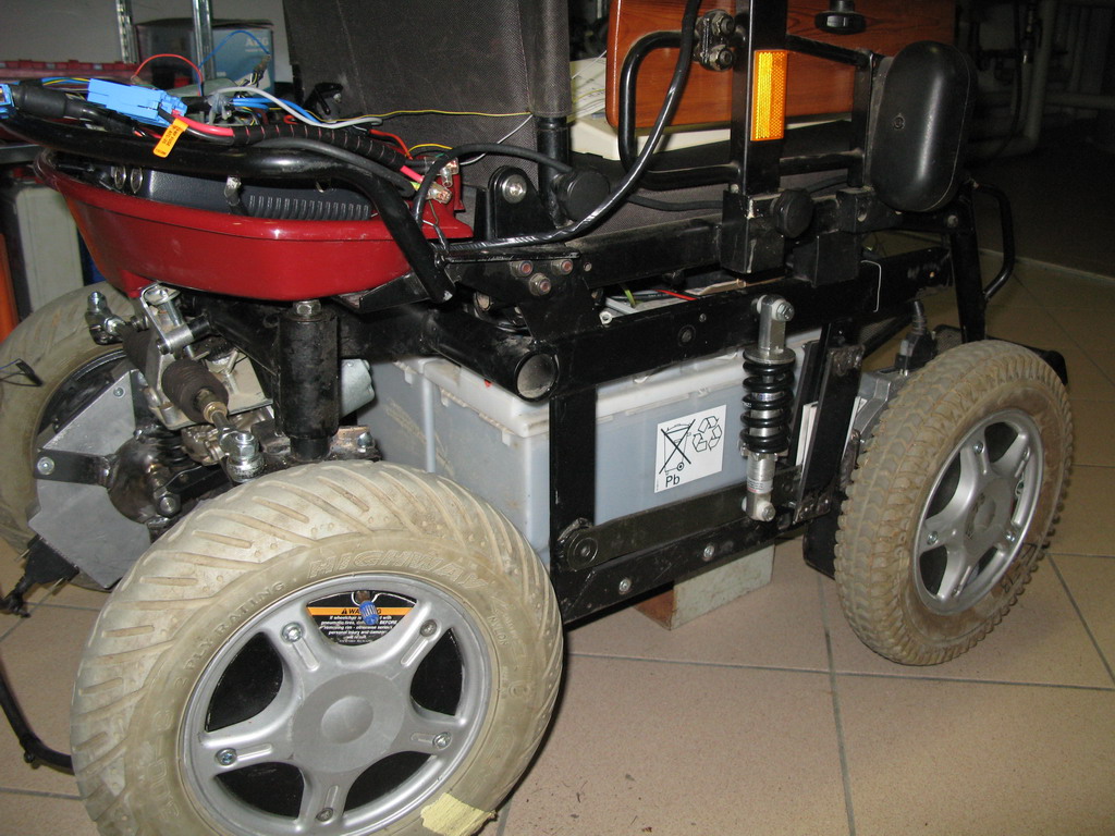

Postby denis.b » 31 Dec 2011, 16:27
Here are some photos of the wheelchair.
As I told you is yet to be completed.
Missing cover the Recaro seats, the new arrangement of the wires out from the engine by removing the connectors and other things.
The problem I solved by using the steering circuit (three operational amplifiers) as shown in the picture.
The wheelchair will usually work with front-wheel drive, steering rack and pinion driven.
The rear electric brake control unit is powered from the front.
With the wheelchair stops all the wheels are locked.
I select the all-wheel drive only when necessary to avoid unnecessary consumption.

Postby woodygb » 31 Dec 2011, 16:41
It maybe better to reconfigure with one control module per side.
Here's another pic ...I'll delete some of the others.
Sterzo correct.JPG (44.93 KiB) Viewed 15533 times

So you have got mechanical steering!
My mistake.

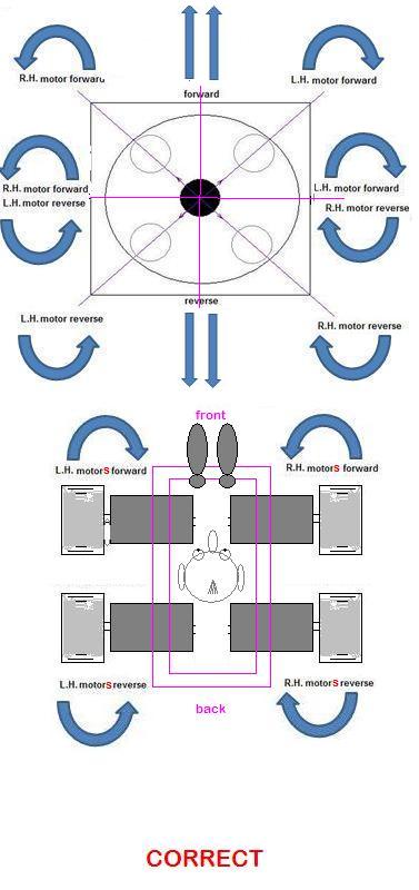

Postby woodygb » 31 Dec 2011, 19:27
but if it works the problem is solved!
If Denis is satisfied ..then GREAT!
This is how I have imagined the combined setup to be.
Sterzo correct2.JPG (51.66 KiB) Viewed 15504 times

Postby shirley_hkg » 01 Jan 2012, 07:56
denis.b wrote:
but going back to the steering is reversed by turning left goes right and vice versa.
;) It is absolutely normal that I pull my joystick left and back ; IF I AM BACKING TO MY RIGHT.
Did you mix up something ? It's a wheelchair , not the same as a car.
Postby Burgerman » 01 Jan 2012, 10:23
Thats what I said about 20 posts ago! Joystick controls rotation of vehicle seen from above. The opposite from a steering wheel. Which rotates the other way when reversing.

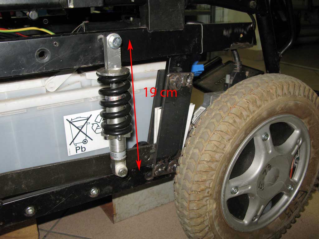

Postby denis.b » 01 Jan 2012, 17:08
"Penso che Denis brontolava che lo sterzo meccanico della 4WD si comportava COME un'automobile invece che come una carrozzella. Voleva il comportamento uguale alla carrozzella tipica: joystick a destre = "naso" a destra sia muovendosi in avanti, sia muovendosi in dietro, invece che come in una machina: volate a destra = "naso" a destra andando in avanti, "naso" a sinistra andando in dietro. E' riuscito a farlo invertendo elettronicamente il segnale al motore dello sterzo (il quinto motore!) quando è in retromarcia."
it is so!
The steering problem I solved it with a circuit that detects when the wheelchair goes back automatically reverses the steering from left to right.
Another thing I would ask you where to buy two oil shocks absorber with adjustable load long approximately 19cm.
What you see in the picture is too rigid (1250lb) and has no oil shock.

Re: shocks
Postby Martin O Refurbisher » 01 Jan 2012, 17:29
The F55 shocks are made by:
http://www.hagon-shocks.co.uk/
Best,
Martin
