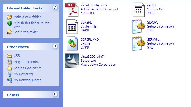

Tried following the "install_guide_win7" pdf in the USB download? ...USB\win7
Postby segreen » 24 Mar 2012, 22:31
BINGO!!!
Thanks Woody, working now perfectly. All I did was just follow your last post and one of drives just worked.

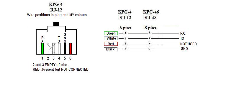

Postby brax » 28 Mar 2012, 02:34
Woody
I bought this cable.
http://www.ebay.com/itm/120869703645?ssPageName=STRK:MEWNX:IT&_trksid=p3984.m1497.l2648
i was supprised to find only 3 wires in the lead red, white, black.
the driver disk they sent me was defective.
downloaded your drivers and tried black and white connected as per your instructions, the absence of the green baffles me, says kpg4, no go.
I will go back and try to buy the same brand as you.

Postby woodygb » 28 Mar 2012, 08:25
My lead used the "universal" USB colour code.
BUT ...others don't.
Check the RED with a meter or pop the USB case... you will find that the board has TX and RX marked on it and see which wires go where..
If it's like John's in Canada the RED isn't a 5V line..... So it's more than likely red/white and black.
Postby woodygb » 28 Mar 2012, 09:34
Pop the case and you will something like this....
Note the colours and attach to the appropriate XLR plug pin.
You could also assume the Black is always GND and the other two wires ...by default...must be RX and TX.
Postby woodygb » 28 Mar 2012, 10:12
A drawing showing the posItions of RX TX and GND in the RJ12 and RJ45 plug and the colours of mine in a RJ12 .
