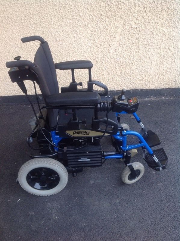

Would you think something like this is acceptable?
Postby Burgerman » 04 Sep 2018, 20:46
Well its better, and must be chair mounted rather than loose, I would think. But its too short and wouldnt give the required accuracy of sick position for me. You need to be able to decide to use 3mm of extra stick in a turn or to control acceleration accurately etc. And there should be a selection of ways to do this. Because every quad is different here. Most likely couldnt grasp that shape.
Posts: 71117
Postby woodygb » 04 Sep 2018, 21:49
In this scenario you negate the problem of pod / hand / thumb disconnect caused by bumps ,loose chair arm etc by NOT having it chair mounted ...
Last year I made one for a young lad that was twisted / deformed ...sorry I do not the correct term ... , his hands could not control a std joystick and thus he had no autonomy .... he was however adept at playing games and the Wii Nunchuk ( plugged into an OMNI ) provided a solution.
Postby Burgerman » 04 Sep 2018, 21:56
Yes technically. But it would feel odd like not having the steering wheel connected to the car! But I do this with RC...
Posts: 71117
