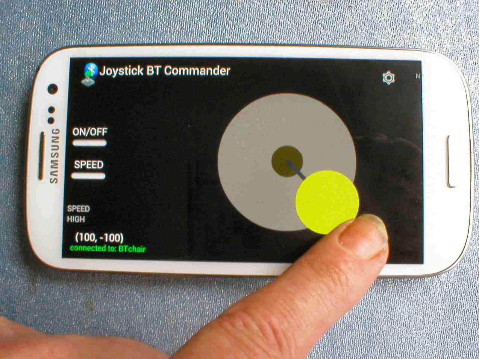

Postby woodygb » 01 Sep 2014, 12:45
Just a little more bench testing required before I can declare the Beta B.T. Interface ready .
Pic below of Android phone running Commander App.
Momentary ON/OFF & (High/Low) SPEED buttons with an indication of the selected speed , ( X,Y) stick position and connection status in the bottom left corner.
A Joystick option of square was selected ...round is also available.
Re: Plug & Play PGDT for Radio Control
Postby Burgerman » 01 Sep 2014, 20:33
Well it LOOKS like a joystick!
I doubt I could safely drive my chairs with it though. As It will feel a bit strange as you will be looking at the chair not the phone screen.
What sort of range do you get? Will it work to get a chair from the bed to the garage for eg? Bluetooth has everything from 5 feet to about 1000 metres range, depending on a bunch of factors.
If so an IP cam, will allow you to see where it is going, like my quadcopter style surveillance cam, tiny TX and goggles. Or laptop screen.

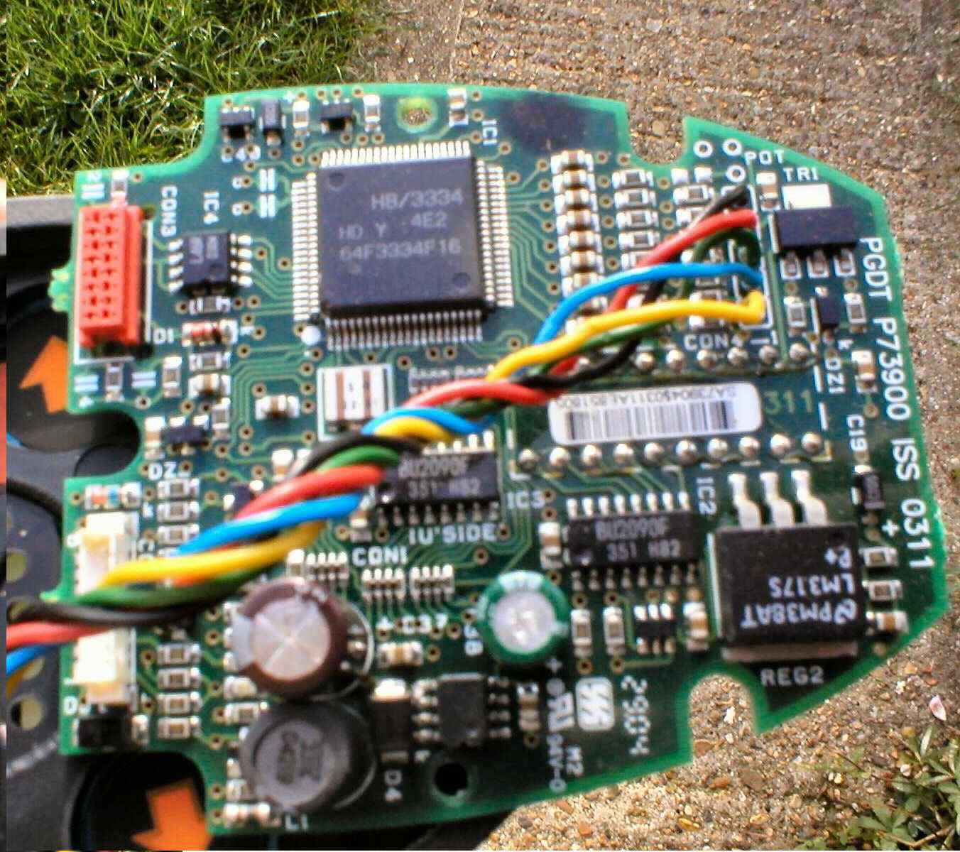

I sort of forgot ...it can be used with the Pilot+ stick ...IF.
The ease of interfacing depends on the pods age and the joystick that is inside it.... the early JC200 or the later JC2000 .
The later JC2000 ...not a problem... see pic.
The early JC200 has wiring coming from it in colours like below ....and is hard wired to the board.... so it's possible ...but the end user of my interface would need to interpose it themselves into the multi-coloured harness.
Postby woodygb » 02 Sep 2014, 09:05
EARLY Pilot+ board.
