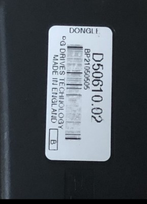

I am not convinced that a dealer dongle can actually read ALL of the OEM settings actually programmed into a PM until I see a file made with OEM dongle and dealer dongle side by side using OEM software (which changes to dealer mode whenever a dealer dongle is plugged in). Individual settings can be designated read, read/write, or write by the OEM.
So I've been trying to get an OEM programmer to test first hand.
Simpelmed in the Netherlands pulled a bait and switch sending an open box dealer programmer instead of the type B programmer listed non the invoice. Still unresolved.
BM said the power soccer shop was shipping overpriced but genuine OEM B programmers, so I ordered one. In the order comments I specifically asked for OEM type B. I was told it was out of stock and they didn't know when it would ship. It arrived today, nicely boxed, sealed. It has no markings anywhere on the box exterior saying OEM, or Dealer, or A or B. Invoice just says PC Programmer Part No. 5063. a label on interior box says D50612.26 and 230119265
Opened it to find another type A dealer dongle inside. I've spent over $1000 trying to get this thing BM says is so simple to get. I call bullshit.
Does anyone with a genuine type B want to trade for 2 type A?
Trust me it can. I have both. I checked many times. You send me a dealer file, and I can read and change every OEM level setting. And I can email it back to you and your dealer dongle will write that complete witth everything I changed to your chair. And no you wont see many of the changes. At least on any normal R-Net system. PM me and I will tell you how to do this with your dongle.
Not on a permobil however. With either dealer or oem dongle.
