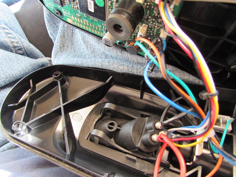

Postby Rye » 01 Jun 2017, 19:38
Has anyone connected the Woodygb RC interface to an Rnet joystick? I'm trying to locate the solder points on the circuit board. If you have any pictures I'd appreciate it. Thanks.

Postby woodygb » 01 Jun 2017, 19:55
I'd suggest that you use the connections on the back of the charge port for power .
