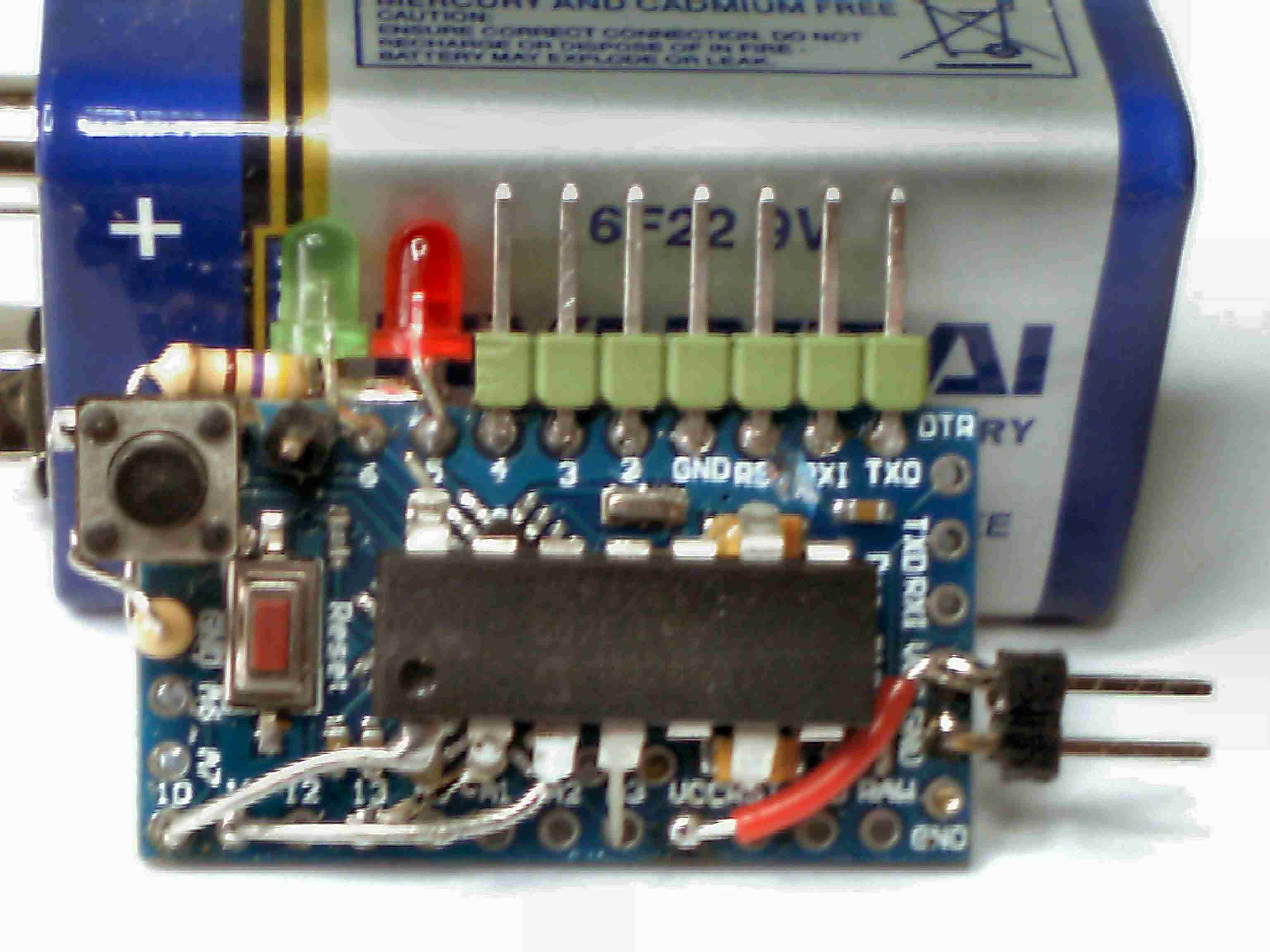

Postby woodygb » 21 Jun 2018, 10:09
You need to make an interface that sits between the joystick and the board.
I use and Arduino pro mini and a digipot.
