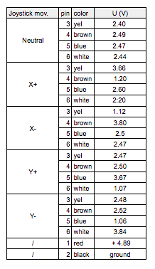

Re: PINNED - Plug & Play PGDT for Radio Control
Postby titanko » 24 Sep 2018, 08:42
Thanks Woody and others for quick respose ...
Here is more detailed info:
Wheelchair is Invacare Mistral3. I don' t know the real age, but batteries are from y2013. Controller is "all in one", unfortunately is the label to faded and I can not read the part no.
detailed measurment table:
I also disassemble the pot - it is inductive pot:
The "gear" change does not affect voltage measurements.
My opinion is to solve the joystick with Woody' s solution and gear change with 2 RC switches. Fortunately the push buttons on the controller are - 1 push - 1 move and not slide through all 5 selection.
Only problem is that I won' t know in which position the "gear" is at the moment. Maybe only with camera mounted :ugeek:
Thanks for your cooperation, Woody is it possible to program Arduino to the table voltages approx..? I know that final setup will be with trimming the RC transmitter.

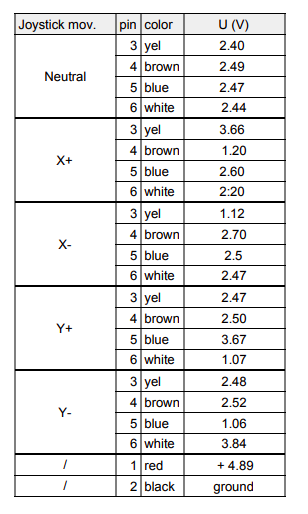

Postby titanko » 24 Sep 2018, 09:01
One mistake :oops: in the table is corrected X- value for 4(brown) wire:
joystick mov.png (35.17 KiB) Viewed 62980 times
titanko
Posts: 5
Joined: 23 Sep 2018, 06:18
Postby woodygb » 24 Sep 2018, 09:03
The voltage swings are opposing ...not really a big problem.... I use 2 digipots piggy backed on top of each other for this instead of one.
Your misconstruing the joystick voltage not changing with a gear shift.... How can it? ... interpreting the joysticks voltage reading and deciding what the controller outputs ..is done in the joysticks software.
Trust me ..Set the profile @ 100% and use the R/C Throttle channel to reduce the voltage swing OUT of the Arduino.
