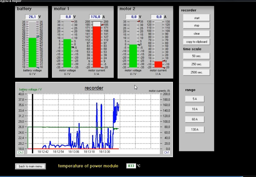

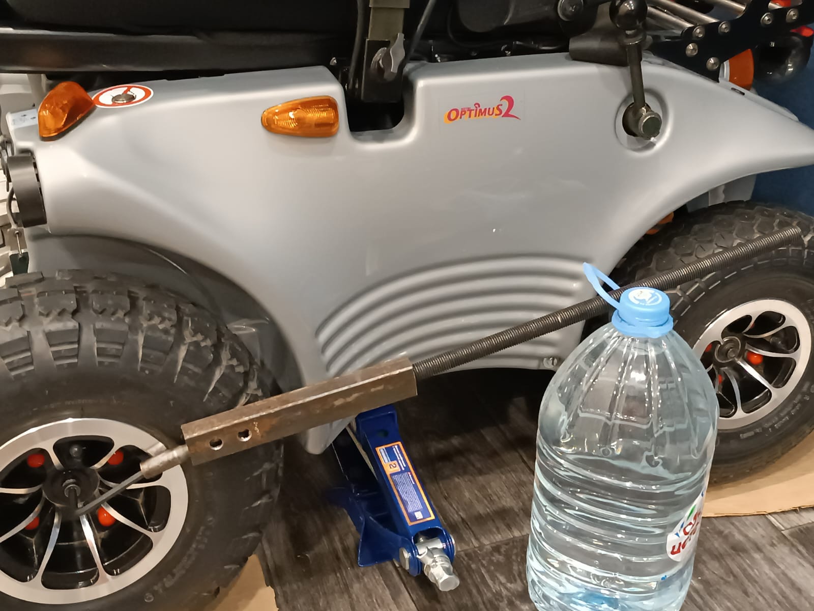

Here is a graph of when the wheel cannot rotate.(1)
2 graph - when rotating 5 kg through a lever with a length of 60 cm

Postby Burgerman » 28 Dec 2023, 14:41
8X 176 = 1408 Watts as the data shows.
That will increase to around 24x 176A or around 4224 Watts as the motor speeds up. Since it requires ever higher volts to still pull max amps.
And as I said, the gearbox and motor efficiencies varies dratically from 10 to 80% approx depending on load. So you cant calculate it.
Posts: 71089
Re: Configuring a new chair (essential!!!)
Postby Burgerman » 28 Dec 2023, 14:43
8V x 176A = 1408 Watts as the data shows.
That will increase to around 24V x 176A or around 4,224 Watts as the motor speeds up. Since it requires ever higher volts to still pull max amps. Forget your 700 watt figure!
And as I said, the gearbox and motor efficiencies varies dratically from 10% OR LESS AT STALL to 80% approx at light load depending on actual load. So you cant calculate it.
Posts: 71089
