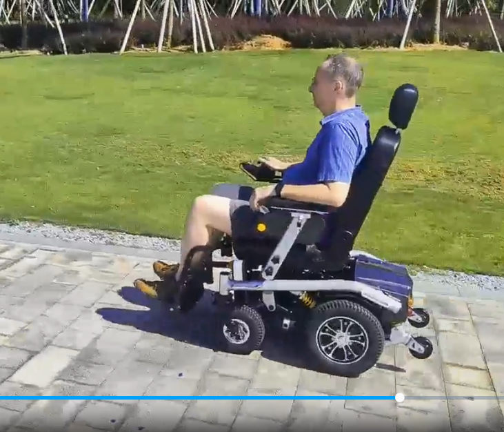

Driving with the seat raised is nice, nice feeling, very safe.
Tilt is nice too.
Seat lift is slow though, I have to get used to it.
Due to high seat position, it is not easy to get close to tables and the armrests and joystick touch the table too. I have the armrests in very low position, not very comfortable, but it is the only way to get close to my desk.[/quote]
Driving outside: quite fast and responsive chair, but I feel the suspension very hard, it is like there is no suspension, but I drive fast with small tires. I have to check if suspension can be adjusted. I think the shocks are coilover, so it should be adjustable. I’m not sure, I need to check them.
There didn't appear to be any real suspension I could see on the WCS demo Q300R, another reason for bigger wheels with the option to swap to pneumatic in future. I expect a hard bone shaking ride at 6mph over rough ground. I think I prefer MWD indoors I find mine very easy to manoeuvre. I want RWD for outside where MWD is hopeless
I wouldn't drive far with seat raised as most chairs wobble like a jelly, are you saying the Q300R is rigid when elevated?

“Driving with the seat raised is nice, nice feeling, very safe
I wouldn't drive far with seat raised as most chairs wobble like a jelly, are you saying the Q300R is rigid when elevated?“
I mean I can drive maximum at 4,5kph (function C-Me). It is for indoors but I feel it very safe.

“There didn't appear to be any real suspension I could see on the WCS demo Q300R, another reason for bigger wheels with the option to swap to pneumatic in future. I expect a hard bone shaking ride at 6mph over rough ground. I think I prefer MWD indoors I find mine very easy to manoeuvre. I want RWD for outside where MWD is hopeless”
Well, there are 2 shocks with springs and there are 2 hole positions for the shocks, I have to check if the second hole lets the chair to lower the seat height a little bit. And I also have to check if I can modify the spring tension to soften the suspension.

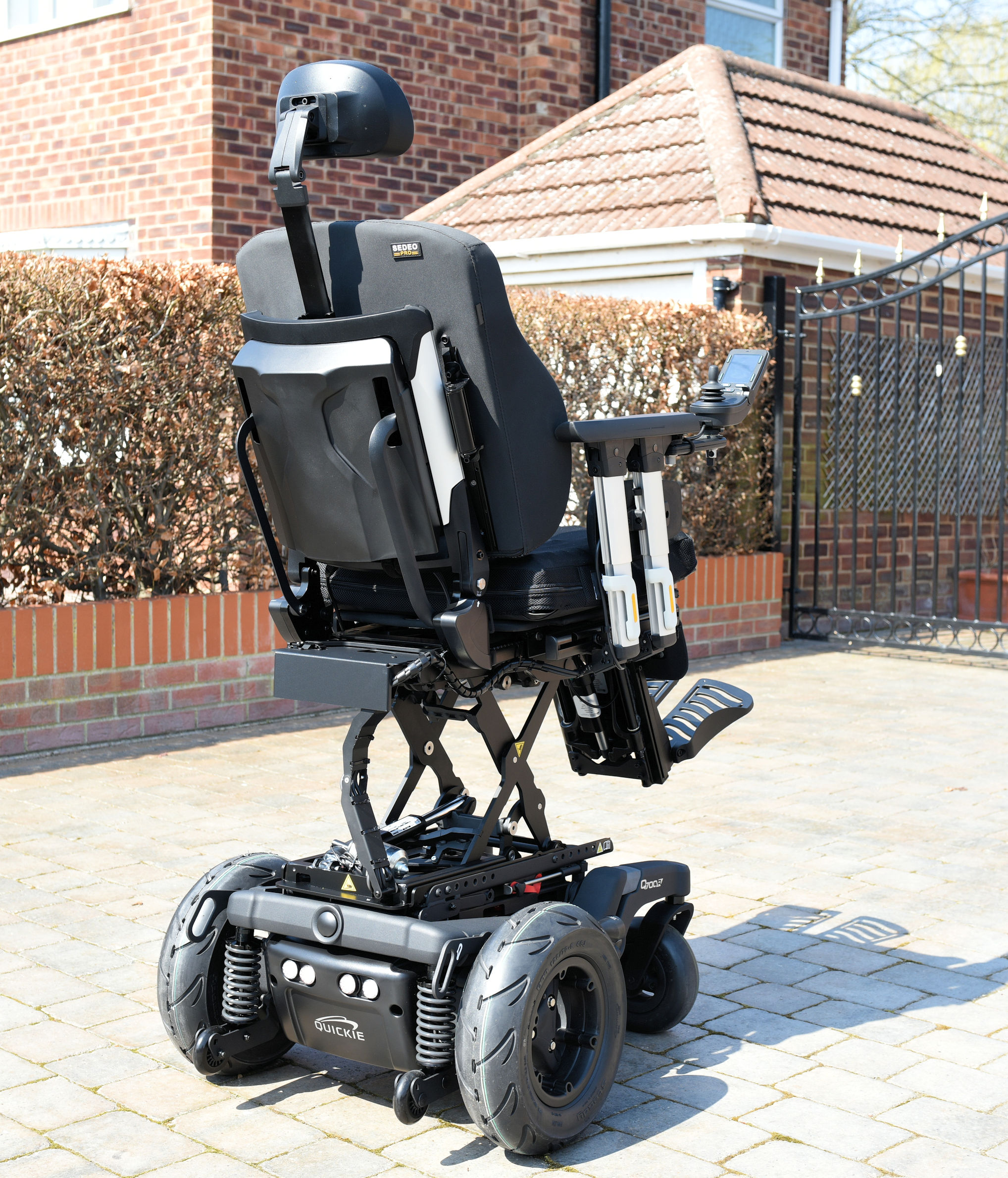

When the rear drive is configured properly, as in not as long as an oil tanker its actually better and shorter than mid drive indoors. Thats the problem. Stock chairs are all nose heavy, too long, etc. With drive wheels behind you swinging the front end around with you sat over it.
2 extremes to show the difference
STOCK chairs are like this:
Drive wheel has less than half the weight. Complete chair about 100 yards long.
Properly configired chais are like this:
Drive wheel has 75% of the mass. Complete chair 42 inches end to end. Inc footplate.
If I reverse to a wall my HEAD is the first thing to hit. I can easily turn into a doorway from a corridor. Steers lighly. No ass hanging around to reverse into stuff in confined spaces. The complete chairs length is 6 inches LESS than my own seated shape seen from the side. Thats better than any mid drive.

Burgerman wrote:When the rear drive is configured properly, as in not as long as an oil tanker its actually better and shorter than mid drive indoors. Thats the problem. Stock chairs are all nose heavy, too long, etc. With drive wheels behind you swinging the front end around with you sat over it.
Yes, your chair is really well designed and built. One of the things I didn’t like about the Invacare Aviva (European version) is the CG so forward even if it can be slightly adjusted. The Q300R allows to move the whole seat quite back. And moreover I can adjust the length of the seat so I can be seated even more back.

Postby Burgerman » 01 Apr 2025, 03:40
Yes I had to do this with every one of my invcare, salsaR, q700R, BM1 and 2 and 3 and the Dietz chair. All my chairs are this way, non were usable as stock.
