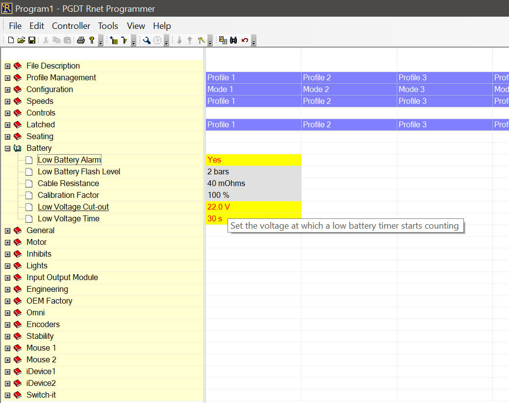

With R-Net, its possible in programming to set the lowest voltage before the chair stops rolling under load in use.
If you set this to 22V its max setting then it will stop at 2.75V per cell averaged across all 8 cells. At this voltage on a decent quality balanced pack the lowest cell should be well above the dangerous level. So this will effectively prevent you over discharging the pack and causing damage. It will also prevent you using the last few 5Ah? approx. But ask yourself, is that really an issue with a 244Ah (measured) capacity?
I wont be setting that as I may one day prefer to kill the pack in order to reach home. But thats me.

Burgerman wrote:With R-Net, its possible in programming to set the lowest voltage before the chair stops rolling under load in use.
WHAT! Thats an undervolt cutout! I'm not going to rib you too hard for suggesting it because we know your position on those and it does make complete sense if the operator cannot leave a dead chair. But since you suggest it as an option for others, for someone able to get out of the chair in an emergency, would you approve of a BMS that could send alerts before reaching the cutout? In case they happen to be nearing cutout but haven't been monitoring battery level.
Any shift on the "no BMS ever" position? Or maybe you can recommend one of those cheap battery monitors that give an audible warning at a configurable SOC.
What does the calibration factor in the Rnet screen do?

Postby Burgerman » 19 Jan 2025, 18:21
It messes with its complex peukert, voltage drop, lead battery guesswork calculations to display some nonsense on the screen...
Exactly what we cant know.
As for battery low voltage cut off that is all completely irrelivant! The whole point in fitting a battery that is huge means that theres no way on earth I can run it down to a dangerous point for the cells in a day. Probably several days. There isnt enough hours in a day, and I would end up with a pressure sore if I tried to do it on purpose...

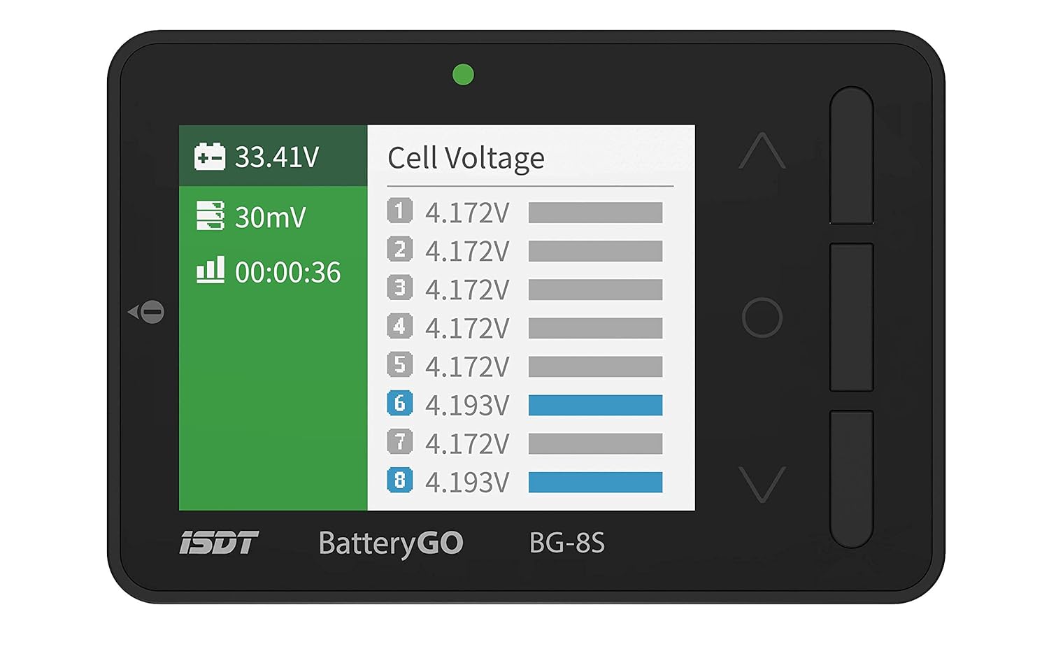

IF you worry about this (and after a few months of use you wont) use a cell log like this, check it every 5 miles or so after you lose a couple of lights:
I used to, and still will keep in my wallet (its small) on a new pack that I a testing or if I am going a long way after a few days not charged. I no longer bother as I can corrolate the distance/battery lights on my chairs joystick, with state of charge as long as its in the top 2/3rds. You just get used to endless rolling!
Mines a bit scratched up and dull... From being carried in my wallet. Still works fine. Amazon cheap.

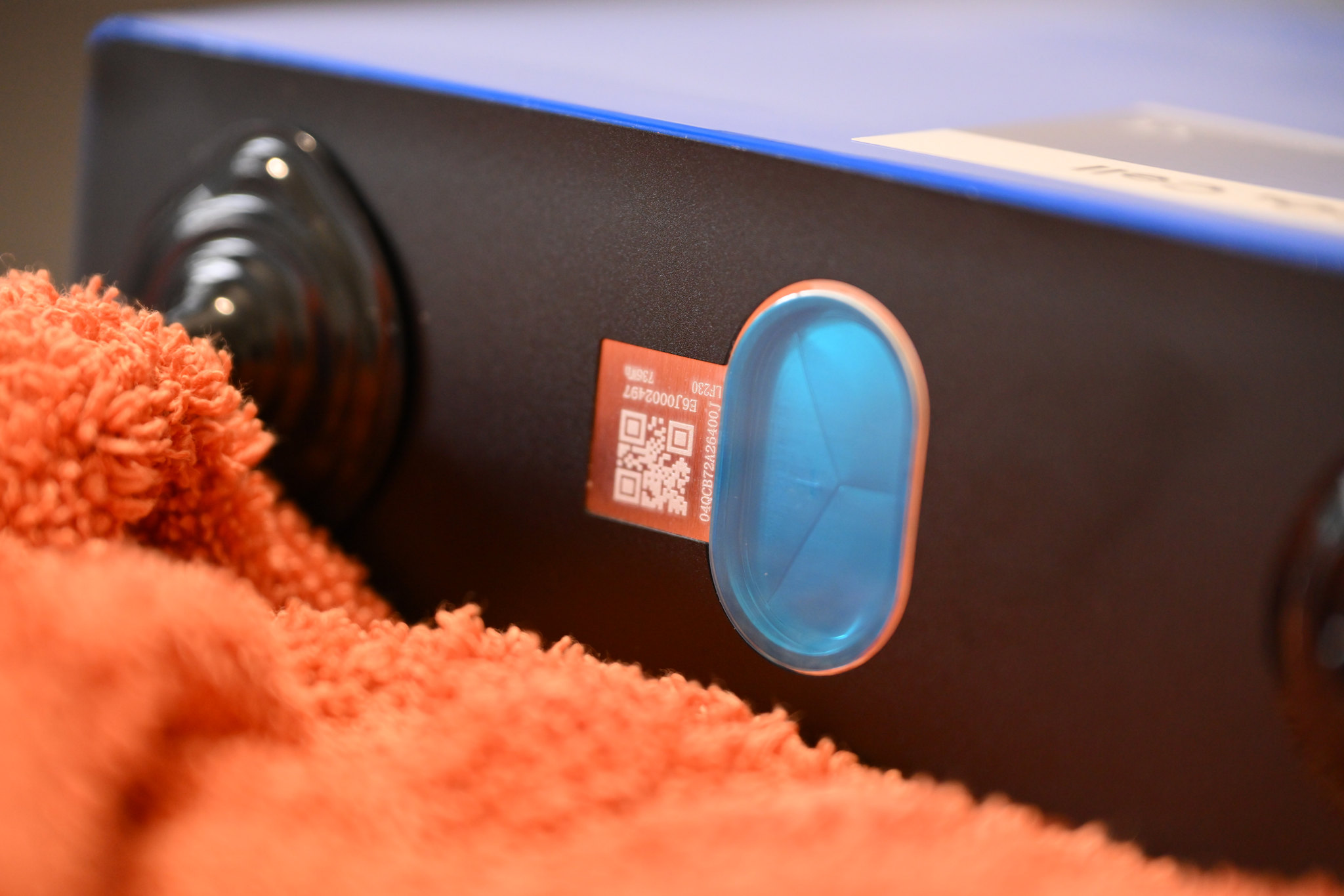

I received my cells from Ezeal in Houston. They are a bit wavy on the sides, but not but bumpy. Are they ok to keep? Also when I ordered my multimeter I didn't know I needed to put the batteries under load and put an an AC current through them in order to test impedance. Can anyone tell me what values I need to use in order not to destroy the batteries and what I can use to provide the needed values. I'm still married after what I've spent so far, I hate to push things further by buying an impedance meter. What brand impedance meter is best?

How do I get the date codes from the batteries? My phone doesn't recognize the UID code on the batteries.

Postby Burgerman » 26 Jan 2025, 21:30
Date codes, actual factory production specs, complete with impedance capacity etc were supplied by amy/docan via email. I just gave her the 8 cells codes (the letters/numbers) etched around the bar codes. You need good eyes.
To measure impedance you need an impedance meter about £24 on aliexpless see previous pages on this thread.
As long as zero bulges, and all lookin pristine and brand new they will be good.
You dont need a imedance meter to do 1 pack. Just get the spec sheets for your individual numbered cells. As I did.
THESE numbers! https://www.wheelchairdriver.com/board/ ... &mode=view
Everything I measured, capacity, impedance, just matched the manufacturers test data within 1 percent. 244Ah, as per spec sheet. Same impedance as shown. Flickered between 21 and 0.22mO every cell. Super low!
Save your money and keep your wife! As long as they look NEW.
