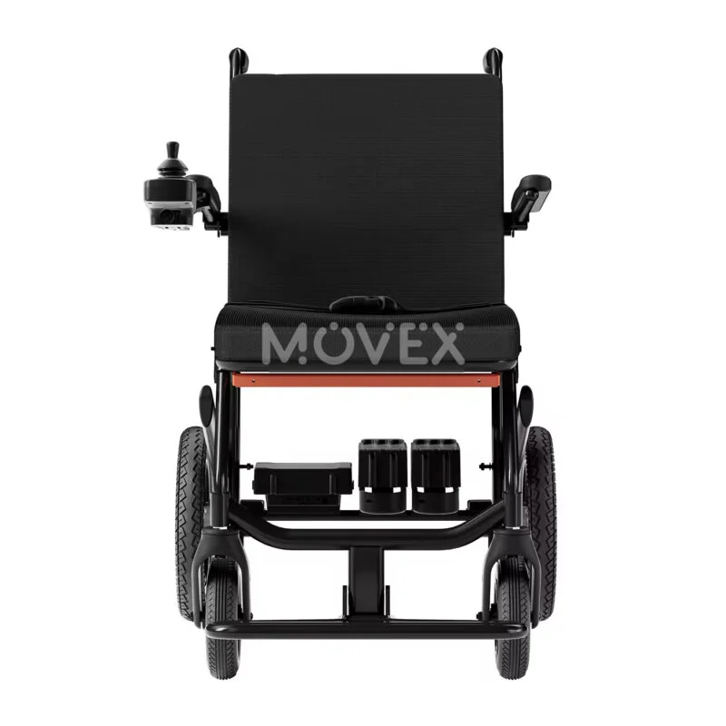

Postby emilevirus » 07 Feb 2025, 23:35
Yeah, sucks. They could have used newer 3500mah cells. I wonder if I can get my hands on the shell. I could make my own pack with Samsung cells.
https://movexmobility.com/product/batte ... ir-5-2-ah/
emilevirus
Posts: 562
Joined: 12 Aug 2020, 22:02
Re: Controllers for lightweight chairs
Postby Burgerman » 07 Feb 2025, 23:48
25.4V CHARGE? Means its 7S. And two strings in parallel. So 14 cells. And that powers the chair? There are bigger packs in my model helis!
Its only 5Ah. Why not 8 cells of lithium ion phosphate maybe 20Ah.
Postby emilevirus » 08 Feb 2025, 00:56
There are 2 packs in parallel so 10ah
emilevirus
Posts: 562
Postby Burgerman » 08 Feb 2025, 01:15
Words are not as good as pictures. How many in parallel in total?
Postby emilevirus » 08 Feb 2025, 02:18
I mean there are 2x 5.2ah in parallel. They did it like that because airplanes. Batteries must be less than 200wh but 2 separated batteries is fine.
So basically one pack is 7s2p and I have two packs so it's 7s4p.
emilevirus
Posts: 562
Postby Burgerman » 08 Feb 2025, 07:20
I see.
