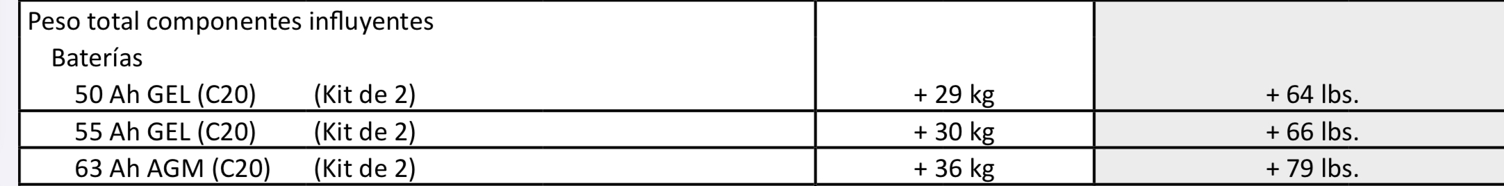

Postby Burgerman » 17 Mar 2025, 22:08
Batteries Q300R
QML160016 Battery, 50 Ah, Gel, Maintenance-Free 0
QML160013 Battery, 56 Ah, Gel, Maintenance-Free £130
QML160030 Battery, 64 Ah, Gel, Maintenance-Free (3) £130
(3) not available with ISM6-L
So you cant have the bigger battery if you have more than one powered option, (the R-Net 90 POWER MODULE can do 1 seating channel without a seating module added) and more needs a ISM6-L
But it says they are all gel?
https://www.sunrisedice.com/asset-bank/ ... /78875.pdf
For what its worth, a 64Ah battery in that GRP22 size will mean very high impedance. OR/ AND less cycle life. So the smaller Ah battery is a better bet.
Posts: 71119

On the order form there is only 1 option which just says 64ah, nothing about gel or AGM. But in the instructions manual says that 64ah is AGM.

Postby Burgerman » 18 Mar 2025, 12:58
I see contradiction is their paperwork. Almost like they dont know what they are doing. That couldnt possibly be right though. :clap
So its a lottery!
