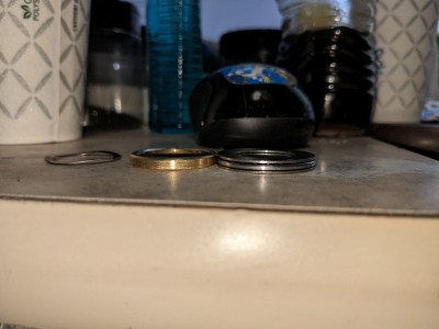

The $2 Aviva's casters fix
I am happy to report that I have fixed all my Aviva's casters issues. Now the casters swivel easily, smoothly and silently. The nose heavy feeling is gone. The Aviva feels like a new chair. I am ecstatic. :dance
I purchased the: Thrust Needle Roller Bearings 0.75 Inch Bore 1.25 Inch OD.
https://www.amazon.com/dp/B09CG2TFJM
They fit the forks shaft perfectly. The bearings are 4mm thick so you can't over tighten the nyloc nut. Perhaps grinding the bevel used for the bronze spacer will allow the thrust bearing to sit flush on the fork is an option. But I kept the bronze spacer in place without adverse affects.
Hope this cheap and easy fix will work for other Aviva owners.
Big thanks to BM and all who offered input. cheers
I added some Mystik JT-6 Hi-Temp Grease.

Postby Burgerman » 19 Feb 2025, 01:05
Take out the brass/bronze washer it no longer does anything and is not letting the caster fit up high enough.
Also, just like the one in the video on the pride chair it will corrode to death. Replace with a stainless steel one?
Posts: 71117
Re: Invacare Aviva Storm RX20
Postby Flagmax » 19 Feb 2025, 01:25
Burgerman wrote:Take out the brass/bronze washer it no longer does anything and is not letting the caster fit up high enough.
Can't do that unless the bevel is removed from the shaft or perhaps need get larger bearings otherwise there is about 3mm gap with these.
I was not sure this fix was going to work so got the cheapest bearing to size. I packed them good with grease. But yah 19mm or 20mm stainless would be nice.

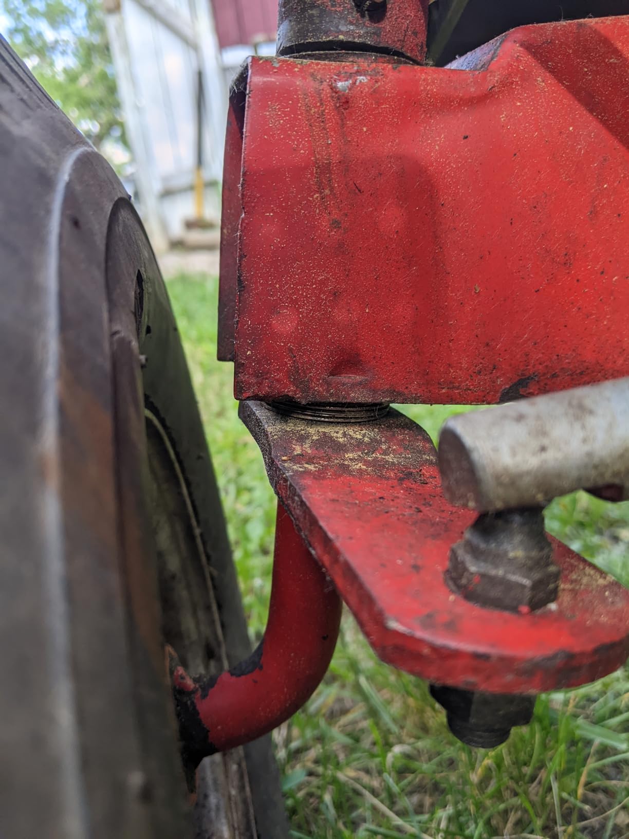

One fella wrote,
Replaced the washers on my lawn tractor front spindles with these, and the ease of turning was amazing.
This is a must have upgrade for your lawnmower.
If its good for a tractor its good for a wheelchair.

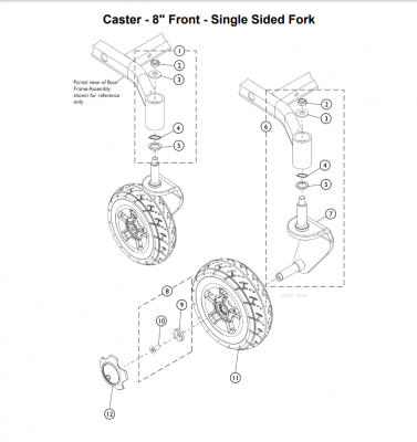

Two designs,
Aviva RX20 North America
Aviva RX20 Europe
I do want to say that the Aviva RX20 North America elastomer bushings used in casters headtubes do add some ride comfort. There is less vibration transfer to user compared to ball bearings design. So I think adding the thrust bearing is a good option to go with. Its cheap and easy route to go.

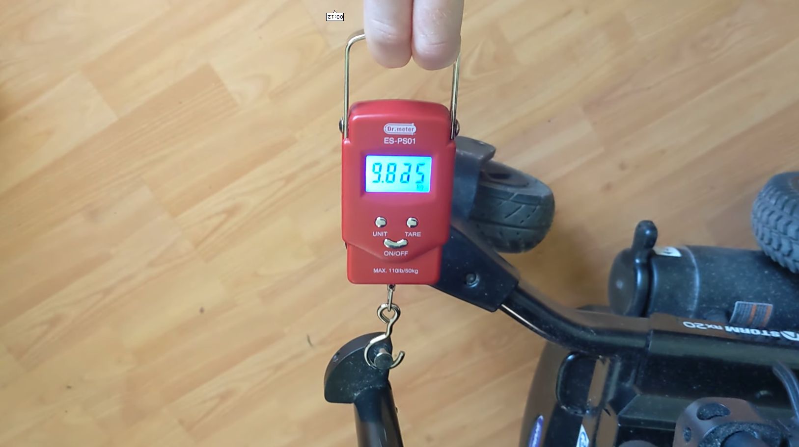

I have done the fix to another Aviva RX20 with the same positive result. Adding thrust needle roller bearings gives 300% improvement.
I did a crewed test with a fish scale, pulling on the legrest receiver, I measure how many kg's it took to get the casters to swivel.
Test was done without the user in the chair and the brakes disengaged on smooth floor.
The original "plain bearing" bronze spacer design took 9.8kg to swivel. The casters were "serviced" by a DME tech a week ago (cleaned, lubed).
The addition of the "thrust needle roller bearings" took only 2.4kg to swivel.
How it looks after adding thrust bearing.
