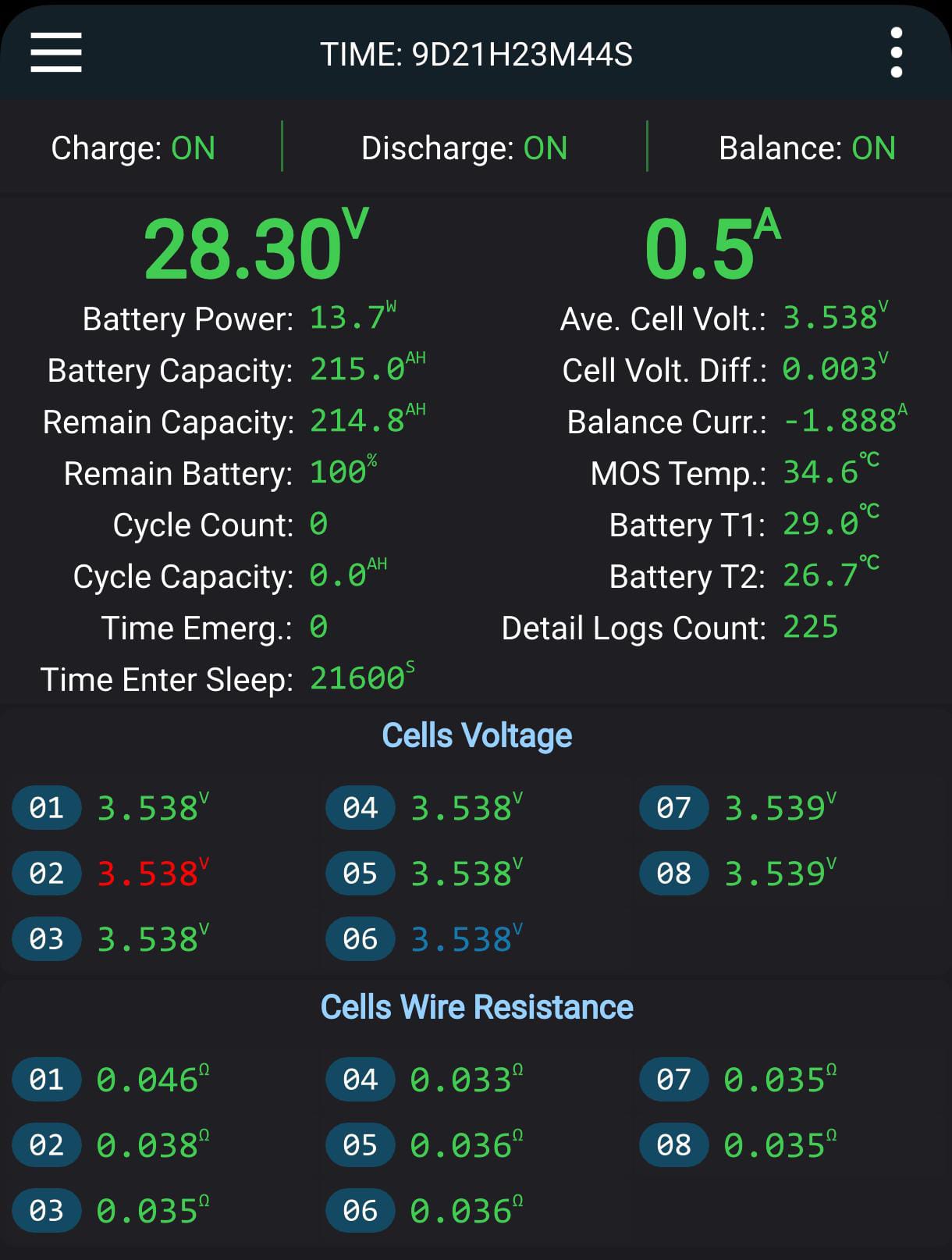

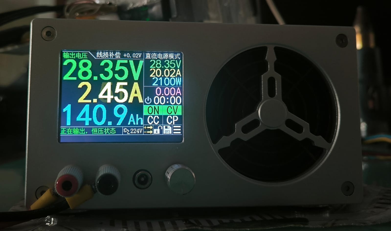

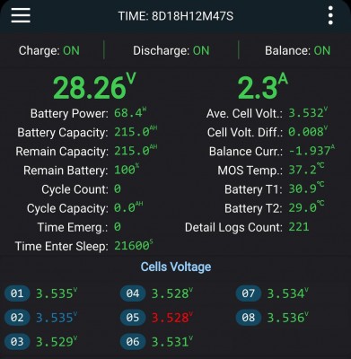

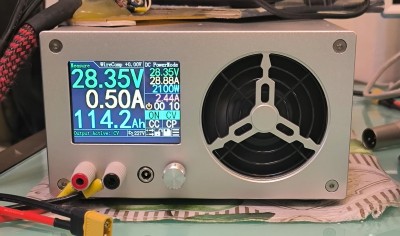

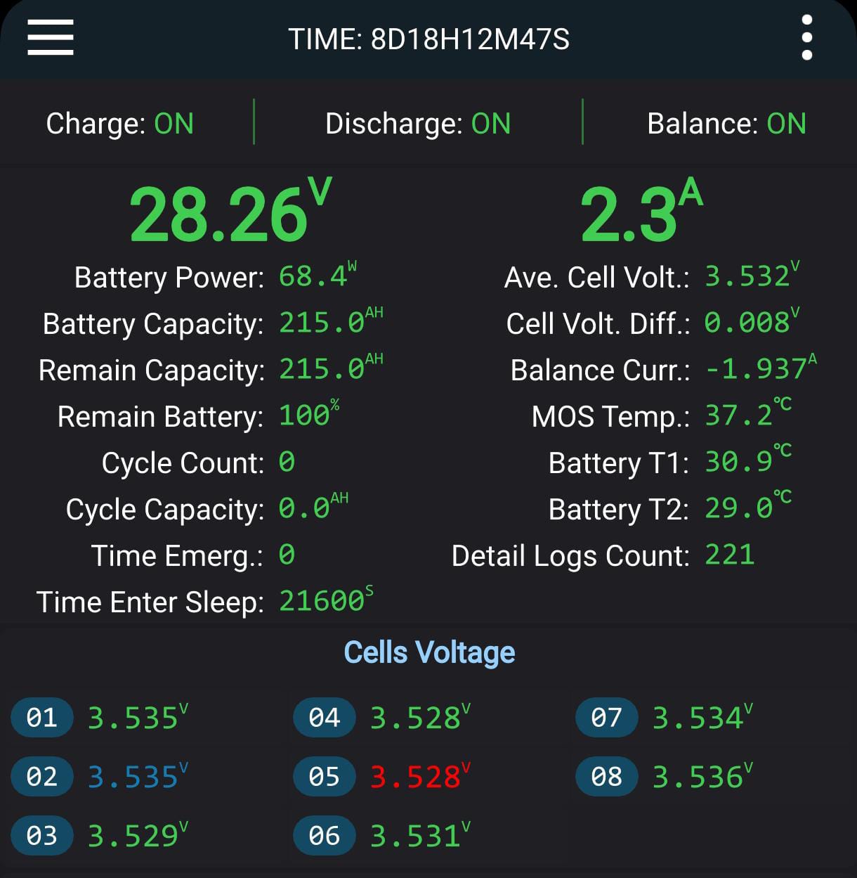

JK-BMS + ZXD psu. Current will drop as battery voltage approaches CV.
Together with the shutdown timer and residual current, we could set termination current (to some extent) as a good balance charger.

When cells are not balanced, pack voltage will still be a bit away from CV. Charge current will be big. BMS will just chop it off. However, it will restart in a minute or 2, as the highest cell will be discharged.
Repeatedly, current will subside as cells are close to balance.

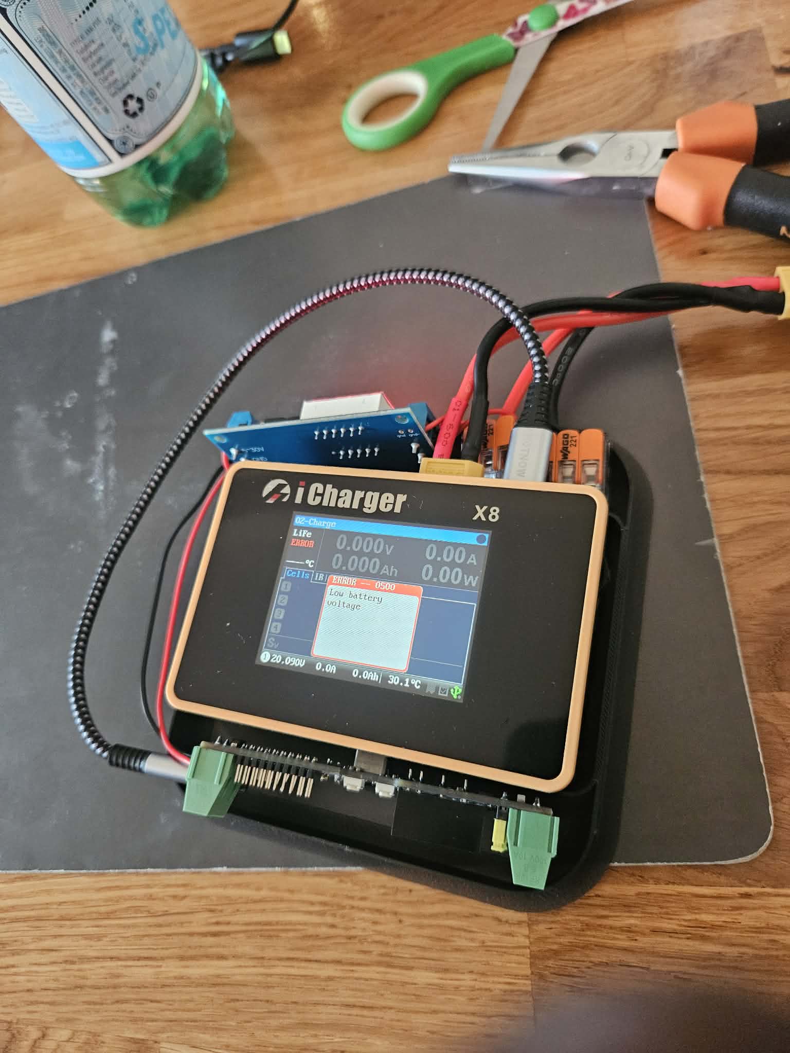

I ended up making this little contraption for 48v@5a usb c charging, (excuse the mess this was the initial prototype lol)
Essentially it is:
1x icharger x8
1x custom esp32s3 board with 70v voltage regulator for MODBUS HID control
1x delay relay board
1x 12 AWG xt60 splitter to power both icharger+esp32s3
1x usb pd3.1 48v trigger board with xt60 + usbc female cable
1x 240w usb charger (external)
3d printed a box for all the stuff (you can see its base in the image) and mounted on the chair, icharger always wired in to the battery, routed usb cable/port to joystick, under the xlr port. Just plug any 100w-240w usb charger to charge, esp32 auto starts icharger program and can monitor it/stop it via wifi.
Feel free to roast this abomination and tell me what's wrong with it.

Is there any point when the chargers output is linked to the battery and the charger isnt powered?
Because most hobby chargers have a warning inc iCharger to always connect the input power before the battery to the output. Or (looking for pic of a mushroom cloud icon)...
Posts: 71089
Re: "Simple" solution for Lithium charging

Postby Burgerman » 21 Mar 2026, 13:54
Because on odd occasions the mosfets will go bang.
Theres no control on them until the charger is powered up. They can switch at random and boom. You will be OK 99% of the time. Then when you least expect it... It just happens out of the blue.
The order that you connect or disconnect matters. The idea is that you never have a battery connected without a ready to go powered up charger.
Heres an example in a random iChargers chinglish manual...
Connecting method:
1. Connect iCharger's input power supply, and turn on it.
2. Connect Li batteries' balance port
3. Connect the main charging port's positive pole to cells' positive pole, and then connect negative pole to
cells' negative pole (this will avoid striking fire while connecting Li cells).
4. Start charging and discharging...
5. After finishing charging and discharging, pls disconnect the cell and charger, and then turn off the charger's
power supply.
https://www.icharger.pl/manuals/106B_en.pdf
Plenty of info about this on hobby forums.
I blew up 2 different hobby chargers in a very exiting way by ignoring this over the years. They suddenly go short circuit and have about 1000 batt amps go through them! Loud. Seen it happen many times at my local flying site. Along with very puzzled looks. Some were iChargers.
The PL8 is uniquely protected against this to a degree according to its designer. But again dont count on it. Even with that one its best to stick to good practices.
Posts: 71089
