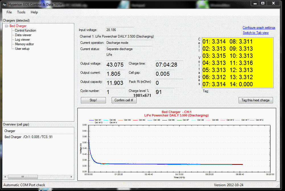

Postby Burgerman » 05 May 2013, 17:42
THIS is what you will see if you DISCHARGE a fully charged balanced healthy battery. Here I am discharging my BM3 battery, and almost 12Ah removed so far.
Graph shows initial voltage drop, then all cells (13 displayed) are within 5000ths of a volt... See yellow square, graph, and other data.
Eventually this graph will suddenly drop at the end. But the software is limited to 65Ah, although charger/discharger will keep going for about 18 hours. Known Programming bug. This wont affect you.
This way you can see if any cells drop off early, and measure actual capacity as you discharge or charge it. Manually STOP it when it ends. Or it will start to balance cells automatically. You do not want it to do this.
