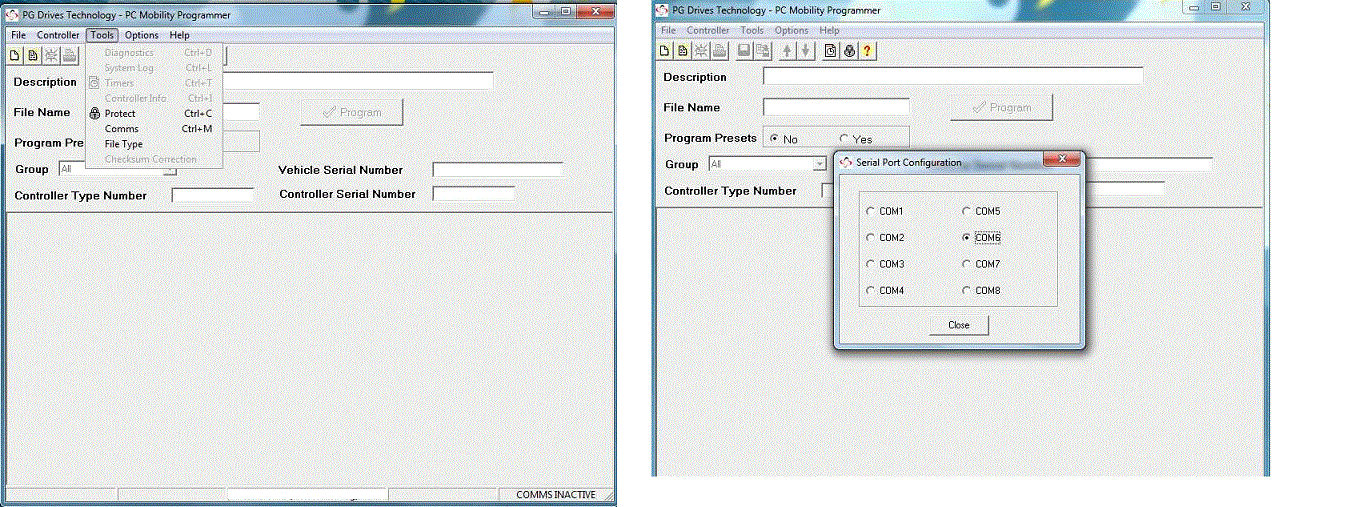

Open the PGDT Programmer..IGNORE ..the cannot open serial port message.
Click on Tools ..then Comms.
Then pick the COMS number.

Postby malamar » 19 Sep 2012, 19:38
now com 3 ticked

Postby woodygb » 19 Sep 2012, 19:42
Tick the correct COMS number...the one you saw in Device and Printers.
Close the programmer software and restart ..there shouldn't be any warnings . ..you're now ready to plug into your joystick pod... COMS ACTIVE should appear if your chair is turned ON.
