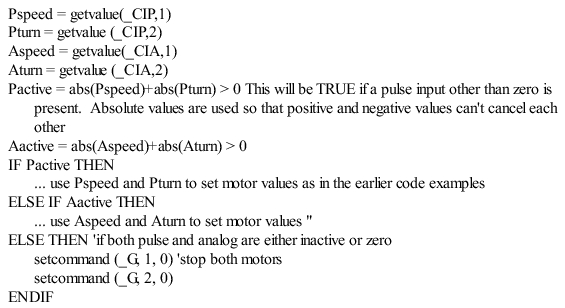

(4) I think that some of this has already been covered in preceding posts. Pulse and serial inputs are scaled exactly the same way as analog, you just have to call _CIP or _CIS instead of _CIA. In a fancier version of the script, because the Roboteq can auto-switch from one to the other, you would want to first test for which mode is active and chose the _CIx according to which mode is being used. I don't see a anything in the command list that finds out which mode is active (have I just missed that?), so one might have to test with something like the following:
clip 1.jpg (65.23 KiB) Viewed 24517 times
(This stuff gets real hard to read without indenting. I'm therefore posting code as jpg images with a little formatting.)

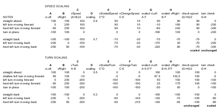

For scaling speed, we have to find out (using both CIx values) whether we are going forwards or backwards (because we may want to apply different scaling for the two), and how fast we're going, and then scale that and apply the change equally to both motors. For turning, we have to apply half the scaling correction in one sense for one motor, and half in the other sense for the other motor. I wasn't too sure that I was thinking about this right, so I ran some examples in a spreadsheet before starting to convert it to MicroBasic.
Roboteq scaling.jpg (80.14 KiB) Viewed 24511 times
(6) Lecture resumes.
We now have an idea of what we want our program to do, so it's time to start writing it. While we're at it, however, let's try to structure the program a bit because we're probably going to want to add things and change things as time goes on.
I've put comments between {} braces, but that's not the way MicroBasic does comments - it uses a single quote mark to begin a comment, so don't just go copying stuff from here into a script. Creating a working script isn't my intent in any case; I'm just trying to share some ideas about things that might help write a good script. I don't have a Roboteq controller so I can't test a working script anyway, and I don't want to give you a runable, but untested, script.
First off, I wouldn't actually use the numbers 70 (speed scaling in reverse), 90 (speed scaling going forward) and 35 (turn scaling) where the calculations get done, but would specify some variables at the top of the script so that it would be easy to change them if they turn out not to be optimum.

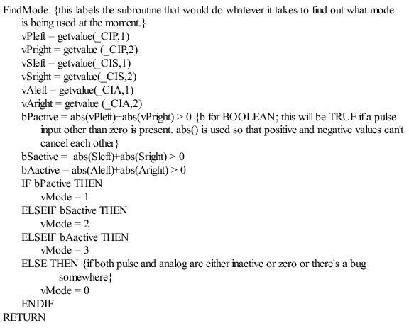

This loop will keep going as long as the Roboteq is running and will keep telling the computer to do all those things. We might want to do other things as well. For example, for a front wheel drive chair, we might want turn rate to be scaled back or be limited as speed increases, and we could add a subroutine to do that. What actually has to get done is not, however, defined in this main loop, but in the subroutines. You could put all the guts in the main loop, but it would make the program hard to read and a "modular" organization makes it much easier to change or fix or add to later on. So now, let's see the subroutines (or at least a sketch of what they'd be like).
clip 5.jpg (85.95 KiB) Viewed 24502 times

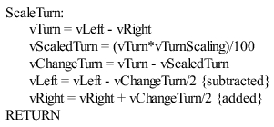

Now we have to scale turn. Here I assume that we're going to scale turn to the same percentage whether going forward or backward, so there's no need for any IF. If we wanted different scaling for forward and reverse, this would be structured as in the ScaleSpeed subroutine and we'd need two scaling variables: e.g. vTurnScalingForward and vTurnScalingReverse. There is one critical difference in the calculations for turn scaling: we have to apply half of the turn correction in one direction on the left motor and in the opposite direction on the right.

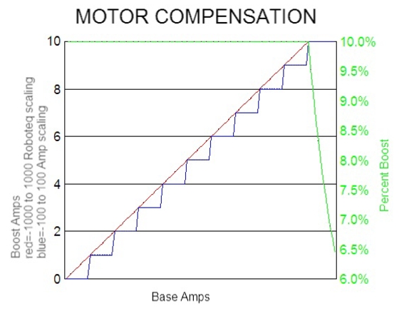

Now lets do IR motor compensation using some sensors attached to analog input 3 for the left motor and 4 for the right motor. Motor compensation is most useful at low torque, which is where the internal current estimate is least accurate. We've used the GUI program to configure these analog inputs to scale the -100 to 100 Amp sensors to the Roboteq's usual -1000 to 1000 range. I'd use sensors with a range a bit less than the maximum current our motors might use. Motor compensation is not really much use there, and by truncating we reduce the "twitchiness" that high compensation might cause when the chair is under extreme load.
We'll do all the calculations with everything in -1000 to 1000 Roboteq units. If you converted them back to -100 to 100 amps, the truncation of integer arithmetic would give gross steps in the amount of compensation. You'd have to convert back to the -1000 to 1000 range anyway to send the commands to the motor.
Here's a graph to illustrate what I've just said.
Motor Compensation.JPG (78.83 KiB) Viewed 24491 times
Compensation tapers off after 100 Amps and making the mistake of calculating it using Amps instead of Roboteq units gives a stair-step curve.
As I was doing this, I realized that there's absolutely no need for PID complexities for motor compensation. This is an open loop servo. - until the sensor is off scale, we're always compensating by the same percentage (the P in PID) and there's no time variation as we "approach" the right compensation (the I and D in PID). Thanks Woody for your old posts that pointed me in the right direction!

FindMode:
vPleft = getvalue(_CIP,1)
vPright = getvalue (_CIP,2)
vSleft = getvalue(_CIS,1)
vSright = getvalue(_CIS,2)
vAleft = getvalue(_CIA,1)
vAright = getvalue (_CIA,2)
bPactive = TOBOOL (abs(vPleft)+abs(vPright) > 0)
bSactive = TOBOOL (abs(Sleft)+abs(Sright) > 0)
bAactive = TOBOOL (abs(Aleft)+abs(Aright) > 0)
IF bPactive THEN
vMode = 1
ELSEIF bSactive THEN
vMode = 2
ELSEIF bAactive THEN
vMode = 3
ELSE
vMode = 0
END IF
PRINT ("\n","Mode = ", vMode, "\n \n")
RETURN

ScaleTurn:
vTurn = vLeft - vRight
vScaledTurn = (vTurn*vTurnScaling)/100
vChangeTurn = vTurn - vScaledTurn
vLeft = vLeft - vChangeTurn/2 'subtracted
vRight = vRight + vChangeTurn/2 'added
PRINT ("vL turn scaled = " , vLeft , " vR turn scaled = " , vRight, "\n \n")
RETURN
