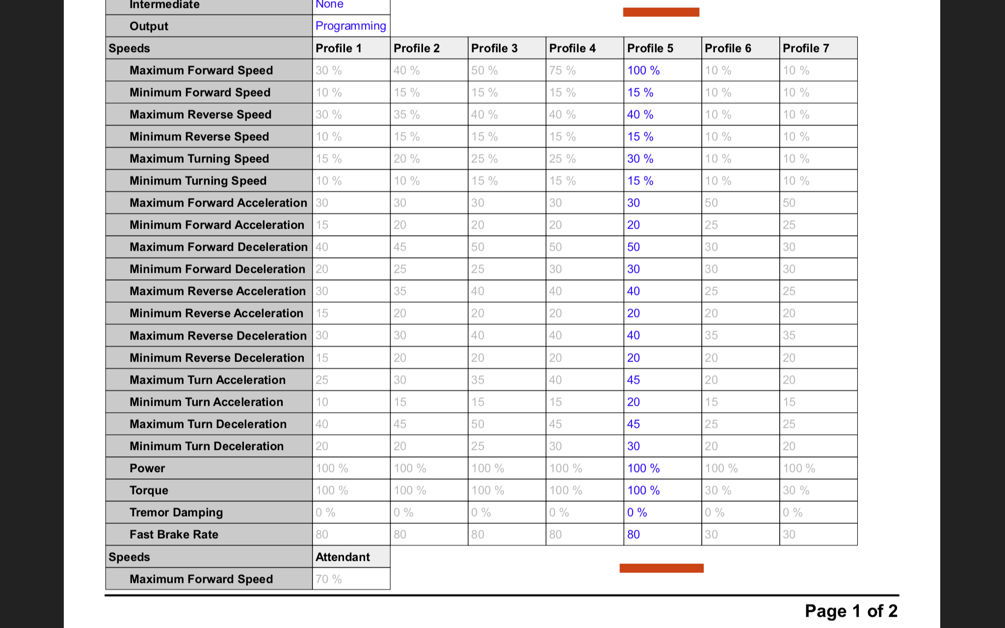

I'm in the process of copying BM's recommended R-Net settings... This is the first time I've attempted R-Net programming
The OEM factory settings were easy to match to BM's settings. I've done that but have not attached a screenshot as it's pretty straightforward.
I've still got the speed settings to adjust but likewise that seems pretty straightforward.
But being used to an S-Drive with no profile options, I was a bit unnerved seeing lots of different profiles.
There were several profiles enabled in "Profile Management" so I disabled them all but one: Profile No.5
TWO QUESTIONS:
1) Should I leave the profile settings as they are in the screenshot?
2) I don't understand what the "Configuration Modes" are. Should I leave as is?
My chair is Salsa R2 and has lights and indicators but no actuators. But for weight saving reasons I unbolted and removed the lift/tilt & powered backrest recline.

I've just read right through the whole thread again and tried to follow your guidelines.
1) The joystick is positioned the same as your's and mounted rock solid on a rigid armrest.
2) I've removed the Nazi Walls from the OEM Factory and matched yours.
3) I've still got to do the speed settings, acceleration, turn, etc, but that is easy enough.
But the thing that puzzles me is:
4) Do I copy your "profile management" settings, you've not highlighted them in yellow?
5) Also what about the "configuration settings"? Do I leave as is?
From Post No 2

THE REASON I WANTED TO REPROGRAM THE CHAIR IS TO MAKE IT STEER MORE RESPONSIVELY. The OEM setting is a bit woolly.
Am I correct in thinking to achieve more responsive steering the FOUR values that matter most are the:
Max turn acc
Min turn acc
Max turn dec
Min turn dec
I shall try setting all four to 100% and test driving it

Set forward deceleration low like 25? Most are way too high.
And yes those 4 above to max. Then reduce max and min turn speeds if its too touchy for you. Also the TORQUE setting if set too high makes the initial movement too jumpy. It add motor power at very small stick movements...
In all cases MIN refers to tiny stick movements or low speed setting. MAX refers to full stick or maximum speed setting.

I'm a bit more confident now. The basic speed settings are very similar to the S-Drive speed settings. The difference is the turn settings, modes, and profiles. But I think I understand now. I shall report back later how I get on.

Yes the chair is quite jumpy. I didn't quite understand what the torque setting is for. Would you say 50% is a good starting point and increase/decrease if necessary?
I hoping to get it to be a responsive chair but not a jumpy jerky chair. Jerky movements wobble my legs about and upset my knees :ambulance
Postby Scooterman » 14 Nov 2018, 15:42
PS: In all the time I've had the chair I've never pulled back on the joystick. I thought it might break something? The fast brake is set to 80% so maybe it's just as well I haven't pulled back on it.
Postby Burgerman » 14 Nov 2018, 16:51
Why? Watch my fingers.
That torque setting increases speed of response by adding power at very low speeds. Like as you start to move or as you start to turn in place. It makes it jump on the first bit of stick movement. There IS no starting point. Other than off. 0. It does this I think by increasing Motor Load Compensation, at tiny stick movements or low speeds only.
Add more if you want to make it start a turn in place more reliably, or set off more sharply. Add less if its too jumpy.
If its STILL too jumpy at 0% reduce motor load compensation as well by say 5mOhms. And test.

Postby Scooterman » 15 Nov 2018, 10:49
hank wrote:Done about 6 miles in chair today with forward acc 100 And min forward acc 100 :thumbup: Rnet 120amp
Much more lively now and responds well.

Postby Burgerman » 15 Nov 2018, 10:55
You set them how you need them. But once you can drive the thing, those are actually not insane. They are just not the pudding stirrer settings you are used to.
Reduce forward acceleration to a level YOU are comfortable with.
Reduce turn speeds and minimum turn speeds to turn at a speed YOU are comfortable with.
Leave turn acceleration, turn deceleration, and the min turn acc and min turn decel alone. Lower motor compensation a touch if its too sharp or jumpy for you. Adjust each setting SEPARATELY and test its effect.
Postby Scooterman » 15 Nov 2018, 11:07
I'm getting there.
So far I've got
max turn acc 90%
max turn dec 90%
max fwd acc 50%
torque 50%
But I've got the:
min turn acc & min turn dec set much slower.
I've learnt the max turn acc/dec stops the chair slowing too much when corning at full speed outside. When it was set slower the chair used to really slow down when corning flat out, it was frustrating.
But with min turn acc/dec I've set it low to stop the chair whipping round at 1 bar led. Fast turns when slow/stationary upset my knees because my legs wobble about (no muscles).
But I've got the dongle for a few more days so will fine tune and perhaps change a few more values. I've also activated OBP in case I get an LCD joystick in the future.
Postby Burgerman » 15 Nov 2018, 11:18
Scooterman » Thu Nov 15, 2018 10:07 am
I'm getting there.
So far I've got
max turn acc 90%
max turn dec 90%
Set to 100 both!!!
max fwd acc 50%
As per your choice.
torque 50%
Set ZERO and increase after you set everything else how you want it. LAST.
But I've got the:
SET 100 ALL. Or at slow speeds you will float around like a hovercraft after about 10 beers. Theres should ALWAY be set to 100.
Because you set TORQUE to 50. And because you have turn speed and minimum turn speeds set too high. Set those to a speed that doesn't upset your legs. If that will no start a turn in place when on carpet or grass, THEN add only as much torque as required
