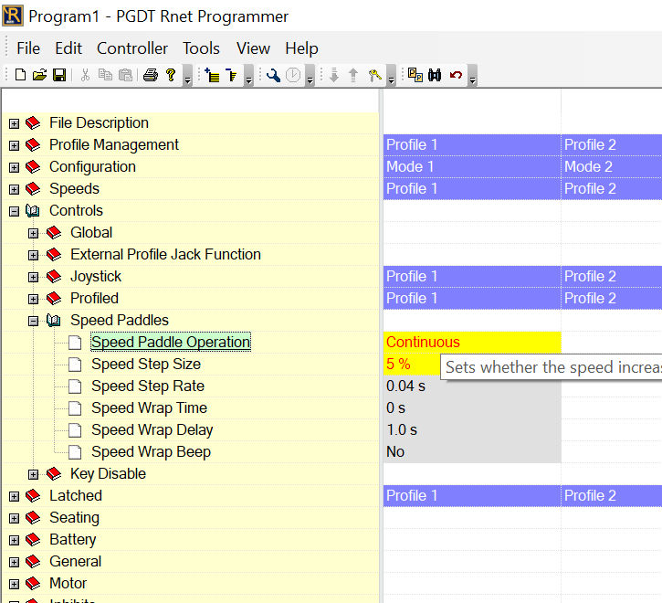

Burgerman wrote:So... How do you change the speed in each profile?
As Rover says, you don't but what you do is add an extra slow profile to compensate. I tear off down the road to the pub flat out then select the slower profile when entering the pub. I have 3 profiles on my LED, fast, slow and empty.
Oh I see, so with different profiles you simply select a slower profile when say going into a shop or on a bus, just as you would select a slower speed with if you have just the one profile.
Got it, thanks :thumbup:
Learning all the time... :geek:
Postby Burgerman » 03 Nov 2022, 17:36
Which pretty much either makes profiles or speeds poointless. Its one or the other.

Postby Burgerman » 03 Nov 2022, 21:44
It takes 1 press... 1 paddle, faster or slower on that same paddle. And you can also do it while still rolling. You got it backasswards.
You need to go through all the options on your LED one to get back to the start.
So how do you do less? :?
selecting a different speed on the CJSM2 as that takes more presses
Postby 700R » 03 Nov 2022, 21:48
Burgerman wrote:Which pretty much either makes profiles or speeds poointless. Its one or the other.
I have posted the workaround which takes nothing to do and is quicker to select. Most settings stay the same anyway, as I'm sure you'll agree. I only slow the speed down indoors as the chair can be too lively with too many legs about to break. My indoor profile is the same as my outdoor programme minus the 2 flicks I'd give the CJSM2 when indoors - simple.

Postby Burgerman » 03 Nov 2022, 21:50
MOSTLY my profiles stay the same. But one has the GYRO enabled and lower load compensation...

Postby Burgerman » 03 Nov 2022, 21:54
No you are wrong. You set it to go from one to the next speed with a short .2 sec delay. ONE press to choose ANY speed forwards or backwardsto slow down or speed up. With a nice clear screen to see what you selected in sunlight. Release when happy. Has nothing to do with profiles or on off switches.
And you get to keep a seperate profile with lowered motor compensation and or gyro working and limited max speed for empty chair use.
Postby Burgerman » 03 Nov 2022, 22:08
HERE
Set continuous. One press to speed up or slow down. All steps. From a 1% step to as high as you want like 50%. With whatever time interval you want. So a one press smooth speed increase to any speed as you sit, or roll. And the same to slow. No need for 5 steps or pushes... Justt smooth continius speed adjustment at any speed you wish. ONE PRESS. No need to go in a loop to slow it, or lose profile options.
You can have your different profiles like with no high speed, and lower compensation for an empty chair too.

Postby Burgerman » 03 Nov 2022, 23:12
No, I'm not wrong at all. If you prefer the CJSM2 that's your preference. I use both regularly and prefer the LED controller. I have no problem understanding the LED controller settings and don't even need to look at a screen let alone one that NASA can see. I can press a button down easier than I can flick a paddle to the same speed rating as a pre-configured profile.
That wasnt your claim. You said several times that it took several clicks to increase speed... IT DOES NOT. Now you keep giving different reasons/escuses.
The LED one is fine. I have one. If you prefer that thats fine. It is not as programmable in what switches or buttons can do, it has less easy to see and understand info on screen regarding seating etc. Its just easier and better to use as it doesent need a complex human memory to work out what does what outdoors. Also allows error codes, and on board programming options. You may like the LED one and thats fine. But they both are. But your claim that the CJSM2 needs multiple presses or will tip you out is nonsense as the rate that the speed increases on ONE PUSH happen, in 1 degree levels if you wish can also be programmed to be gentle. Or to stop at a max speed. So thats allso nonsense!
