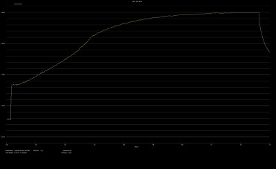

Re: AGM & GEL BATTERY INFO for POWERCHAIRS
Postby Gnomatic » 11 Nov 2016, 17:29
Here's the graph from my working Schauer charger.
Postby Gnomatic » 11 Nov 2016, 18:28
Not much of a CV stage one that one either.
Postby Burgerman » 11 Nov 2016, 18:37
That one leaves the battery at about 85 percent charged! Stops charging at CV!
Gradually you are learning why I use the PL8 or a marine charger, or a power supply for a few hours till amps fall to a fraction of an amp.
Every charger you test is crap! They all do something different to what they claim.
