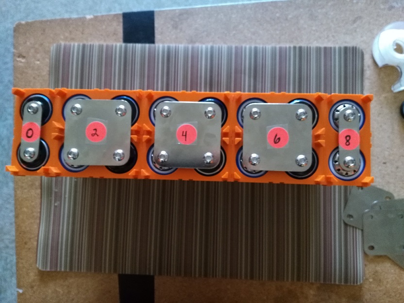

Postby expresso » 22 Oct 2022, 03:53
Pics have been deleted by mistake
here they are - if any one interested -

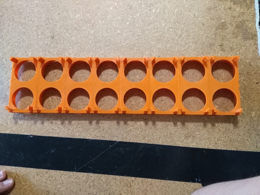

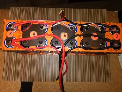

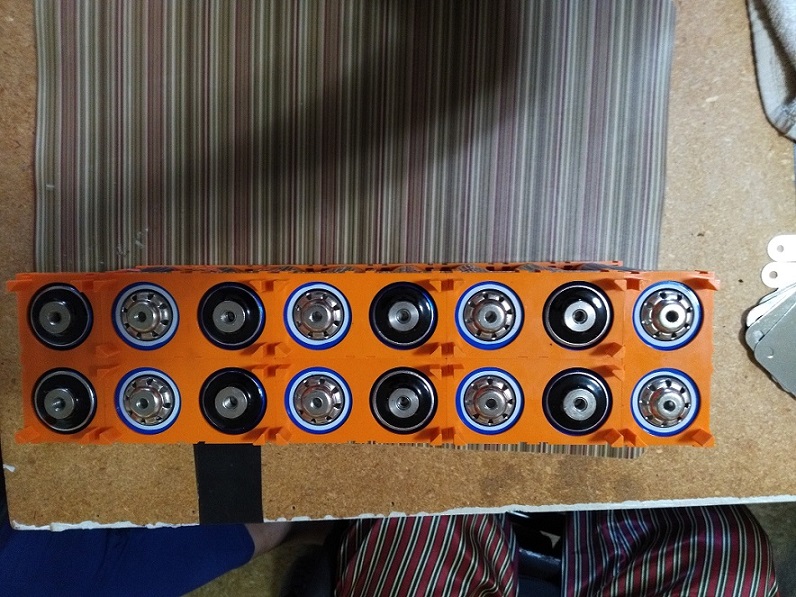

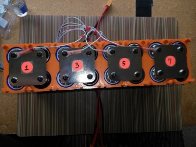

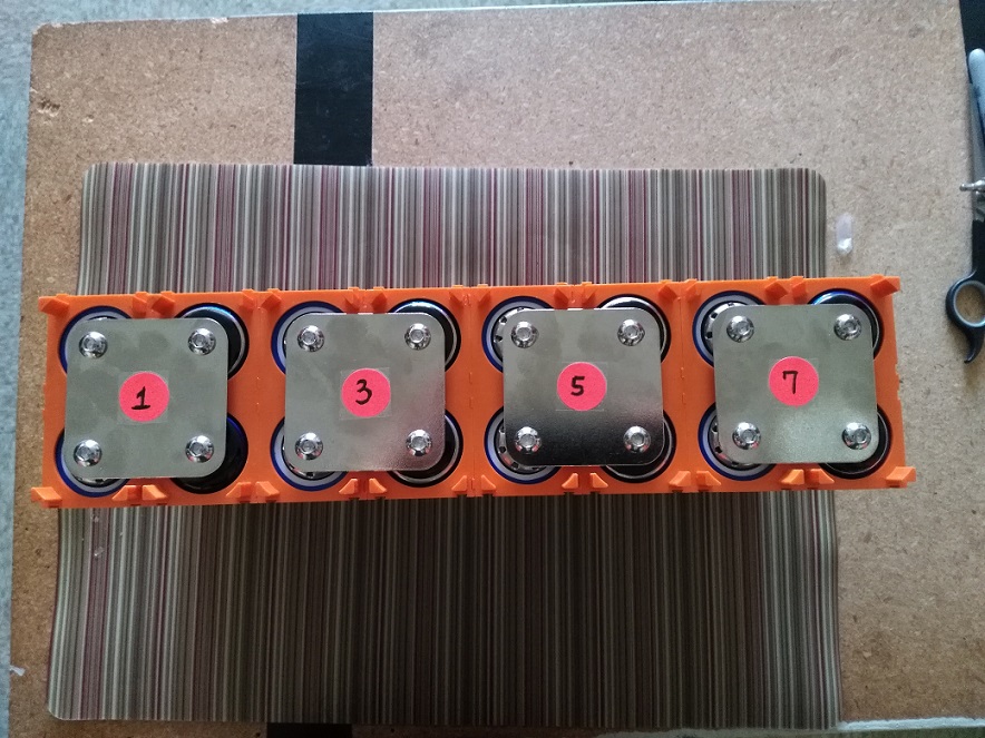

Re: PINNED - ADD ON PACK Step By Step 30ah Pack build / pict
Postby expresso » 22 Oct 2022, 03:54
more

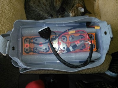

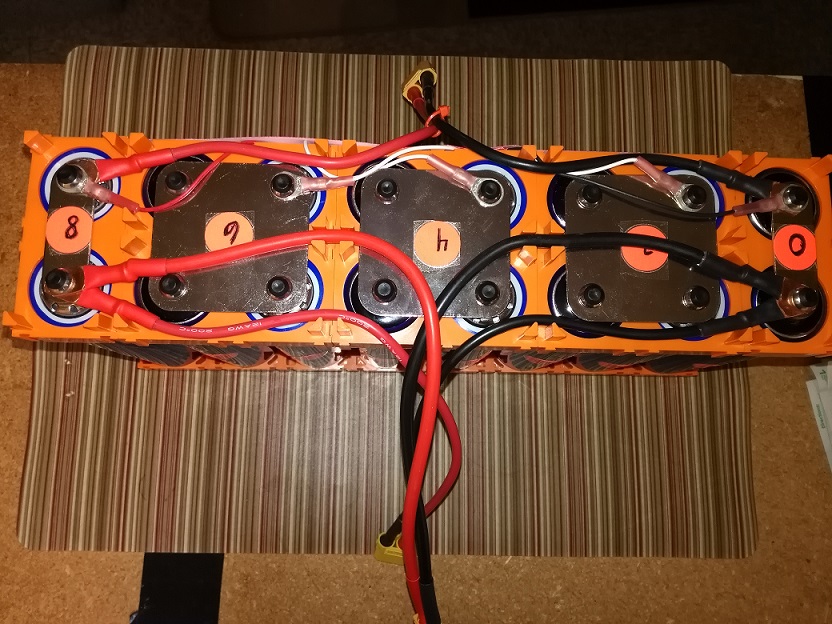

Postby expresso » 22 Oct 2022, 03:55
more

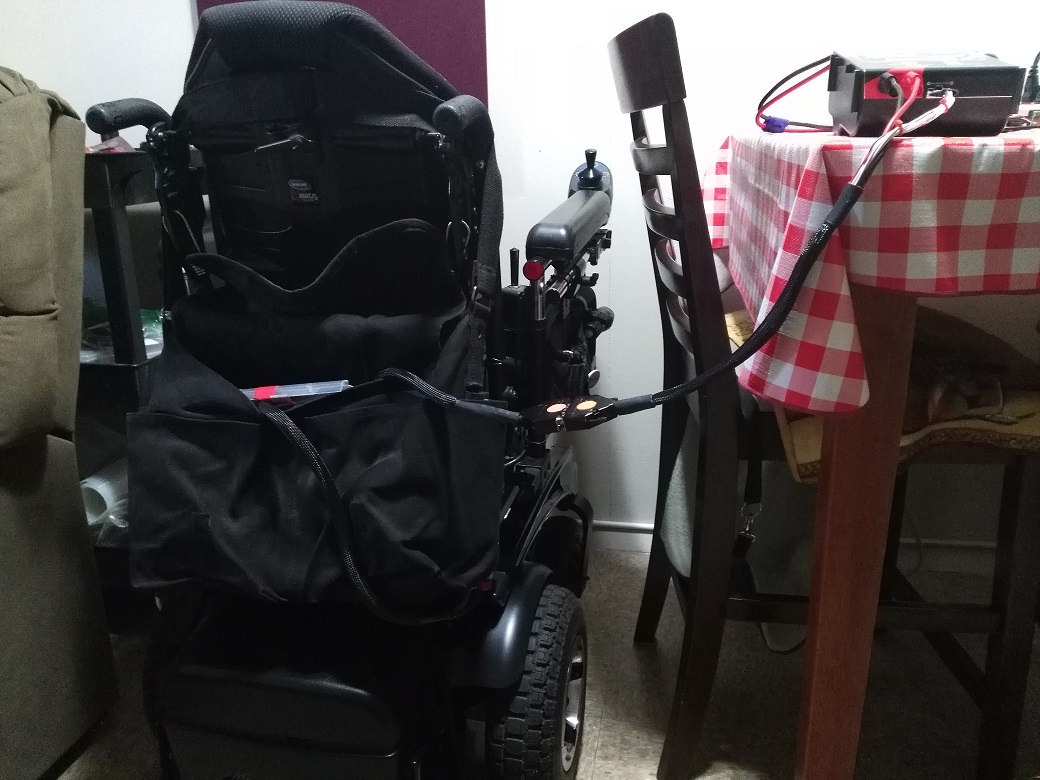

Postby expresso » 22 Oct 2022, 03:58
more

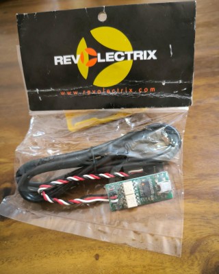

Postby shirley_hkg » 22 Jun 2024, 12:56
Burgerman wrote: But you CAN set up a hobby charger and use that to charge the lithium, with balance connector connected, to charge the lithium. Which will also charge the lead providing you set the thing in a way that will do both. Which you can. If you get the right charger. The PL8 is out of production, so you would need to use a different one and others will advise as I dont use these. But not cheap... .
If you find PL8 is your best choice, I have brand new units (New-in-box) to offer.
Postby Burgerman » 22 Jun 2024, 13:09
Which I would buy. At least 2. But only with a bunch of balance connector plugs/cables. And a FUIM3 USB connection gadget. Those are all essential and also all but impossible to find now.
Postby shirley_hkg » 22 Jun 2024, 14:54
They are ALL available, balance wires with JST connector, and FUIM3 usb interface.
https://www.wheelchairdriver.com/board/ ... 49#p202249
