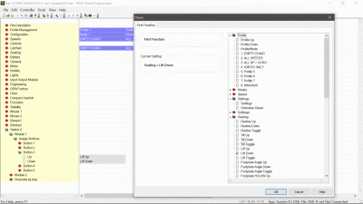

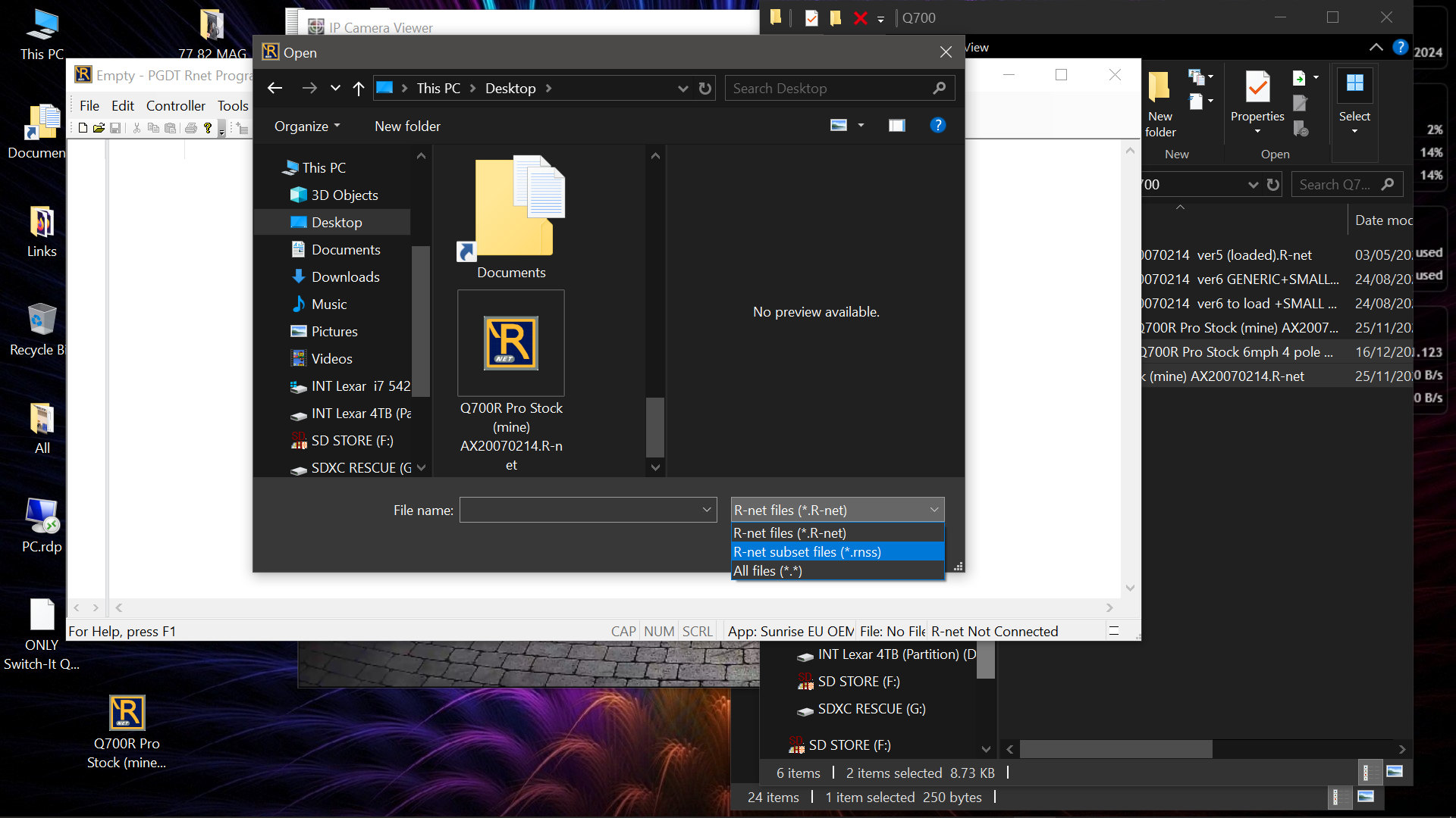

You will need to navigate to the menu, then to this fle, then choose the Rnss fle extension as per image. This is only a set of additional settings and not a complete file. And send to your chair.
And here is the file that should give you the Switch-It menu options. And thats ALL it will add. It will not change any other settings or add anything else.
If that doesent work, only then you can load my own file instead and change ALL other settings back to match your own existing ones.
Here.

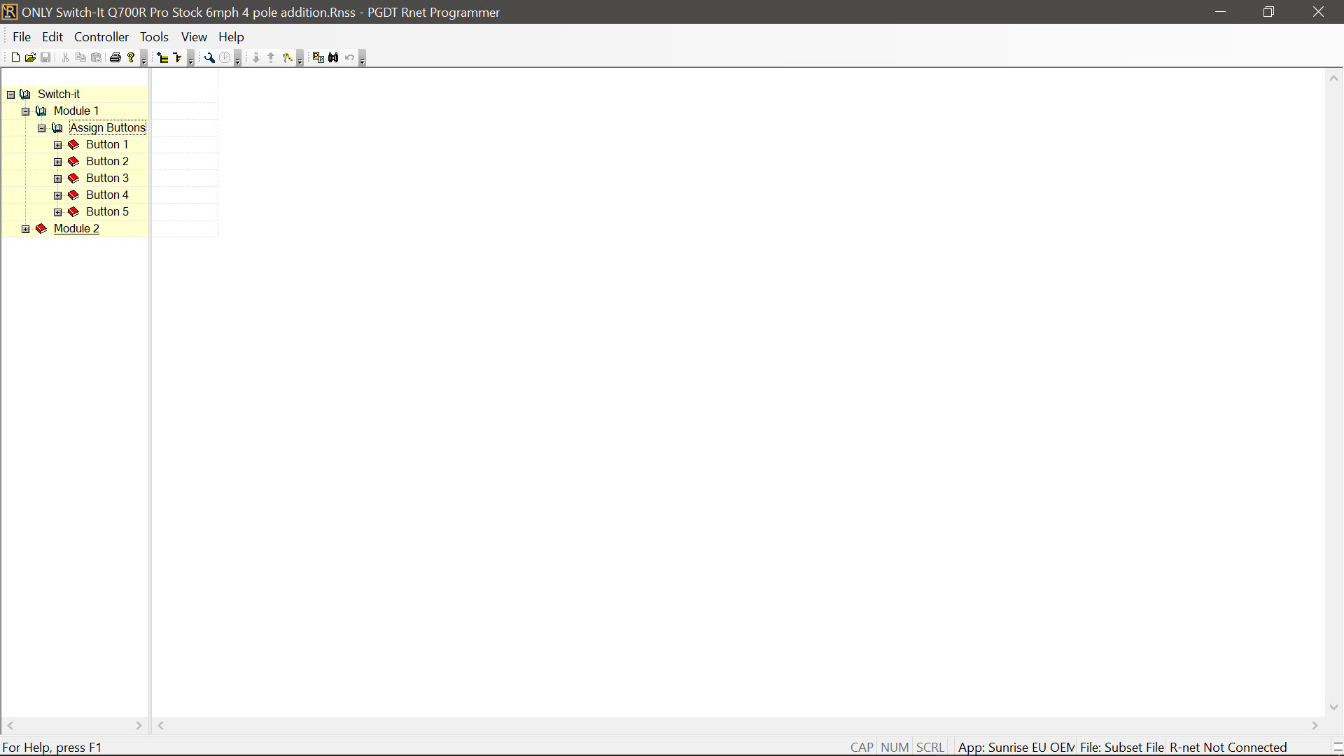

I opened the subset file in the rnet software but nothing is showing (screenshot: https://i.imgur.com/PnFTpbBl.png). Is this normal and should I just write to the chair anyway?
The dealer is fitting it but I'm not sure if they will be able to make it appear with their rnet software. I asked them to mount and connect the cables and if necessary I can manage the software side. So thanks for helping me with this.
JenR
Posts: 39
Joined: 11 Feb 2014, 12:38
Postby Burgerman » 16 Dec 2024, 16:09
With the SUNRISE OEM software and possibly others you will see this:
These are SUBSET files.
OPENED: (look top left)
After you click it:
Posts: 71102
Postby Burgerman » 16 Dec 2024, 16:13
PM me...
In order to SEE the file contents you will need OEM software.
If using Dealer level software you cant see it or edit it, it will give a message asking if you want to send to the controller when you open it. You do.
Then youneed the "workaround" to edit it and other OEM level parameters. So PM me.

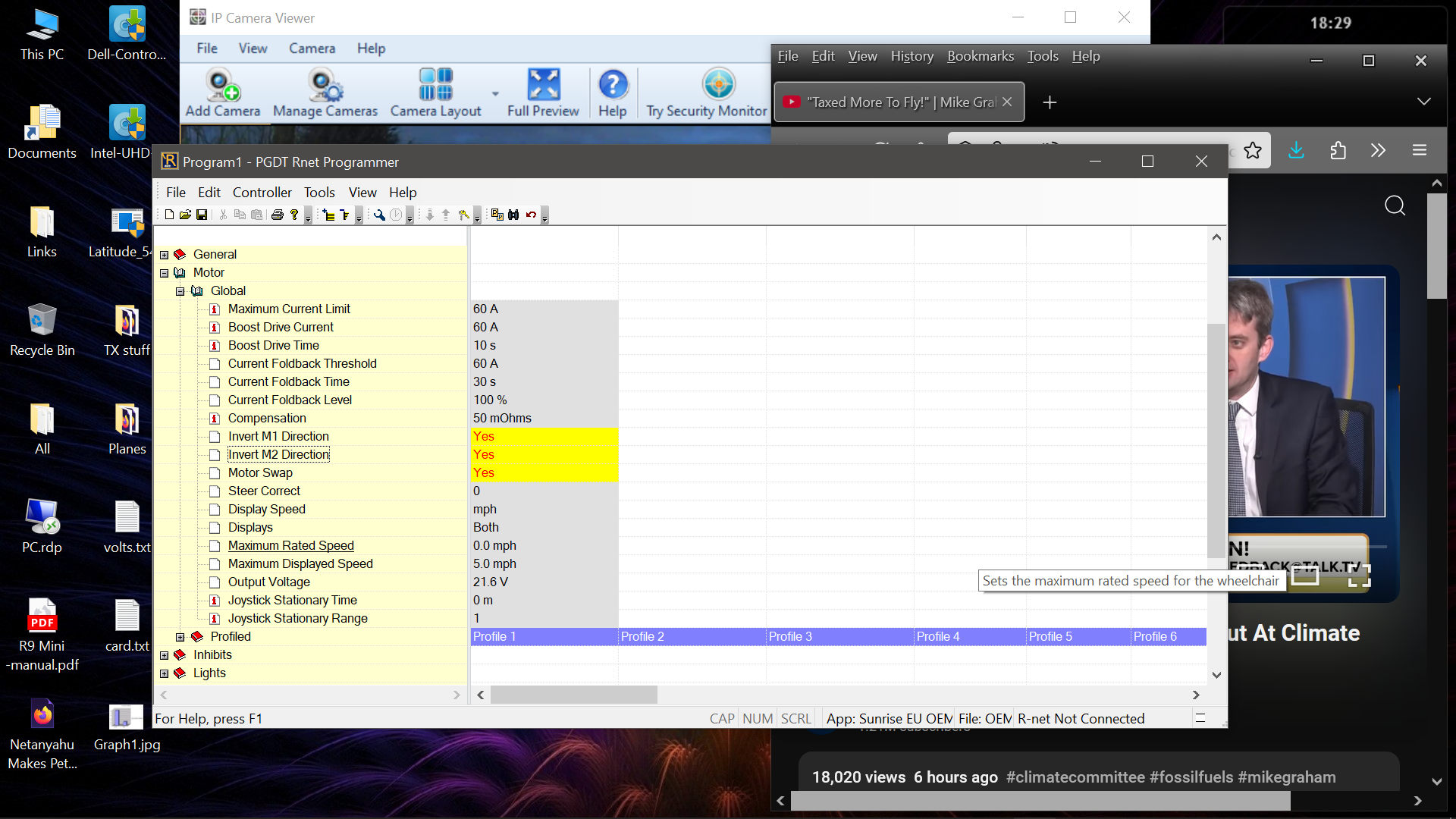

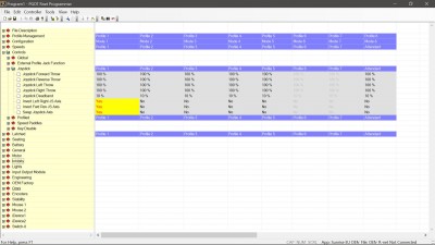

OK.
When you added this, did it turn right or left when you pushed the stick forwards?
If so did you change the joysytick axis direction?
If so, then thats the cause. If not then someone has already done that on the chair that you took the power module from. Incorrectly. I suspect. Its the only way I can see that this is possible.
And if so then theres no way it can ever drive properly. Theres 2 stages to this, lets do stage 1 frst.
Go into programming, and look at the three things in yellow!!!
SET ALL TO NO!!! Right across every profile.
That will correct your joystick SEATING, and tell the power module that forwards is actually forwards.
However now it wont drive properly!!! We will fix that in the next post if any of this is set to yes as I suspect.
CHECK THESE
Below:
Posts: 71102

That's got it toggling okay. To raise the seat and lower the seat it's forward to raise and back to lower. My other chair is opposite - back to raise and forward to lower. Which is standard or is it just personal preference?
segreen
Posts: 530
Joined: 07 Feb 2010, 20:31
Location: Bolton, Lancs. UK
Postby Burgerman » 26 Feb 2025, 19:05
Up to you. But set all to NO there....
Now the chair will drive incorrectly right?
Now we need to fix that. Because it will drive 90 degrees out of wack! Test.

Postby Burgerman » 26 Feb 2025, 19:38
So then. What had happened is that some numpty had incorrectly tried to fix the chairs directions as I explained right in the beginning, albeit before you got hold of the controller by swapping the joystick directions instead of the motor directions :fencing
So your chair was THINKING it was going forwards when you turn. So in programming the forwards speed and acceleration settings are changing the turn... And the turn speeds are changing forwards and reverse speeds! And always were ever since the numpty thing.
So now we have the JOYSTICK correct you need to do the following:
1. go to the three YELLOW feilds shown below under Motor.
2. Adjust these three, they may say yes or no, and theres no "correct" or universal here as all motors are wired differently there is only "it now drives properly"...
3. Once thats correct, reply here and I will show you where to reverse the seating directions so that it does what you want...
Posts: 71102
Postby Burgerman » 26 Feb 2025, 19:48
Never mind, I know that will work so I will post the seating thing anyway.
So if you have a normal ISM6-L go to the yellow fields below, and change the yes to no, or no to yes as required, as theres no standard for this either.
So the seating goes in the direction you want.
Do as many seati ng channels as you want or need. They are all named below so you cant get them wrong.
Posts: 71102
Postby Burgerman » 26 Feb 2025, 19:52
I swear I know more about there R-net things than the manufacturers do...
Does that now work properly?
Questions.
Did you set motor compensation correctly as if that is wrong all sorts of shit happens. You do not need change it IF they are the same 4 pole and same speed motors for e.g. But if different to the donor chair you must. Fortunately all sunrise chairs seem to use 12V on brakes so that will be correct.
Posts: 71102
Postby segreen » 26 Feb 2025, 19:56
Okay, got it driving okay on Yes, No, Yes.
