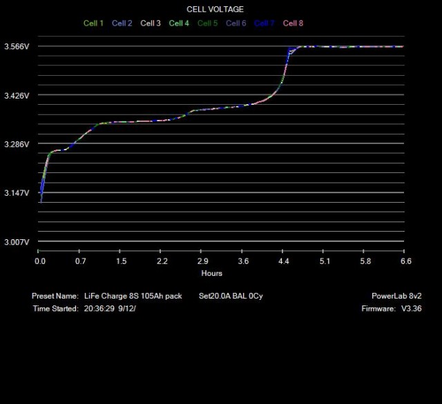

Postby ex-Gooserider » 10 Sep 2024, 05:21
Well just finished the recharge to full - put in 94,191mAh in 6.6 hours - Graph didn't show much variation in the cells, especially once it peaked... Judging from this first test, it looks like the long sit at full charge didn't do a lot of harm... I did notice that it reached full charge (the knee in the curve) at about 5 hours, and then spent the next 1.6 or so hours balancing - is this OK or should I tweak something in the preset? (It said to terminate at 240mV)

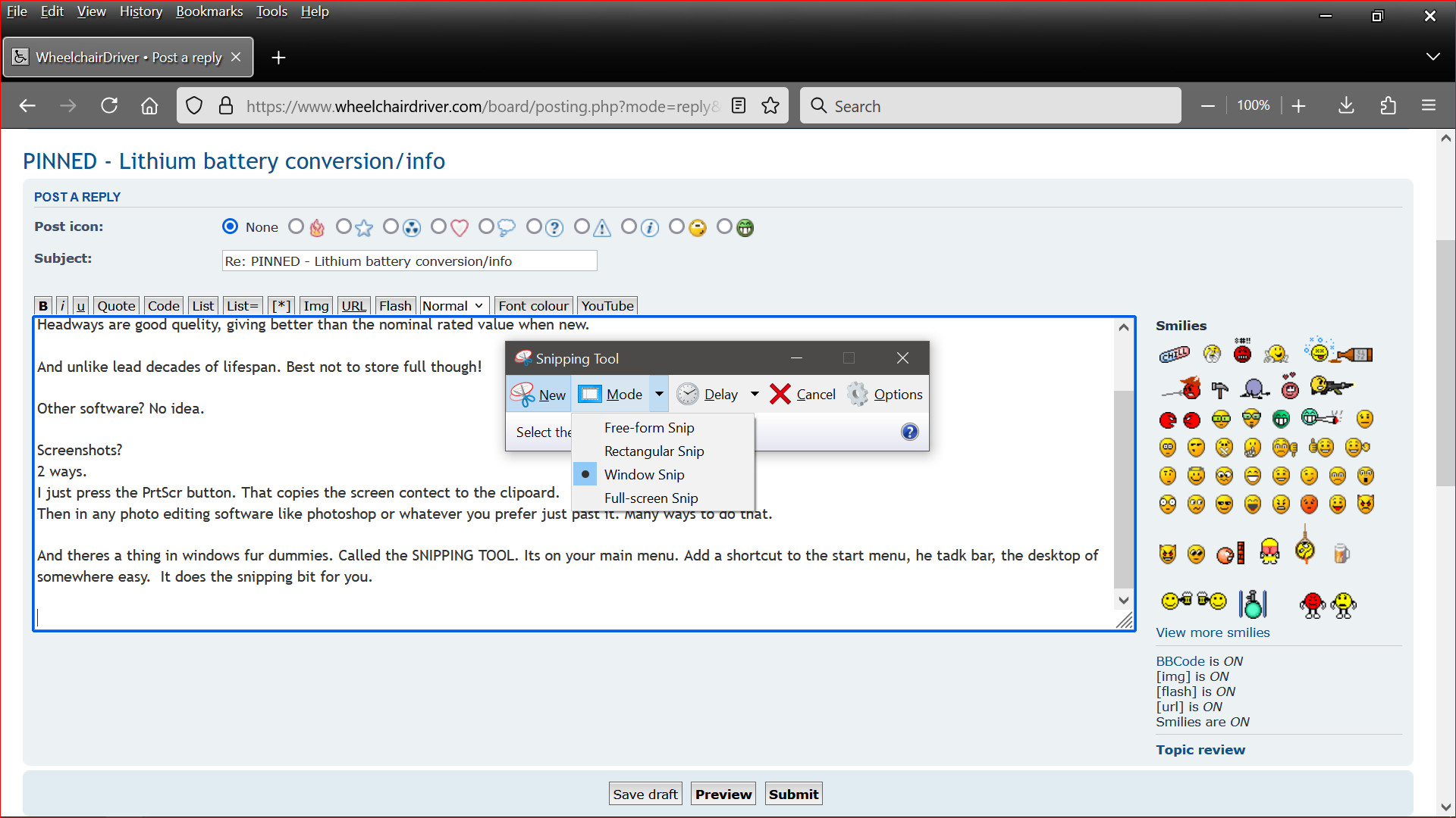

2. What is the best way to get the sort of photos of graphs that people are posting?

Screenshots?
2 ways.
I just press the PrtScr button. That copies the screen contect to the clipoard.
Then in any photo editing software like photoshop or whatever you prefer just past it. Many ways to do that.

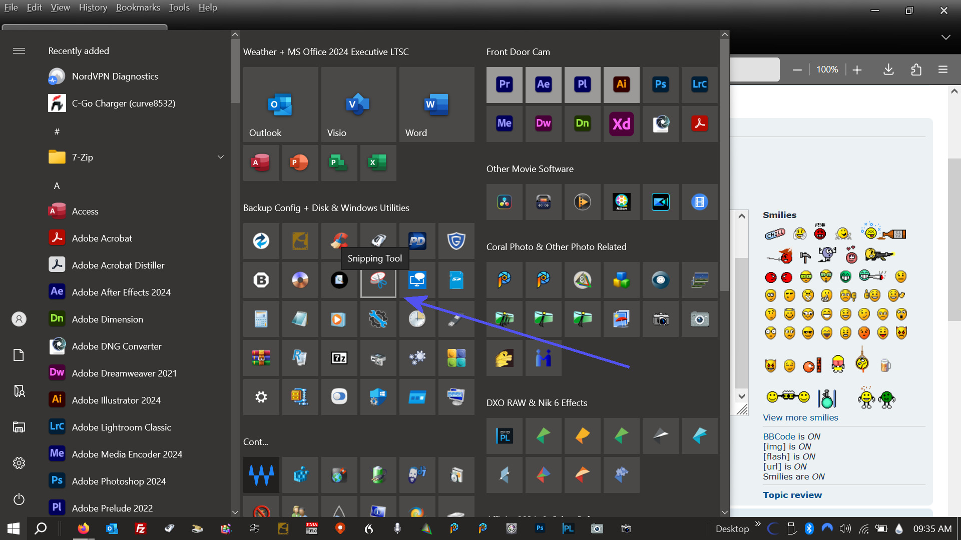

And theres a thing in windows fur dummies. Called the SNIPPING TOOL. Its on your main menu. Add a shortcut to the start menu, he tadk bar, the desktop of somewhere easy. It does the snipping bit for you. I dont use it as keyboard shortcuts and copy past cont-v and ctrl-c etc is faster. Along with photoshop for edits and saving.
MY menu, yours will be on the main list not here...

Postby ex-Gooserider » 14 Sep 2024, 04:41

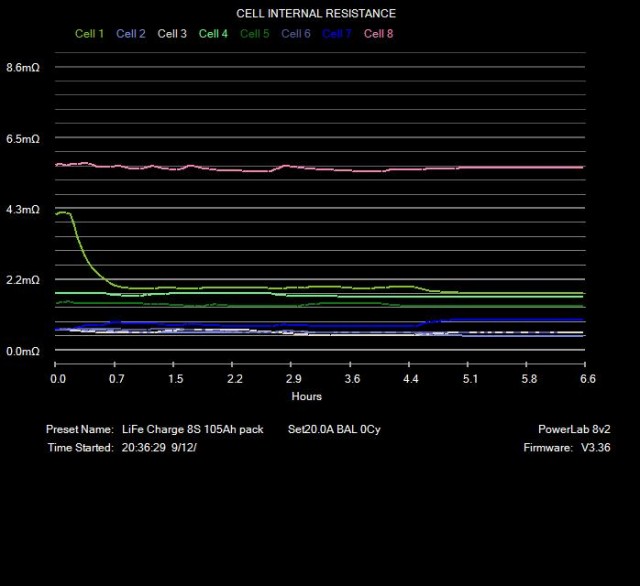

Well I did another discharge to 2.9V and recharged, and got the following two graphs, one of voltage and one of internal resistance...
The discharge had the cells tracking VERY closely... The charge did as well except right at the start.
I'm concerned about the one cell that is so much higher than the rest... Should I be?
Cell charge graph
Cell resistance graph
Postby Burgerman » 14 Sep 2024, 05:23
They all look fine.
Internal resistance is not accurate. Dont worry. It IS accurate on a hobby lipo, charging on 3 inch long wires with super low impedance cells...

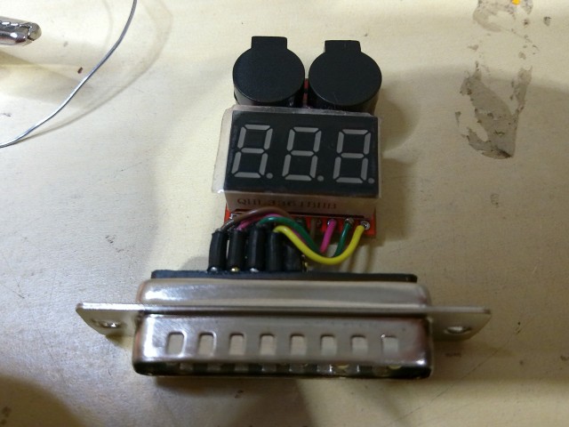

I'm having a problem w/ my battery tester that I posted about a few messages back - same view as a reminder...
It is a cheap Ebay battery tester, that I think a lot of us have used in the past... It is supposed to cycle through showing the pack voltage and then each cell, with a settable alarm for any cell that goes to low...
I cut the shrink wrap plastic cover off it and hacked the connector to fit the battery charge connector, with the idea of putting it in a connector shell and thus having a nice small checker for my pack.... I wired the 9 pins of the tester to the 9 balance wire pins in the connector, which seems pretty obviously the way it should be wired....
However I get an alarm every time I plug it in... I get the correct pack voltage, and cells 1-6 are in the expected 3.x V range, but cell 7 shows 10.4V :shock: and cell 8 shows ZERO.... I have spent considerable time verifying that I made the connections correctly, no shorts, etc.... (both visually and with a meter) Everything looks fine... banghead
As mentioned, the pack does the right thing with the PL-8, so I know the pack is wired right.
So I thought I had possibly gotten a defective unit... I got these from Ebay back when I bought the cells, and it was one of those offers for 5 testers for one price... So I have a bunch and did a quick and dirty job of making up a second tester w/ one of my unused plugs and just soldering to the legs of the tester...
It does the same thing!
Any idea what I might be doing wrong?
Postby Burgerman » 16 Sep 2024, 00:26
No. I have a few, they all work perfectly. Not super accurate but good enough. I dont know what you are doing...
Should be wired, neg, on wire 1, then wire 2 onto pin 3, 3 to 4 etc until cell 8+ is on wire 9
What you gona need there is a multimeter! :clap
Maybe you have some pins wired wrong on both halves so that the pl8 sees it correctly.
Postby ex-Gooserider » 16 Sep 2024, 00:57
Burgerman wrote:No. I have a few, they all work perfectly. Not super accurate but good enough. I dont know what you are doing...
I've checked both visually and with a meter from the pack to the PL-8 and each cable - all show no problems... I also did a voltage test, and each shows the wiring is correct....
The pack is wired w/ the pack negative on pin 1,
+ of cell 1 (and neg of cell 2) on pin 2,
+ of cell 2 (and neg of cell 3) on pin 3
etc until pack plus (cell 8 +) is on pin 9
I am wiring the 9 pins of the checker the same way... This doesn't match what you are describing but I don't see how that would match the tester pin out...
Postby ex-Gooserider » 16 Sep 2024, 01:04
I wired everything according to the FMA wiring mode per the PL8 manual, and have the PL8 set to use FMA mode, but it appears that if the pack is 8S, then there is no difference between the FMA and XH/EH modes...
I don't know what the checker is expecting, but since it's looking at an 8S pack, it shouldn't matter...
Postby ex-Gooserider » 16 Sep 2024, 01:16
Also I just did a test of disconnecting the 5-8 pack since it was easy to do, and the checker works fine on cells 1-4 - shows pack voltage of 13.6 and each cell around 3.3v as expected... It will be a bit more of a pain but I am thinking it might be worth trying the 5-8 pack by itself....
Postby ex-Gooserider » 16 Sep 2024, 02:03
I just did that, by removing the wires to the tester for cells 1-4, and moving the ones for 5-8 over to the first 5 pins of the tester - it worked as expected - 13.3V total, 3.3x per cell... So it seems to be something strange with the tester itself, or the proper wiring is not what it looks like it ought to be...
Postby Burgerman » 16 Sep 2024, 02:21
Is one of them crimped and not making contact?
Postby ex-Gooserider » 16 Sep 2024, 03:00
Burgerman wrote:Is one of them crimped and not making contact?
The pack wires are crimped except for the soldered connections to the DB charger connector, using proper crimpers, in accordance w/ mfg specs.... Also if one wasn't making contact, the charger wouldn't be working right either...
My wiring for both the original tester and the test setup is soldered....
Postby shirley_hkg » 16 Sep 2024, 03:14
Scammed..
This can only do 7S, though looks indifferent.
A $20 Active Balance BMS with Bluetooth for monitoring is not unworthy . Check everything on your phone. Cool.
Can be re-use in future.
Postby ex-Gooserider » 16 Sep 2024, 03:26
Thanks Shirley... I will look into trying to find a similar unit that can do 8S, as I like the form... I am NOT interested in doing a BMS - no matter how fancy I doubt it would work on my flip-phone...
Postby ex-Gooserider » 16 Sep 2024, 03:52
Seems it isn't even as good as Shirley claimed... I did a quick reconnect back to the original cells 1-4 configuration, and then added the wires for cells 5-7, leaving 8 disconnected, so acting like 7S. Got a pack voltage of 30V, normal 3.3+ on cells 1-6, and cell 7 read 10.4 volts (but I didn't get an alarm!) I took the wire off cell 7, making it a 6S tester, and it worked properly.... So definitely defective units...
I'm going to go ahead and try the other three since I have them, but don't expect much.
As an idle thought, how safe am I in just using the tester as a 6S unit, and not looking at cells 7 & 8 working on the assumption that if 1-6 are OK then the other two presumably are as well?
Postby Burgerman » 16 Sep 2024, 04:09
Considering that I used to use the pretty good tester that works well, below, and now use absolutely nothing at all for years then I wouldnt bother!
Maybe for a week, to get the idea. Then your joystick will tell you all he clues you need.
Postby shirley_hkg » 16 Sep 2024, 04:13
You've done a capacity test that shows the lowest pack volt you shouldn't pass.
A voltmetre is good enough.
That thing itsn't good. It beeps under load where it's still far from empty.
Postby Burgerman » 16 Sep 2024, 04:23
Its not meant to test cells under load though. Thats a resistance test!
All cell logs should be used when not rolling. Not meant to leave plugged it.
Although with a hobby LiPo that was the intended use, that doesent actually matter as the silly LiPo batts dont drop volts as you load them up significantly. Because 130C etc... A 4Ah one will start a car!
Postby ex-Gooserider » 16 Sep 2024, 04:29
Yup all of them are junk... :evil: Work as 6S testers just fine, not as 7 or 8S... Looks like it must have been a bad lot or something, as all do exactly the same thing.
