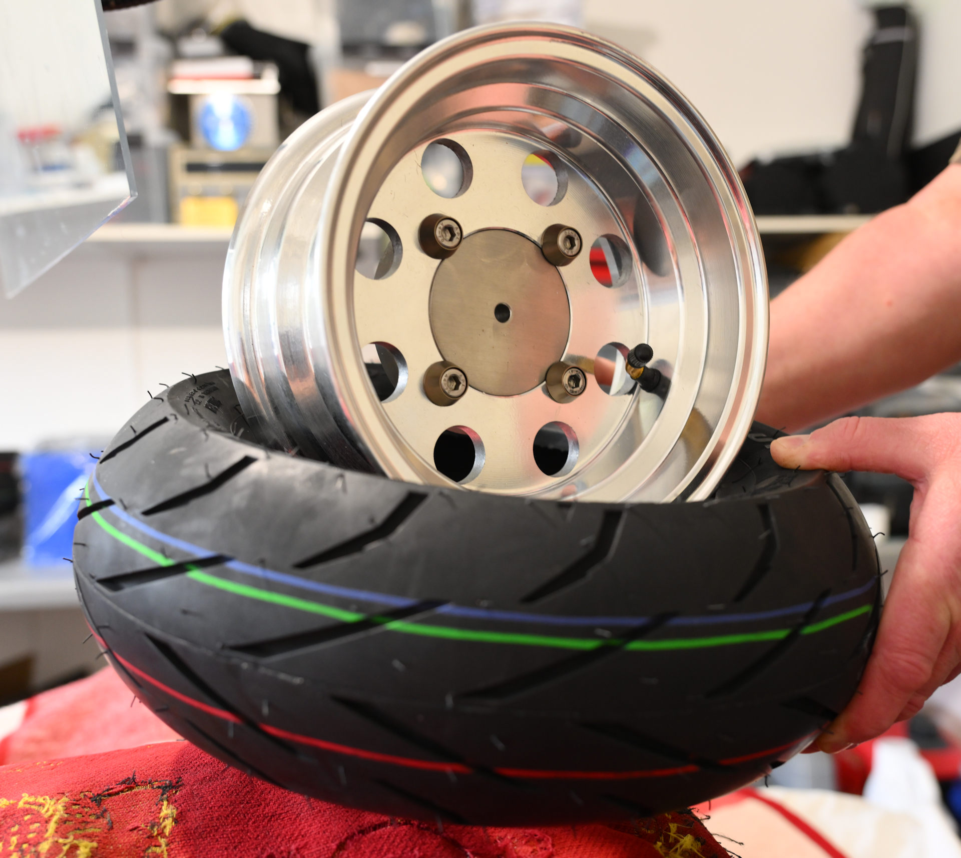

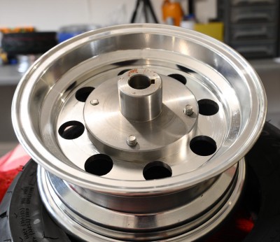

How do I go about fitting rear wheels and tyres like these to my new 'used' salsa/jive?

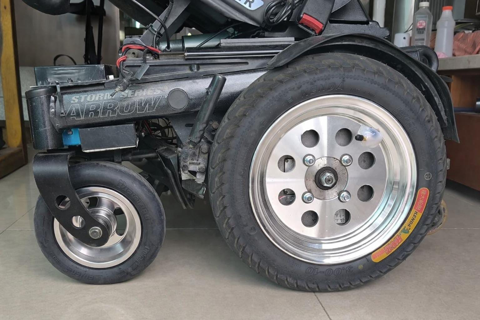

Postby shirley_hkg » 12 Jan 2026, 13:47
Found this very nice tubeless wheel for caster , and I'm sure it will give a comfortable ride.
80/60-5 (9") and 10"x3.6-5 to choose .
@£12

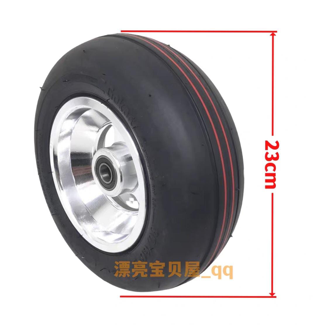

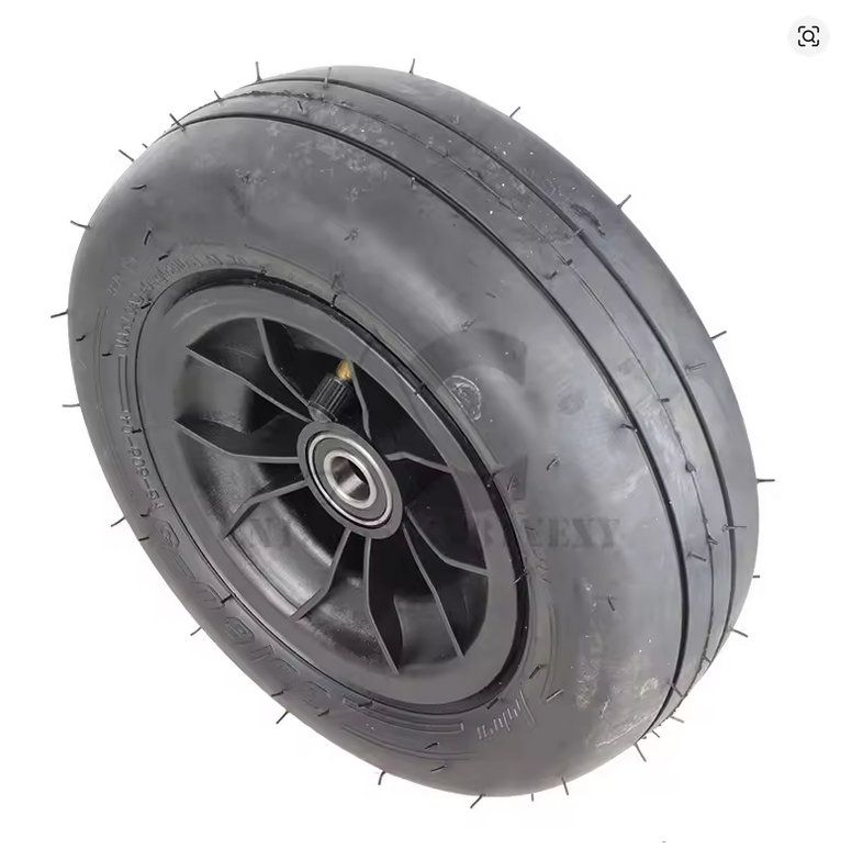

https://www.aliexpress.com/item/1005005542260282.html
https://www.aliexpress.com/item/1005009698870060.html
It has 6002 bearings installed. Need to do 14.98mm shaft and pair of spacers.
Re: Punctures!!! Grrrrrrrr
Postby Burgerman » 27 Jan 2026, 09:16
Thanks.

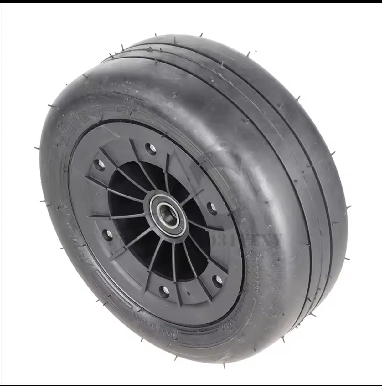

Was looking at the plastic ones a week ago. Same tyre size. Same type. But cheap and no corosion. Should be plenty strong enough. What do you think?
https://www.aliexpress.com/item/1005007156512831.html
All these chinese wheels use 15 x 32 x 10 bearings and need a 15mm shaft.
If you just replace that 6002 cheap ZZ bearing with a 6201RS or 2RS in stainless steel (eBay) then you can use a typical stock powerchairs existing 12mm axle shaft. And a couple of 12mm bore spacers. These are 12 x 32 x 10 sized.
How do I know? I have some on the shelf!
Posts: 71089

Are you sure it is tubeless ?
My aluminum rims costs 25% more, but it looks much better, exceptionally good with monkey bike rear wheels.
Postby Burgerman » 27 Jan 2026, 12:17
Theres 2 different plastic rims A and B. One is a split rim. With bolts.
That a picture of one. The other looks different and shows no screws. I was thinking it was tubeless. Maybe not?
No bolts...
I do wish they would give more information. We always have to guess.

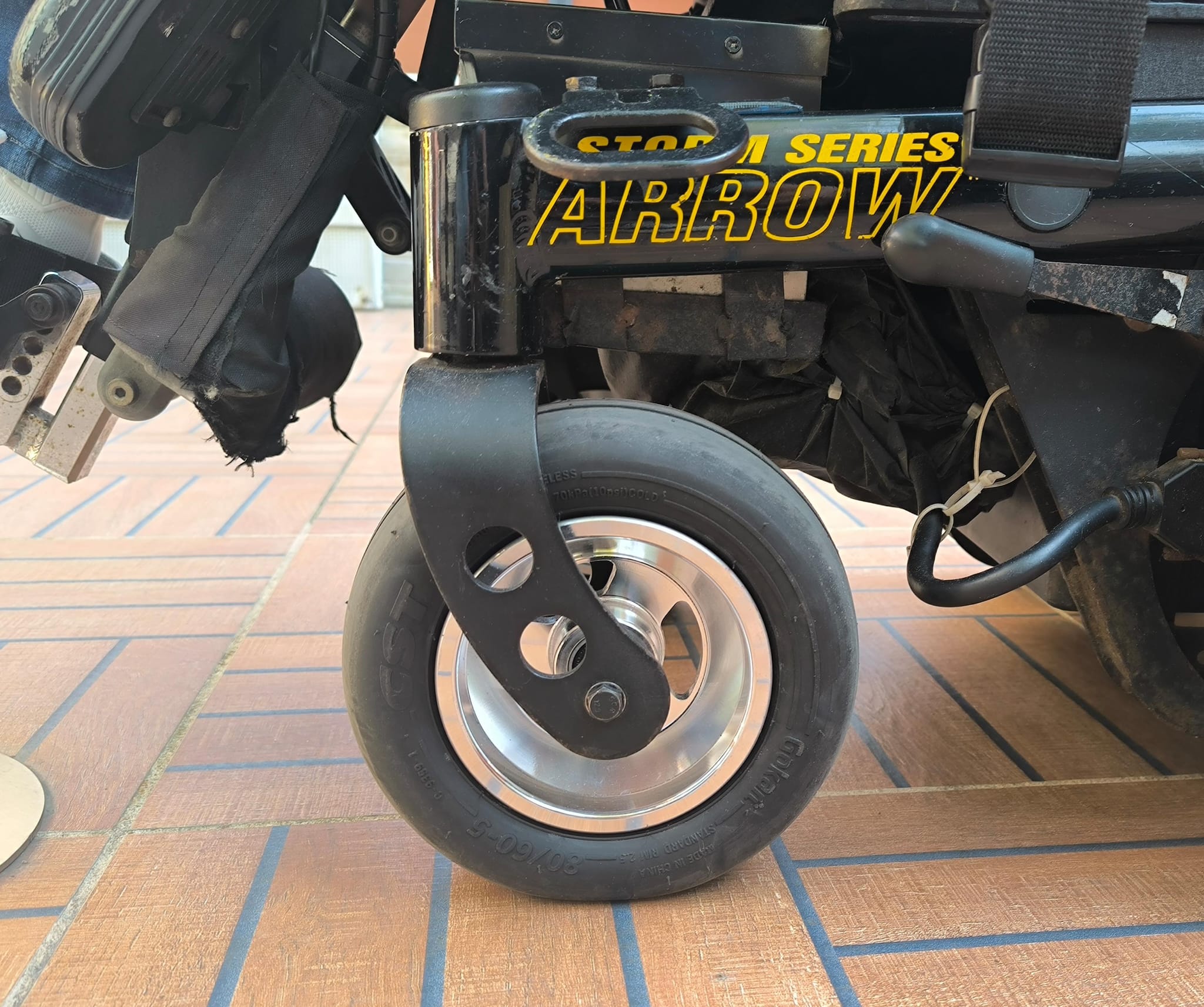

Postby shirley_hkg » 07 Feb 2026, 03:04

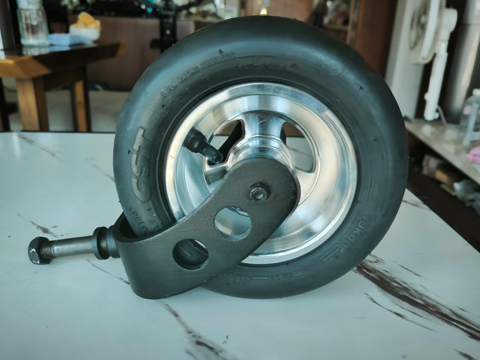

@£10 tubeless casters mounted.
Inflated to 9 psi. Couldn't go lower or tyre came off bead when hitting curbs sideways.
Postby Burgerman » 07 Feb 2026, 07:40
So theres no lip, that a tubeless tyre should have?
Looks good! But you could have used stainless bearings and stainless bolts because it will rust and look bad.
Posts: 71089
Postby shirley_hkg » 07 Feb 2026, 08:55
It comes with RS bearings.
Tyre is £6 alone and I still have to pay someone to mount it.
Whole wheel is £10. Why bother.
Yes. It looks very nice, well matched with rear tubeless rims.
Postby Burgerman » 07 Feb 2026, 09:29
Why? You say it looks nice. And it does. But as soon as it gets wet it will rust. And so wont look nice for very long. And so the bearings dont die when water gets in, because thats what kills bearings. They dont rear, they corrode internally. And so that the bearing/bolts do not rust and doesent look bad. Stainless 2rs bearings, and stainless allen bolts are very cheap too. Reliablity is key. At least to me.
Posts: 71089
Postby shirley_hkg » 07 Feb 2026, 10:13
Here we don't have salty corrosive pavement / roads. Steel bearings last for a decade. I definitely need to replace the tyre before that.
My last tubeless drive tyre and rims lasted for over
5 years. I changed the rims as well, though it was just not looking nice anymore.

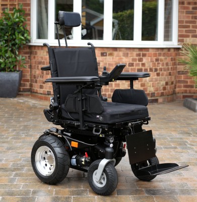

Postby Raro » 07 Feb 2026, 17:47
They look great! Post a picture showing both the front and rear wheels, Shirley.
