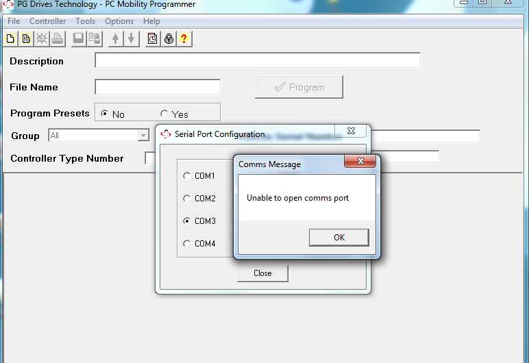

With the USB Adaptor plugged in to the puters USB port...
Open up the pgdt programming software ...ignore the warning...
Click Tools
Click Comms
Click on COM 6
Close the boxes ...
Exit the program and restart it.
The warning should be gone
Refer to my pictures if you need to.
Re: PGDT interface update
Postby woodygb » 20 Sep 2012, 17:16
Don't panic if the warning is still there ... we'll just try ticking each COM box number in turn... .Starting with 1 ..as this I suspect is the installed default.
Eventually you should find a COM port where the warning ...shown in this pic...will just dissappear.

Holy Saints............with com 6 ticked : Comms Active !!!
Endebbed!!!
