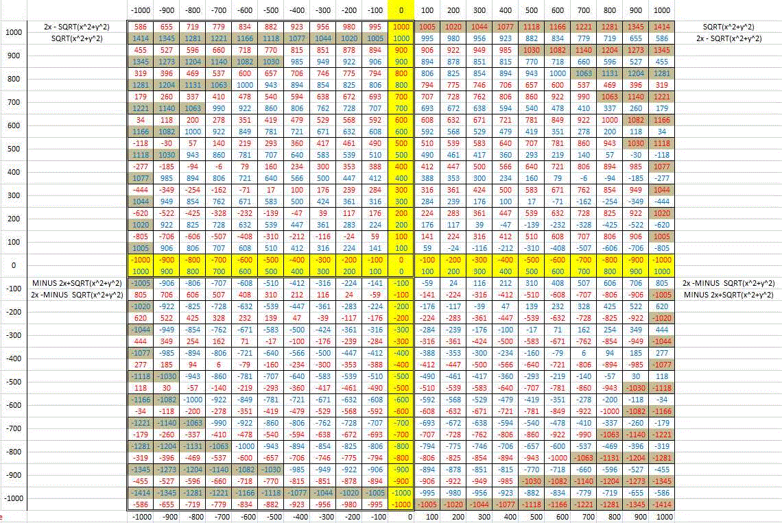

Postby woodygb » 08 Sep 2012, 00:56
As a starter try ....
2*JOYY-SQRT(JOYX^2+JOYY^2)
SQRT(JOYX^2+JOYY^2)
or a variation of the above
notation is JOYstick Y axis JOYstick X axis .... they're copied from an Excel spreadsheet I did ...it fills in the "circle" nicely without dead corners.
Postby LROBBINS » 08 Sep 2012, 01:15
I'll try that, but how does one approximate a square root function with integer arithmetic (in a MicroBasic that doesn't have SQRT)? Ciao, Lenny
Postby LROBBINS » 08 Sep 2012, 01:27

Postby woodygb » 08 Sep 2012, 09:54
I know you said not to bother ..but it was nearly done.
BLUE is a R.H. motor .... RED a L.H. motor
A solid block indicates that the 1000 limit has been reached.
There is an additional change in sign for the reverse ...thus minus minus = plus
I've no doubt that you could find a better way of doing it.
Postby LROBBINS » 08 Sep 2012, 10:20
Thanks, I'll see whether this matches Roboteq's MixingMode 3 and also use it to test whether applying compensation pre and post mixing is still equivalent with this non-linear algorithm. Ciao, Lenny
P.S. I'll send you a PM with my e-mail address. If your willing, I'd like you to send me the spreadsheet itself and then I won't have to do a lot of typing.

Postby LROBBINS » 08 Sep 2012, 11:28
Hi Woody,
I think I've got it now. Not only is there a sign change in different quadrants, but assignment of the y^2+/- (x^2+y^2)^0.5 and +/- (x^2+y^2)^0.5 formulas to the two motors flips in different quadrants.
Ciao, Lenny
Postby woodygb » 08 Sep 2012, 11:56
Lenny,
I'm having to revisit my thinking from many months ago ... it might even be a year plus ...when I first made the spreadsheet ...
Yes there is a flip shift in formula depending on the quadrant or according to the + - value of the signal .
I think there is one cell ...somewhere ..that may have an IF then do formula in it that covers the various scenario's ...
The spreadsheet is really unfinished as I'd reached a point that satisfied my curiosity... and no one at that time had a use for it.
Cheers Woody
