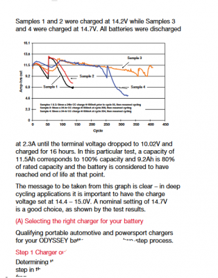

https://www.solar-electric.com/lib/wind-sun/iq4spec.pdf
This holds the battery at 14.2V for up to 8 hours. For Odyssey to have a long service life that must be 14.7V at 20c temperature. So you will get a very reduced service life.
That means that the 24V version will hhold the batts at 28.4V, instead of 29.4V which is bad for them. Please read this below or just the image clip.
http://www.wheelchairdriver.com/odyssey.pdf Specifically page 14, and note the graph on the right side of the page that shows the result of charging at 14.2V. Its not pretty!
So to be clear. That charger, with its 'advanced' AGM charge algo module, will kill the batteries at less than half their expected cycle life.
You MUST charge at 14.7V until 1000th of the 10h capacity rating is reached. Thats around 62mA before dropping that 14.7v down to 13.4 to 13.6V float. Although float isnt required in cyclic use. But that will take 8 hours at CV approx with a 25A charger. 8 hours CV, or 65mA whichever occurs first. Stop if current begins to rise again.

Re: PINNED - AGM & GEL battery info lead battery info
Postby Burgerman » 02 Jan 2020, 03:02
Thats around 4 hours too soon. What are they thinking? I think they understand electronics, and they have a C programmer. And neither of those people have a clue about batteries. So this is what we get.
That means that instead of stayng at CV for approx 6 to 8 hours, or till around .2 / .3A, It just stops... Meaning the lower float voltage must be relied upon to top off the battery. But that lower 27V will take maybe another 20 hours.
So not a good choice of charger unless you have all the time in the world to recharge. If you are a scooter user, and leave it more than overnight regularly that charger will be great.
If like most powerchair users, it gets charged as you sleep, 12 midnight to 8am for e.g., then its useless. It will stop charging after around 2 hours, and drop to float...
What we REALLY need for overnight cyclic charge, is CC then CV at 28V to 28.2V (room temp or less) until it reaches (drops to) 1000th of Ah capacity (so 74mA end, on a 74Ah MK gel) or 8 hour whichever occurs first. At this point its fully charged, sulfates returned to the electrolyte, and can be used. This is the fastest way to do a full cyclic charge in the time we have available. It can also be left to go to float. But its now full, so no real need.
