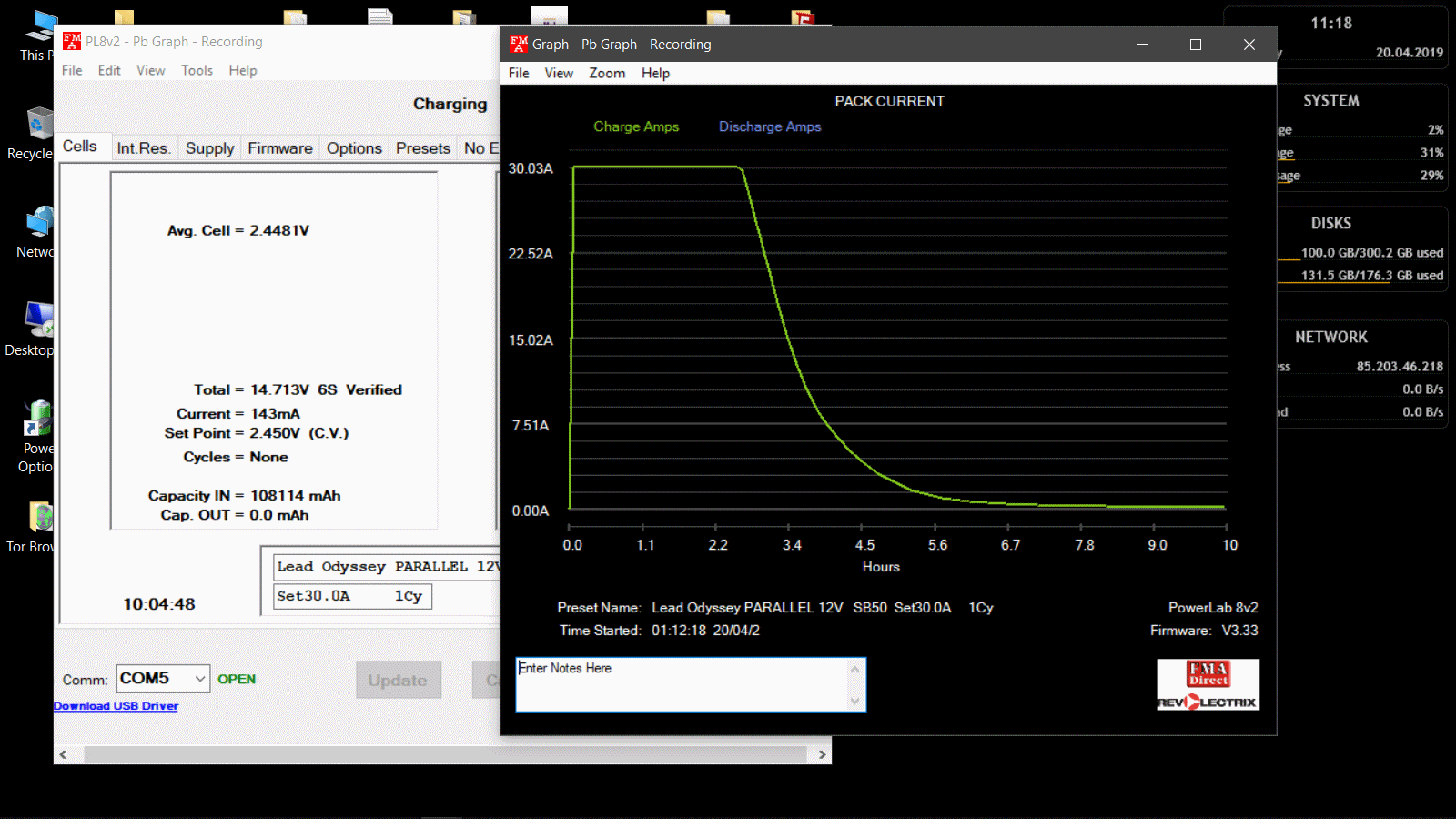

Re: PINNED - AGM & GEL battery info lead battery info
Postby Burgerman » 15 Dec 2020, 18:49
If you use quality batteries, and CHARGE CORRECTLY and do not discharge too deeply which soon kills them, then lead batteries can last a very long time.
Heres a REAL WORLD example of how long it takes to really charge a lead battery. In this case with a much better charger than a mobility charger that lest me graph the actual results.
The scale is AMPS. The voltage is fixed at 14.7V. This is charging at 30A.
When AMPS stops falling, then its basically 100% charged. This is STILL falling, after 18 hours. So charge continues.
Posts: 71089
