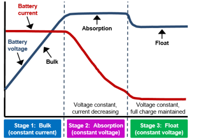

A charger is simple. A 2 or 3 stage charger does the following:
1. It charges at its max Amp level, (or the one you chose so it doesent melt the chairs loom or connecting plug) and the battery voltage is gradually lifted at this CC (Constant Current) stage. This is known as BULK by ignorant people. It does this until the voltage reaches the voltage you have choosen. In the case of the MK gel that is a MAX of 14.1V (28.2V for a pair in series). The battery is about 80% charged.
2. As soon as this voltage is reached, a good charger then HOLDS IT SOLID at this 28.20V level (for your MK gel battery). This is the CV stage. This is Constant Voltage. Also called absorption by dummies. During this time, the battery is gradually pulling less and less amps quite naturally. The Amps will drop from the CC maximum Amp stage, over time, usually 8 hours approx, down to a very low level. When it reaches 8 hours of CV or when this current drops to approx 70 to 140mA, whichever occurs first, the battery is 99% charged. At this point the battery is ALMOST fully charged. Now the battery enters FLOAT.
3.The 3rd stage is another constant voltage stage. But at a lower voltage. It completes the charge over another 8 to 20 hours. Depending on battery type/condition etc. This is typically 13.8V (x2 for 2 batteries in series). Most use 13.5 to 13.6V instead because than it can be left indefinitely connected.
4. But on the victron charger I linked to, theres also a long term storage FLOAT level. An even lower voltage that can be left connected indefinitely. This is around 13.4V per battery. So 26.8V on your MK gel. It keeps te battery from discharging, and doesent charge it. Just keeps it at 100%.
So a 3 stage charge looks like this:

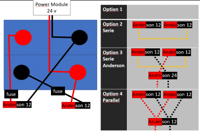

Before I begin, I would like to thank everyone for the quality information that is extracted after reading the forum.
I have a Sango advanced chair, and after a year of use, the batteries have started to give problems. Surely, I will have to change them shortly and I have in mind a MK 74….
As the access to the batteries is a bit tricky, I would like to wire the chair to be able to mess with the batteries, both together and separately, using Anderson connectors and taking advantage of its advantage of being able to charge with more than 12A
I had thought of wiring the batteries like this schematic:
With such wiring you could:
1.- Charge/Measure the batteries through the XLR connector
2.- Charge/Measure the batteries using an Anderson connector (28.2V)
3.- Charge/Measure each battery using two Anderson connectors at (14,2)
Is this wiring correct?

Postby Burgerman » 30 Apr 2023, 15:40
Better... https://www.wheelchairdriver.com/faster ... arging.htm
Very old page. This is similar to what you want to do?
Its better than what you show because it allows you to charge both 12V batteries in parallel at 12V and double the current. This makes sure you can use in a vehicle and allow it to charge. Or you can conect a 12V load such as inverter to power something, or to say start a vehicle easily. E.G. # http://www.wheelchairdriver.com/gopro/starter.mp4
This means that you can also charge fast via any vehicle if you need a boost at the side of the road at around 50A or so. Both batteries at the same time from a 12V source.

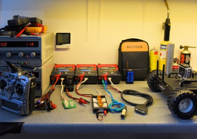

It allows me to charge at 12V in parallel, best way! I use a 50A ZXD charger which is user programable to correctly charge gel or any other battery at 12, 24, or anything you choose. I use the ZXD alone, or in combination wih the PL8 in the event I want to graph, or discharge/test etc. OR as I drive via my vans alternator.
And at 24V series. Again, I use the ZXD alone, at 25A or in combination wih the PL8 in the event I want to graph, or discharge/test etc.
And at up to 12A via XLR connector. With a normal chair charger, or the same ZXD and hobby chargers etc.
As for the victron chargers, they are OK as far as I can see, but I dont have one and so cannot say which one etc.
___________________
Heres an example fitted to another chair I had. You can see here the loop that allows it to be series connected and drive normally. When that loop is unplugged, the chair sees zero volts. And so can be stored a long time without the electronics gradually draining the battery. And nobody can drive it unauthorised either. It allows a series connection at 24V. Or a parallel connection at 12V. With anything up to 100A plus.

Postby jfgutierrez » 30 Apr 2023, 20:11
Thanks Burgerman. I think I understand, but I'd rather ask and make sure than be wrong. As you tell me, I have to connect the batteries according to the attached diagram and I should make 3 sets of cables that present four possibilities that I can use as they suit me.
Option 1. Without cables. does not close the circuit
The chair does not turn on and does not charge because it does not close the circuit.
You could use the Anderson connectors to handle each battery separately.
It is useful for storing batteries for a long time without being depleted by electronics
Option 2. Close circuit with batteries in series (24v). The chair behaves as from the factory.
The chair turns on and moves while not charging via XLR
Charges to 24 via XLR and stays put as long as you have the XLR jack plugged in.
There is no Anderson advantage.
Option 3. Closes the circuit and adds the possibility of charging the chair at 24V through Anderson.
Add to option 2 the possibility of charging through the Anderson connector at 24V and up to 30 Amp. But, is it dangerous if the chair is accidentally turned on while charging through Anderson? Does the chair move with the Anderson connector charging?
Option 4. Batteries connected in parallel (12v). It does not close circuit.
The chair does NOT turn on or charge through the XLR connector.
The chair charges through the 12V Anderson connector and a 12V charger or directly from the car.
I imagine that it will be possible to get a connection from the lighter connector although it is limited to 15 AMP and that the charge will be safe on a long trip since the alternator is used to constantly charging the battery.
And now to finish.
- And in the case of wanting to put a usb outlet? Would the installation be too complicated?
- What is the charger you use?
- Out of curiosity, you comment in other posts about the possibility of connecting devices using an inverter, but can you move and use the inverter at the same time?
thank in advance
When using a external charger you can use any 24V charger, and yes if you are daft enough you can drive off and drag the charger along with you...
The only thing that stops that is the XLR charger plug, has a link wire inside that connects the 3rd inhibit pin to the negative. So I hang the normal connecting loop over the joystick to remind me never to do that! And it prevents it going missing too.
Theres no 30A limit. I use odyssey batteries normally as they charge faster and give better high current performance. These can be charged at 100A if you want. MK 74Ah ones are in theory best charged at 25A approx. It gives longer for the CV stage so that they get a more complete charge overnight.
What chargers do I use?
Van... (14.0 to 14.3V) as I drive.
SM 3040 Bench power supply. Set to 40A (Max) and to gel 14.1 (28.2V or AGM 14.6V (29.2V) depending on battery Type. This may be for an hour as I eat before going out or whatever. Regular boosts (opportunistic charging) makes batteres last 5x longer at least! Still needs overnight too.
Also use the Telecom rated ZXD bench power supply at the same settings but 50A when I charge in parallel.
I use both of these supplies to power the PL8 charger for detailed PC controlled charging with graphs etc.
Such as these:
TWO 40A bench power supplies... Used with no charger.
THREE PC Controlled PL8 chargers... Powered by the same power supplies when needed.
Then theres the ZXD which is a 0 to 50A and 0 to 60V power supply. Thats enough. But it also has 3 stage charging, so you can set a 0.2A CV stege cut off and then alow it to float at the lower 13.5V or 27.0V.
And again I use these to drive the PL8 when needed. As these charge my lithium chairs and allow me to properly test lead batteries too.
3000 Watts power or a watch battery, lead, lithium or anything else!
ZXD and PL8...
PL8 graphs etc.
Charging a gel battery Volts!
Current in amps... Gel.

A couple of minor comments -
It is critical for battery life that the two batteries stay charged to as close to exactly the same level on each battery as possible... If they become unbalanced, when charging at 24V you will end up undercharging one and over charging the other, and this will rapidly kill both....
Therefore:
You ONLY want to charge the batteries at 12V when they are in PARALLEL. DO NOT attempt to charge them individually, as this will cause them to become unbalanced.
NEVER connect any sort of 12V load across just one of the batteries. If you need 12V use a 24-12V DC-DC converter across both to step the voltage down...
BM use SB-50 Andersons on his chairs, which works fine, but seems a bit bulky to me. I use the Anderson PowerPole PP-75 connectors instead. The PP-75's use the same pins as the SB-50's, but are individual shells rather than the paired shells like the SB-50. The shells have dovetails molded into them that allows assembling the 4 into a single block which is more compact and only takes one step to connect instead of two (but does take more effort) Electrically the two methods are identical, it is just a personal preference thing.
As an extra bonus, I added an extra short pair of wires to a PP-15/30/45 connector pair from the otherwise empty 24V terminals on the series jumper plug which allows me to plug in my cordless drill and other 24V stuff while still being mobile.

MOST batteries will fall to around 0.2 to 0.3A or less inside 8 hours at CV. So if it takes 3 hours at CC and 8 hours CV so 11 hours total then thats typical on a deep cycle. If it doesent, lower voltage. If it still doesent then increase the termination current. Eventually you will get it right.
DOES THE ZXD PERFORM A AUTOMATIC CHANGE TO FLOAT?
Yes! IF YOU SET IT TO 3 STAGE.
You set:
CHARGE CURRENT. Say 12A.
CHARGE VOLTAGE (CV Voltage) to 14.4 AGM or 14.1GEL.
You set the TERMINATION CURRENT or whatever it calls it, to 0.3A or whatever gives a 6 to 8 hour CV length in tests.
You set the FLOAT voltage to say 13.6 (27.2V).
Then you test it.
