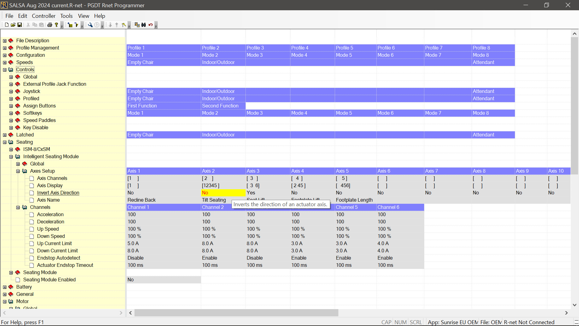

I recently picked up a second-hand Quickie S-636 with R-Net and a CJSM1 joystick. I have no experience with this platform as all of my other chairs have used Qtronix stuff. Anyway, as it sits now, when adjusting tilt, you have to push forward on the joystick to tilt the chair back, and pull back on the stick to lower it back down. Can this be flipped in programming? I want to pull back on the stick to tilt back and push forward to lower. I poked around some in the OBM but didn't see anything to change this.

OBP is basic. At best.
You probably need a dongle and OEM software to set this. I cant check this right OBP nonsense right now. But its definitely reversable in software.
See below, I just changed it from YES to NO on that TILT channel. So it is displayed in yellow until sent to the chair. Super easy.

I have to reverse the Y axis forthe lift and I don't have all the option like your screenshot.

Yes its relatively easy to do this.
I will PM you the software and a quick lesson! Check PM in 10 mins...
