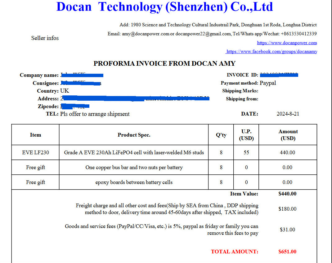

Hello John
Thanks for your fast reply, please check the quote:
Grade A EVE 230Ah LiFePO4 cell with laser welded M6 studs Unit Price: US$55/each*8pcs=US$440
DDP sea shipping cost: US$180
Subtotal: US$620
Payment Options:Goods and service fees (PayPal/CC/Visa, etc.) is 5%, Alternatively, bank transfer with a bank fee of approximately $48-$100 per payment
Details:
*Free Gifts:One copper bus bar and two nuts per battery & epoxy boards between battery cells
*DDP International Sea Shipping: All-inclusive fees. No VAT, duty, or taxes.
Reliable 50-70 days delivery via DDP sea shipping. Local delivery to your door with truck, DPD, FedEx, or UPS.

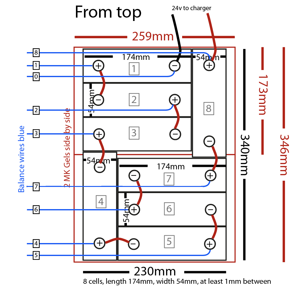

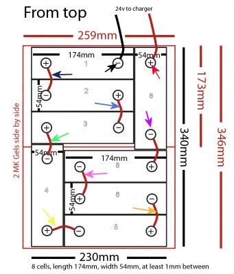

If you want cells that are 50mm or 53mm thick, then order sometime soon. The 230Ah ones are being replaced everywhere by 280 or 308Ah. Those are 70mm thick and wont fit...
Right now docan is the best deal and probably the best supplier. So grab em while price is reduced and still available.
Then they will JUST fit if you use this layout:

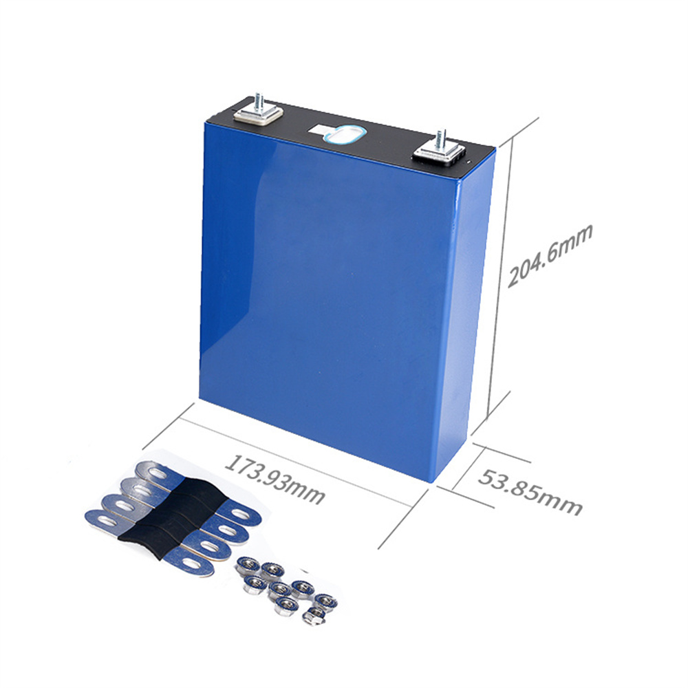

Postby foghornleghorn » 22 Aug 2024, 13:10
What is the overall height including the welded on posts?
Posts: 710
Re: As of today ordered 230Ah qualiy A grade cells compariso
Postby shirley_hkg » 22 Aug 2024, 14:45
220mm
Postby Burgerman » 22 Aug 2024, 17:23
A bit less once I chop off 6mm or more from each one with my dremel... 214mm or less. If required.
You only need enough for a ring terminal, a balance wire terminal, and a thin washer + thin nut. = about 9mm total.
To shorten a terminal NEATLY and accurately add 2 ring terminals, a thin washer, and an ADDITIONAL washer as spacer, and nut. Cut off with dremel flush with nut and grind nice and flat. UNSCREW nut, and gently debur the edge of the thread with a debur tool. Then you will have just 1mm of extra thread unused.
Tech full spec PDF here:
https://www.docanpower.com/index.php?ro ... load_id=15

Postby slomobile » 26 Aug 2024, 14:03
5% credit card fee or $48-100 bank transfer fee.
$77/cell for 230Ah US stock. Plus shipping.
slomobile

Postby Burgerman » 26 Aug 2024, 16:21
Paypal here. No 5% fee if you send as freinds and family. Your risk.

Postby ex-Gooserider » 27 Aug 2024, 00:18
Burgerman wrote:If you want cells that are 50mm or 53mm thick, then order sometime soon. The 230Ah ones are being replaced everywhere by 280 or 308Ah. Those are 70mm thick and wont fit...
You might want to edit the drawing - you have TWO cell 8's and no Cell 7....
Postby Burgerman » 27 Aug 2024, 00:41
Yes... But that makes it interesting.
:oops:
Posts: 71089
Postby jefferso » 27 Aug 2024, 01:43
Here's another version of the drawing renumbered and with numbered balance wires drawn in.
jefferso
Posts: 344
Joined: 18 Jun 2016, 22:18
Postby Burgerman » 27 Aug 2024, 02:19
Good!
What software do you use?
Posts: 71089
Postby jefferso » 27 Aug 2024, 11:37
Burgerman wrote:Good!
Adobe Illustrator for that one. I set it to use pixels for measurement, then have each pixel scale to 1mm so things should be fairly to scale. That png export is zoomed in a bit so no longer 1px=1mm but the sizes should have the right relationship to each other.
jefferso
Posts: 344
Postby Burgerman » 27 Aug 2024, 12:07
I have the latest illustrator 2024 and all the rest. Never used it though. Will give it a try. Do you need the latest version, up to date as of a few days ago?
Posts: 71089
Postby jefferso » 27 Aug 2024, 13:29
Mine is from 2019, seems to be working ok. And it's on the Mac OS, which I'm guessing is not the version you have…
I'm not sure if it will work, but I've attached the .ai file as a zip. It has some extra stuff on the side but the main part might be useful.
battery mk gel lifepo4 permobil f5 connects.ai.zip
(728.34 KiB) Downloaded 153 times
