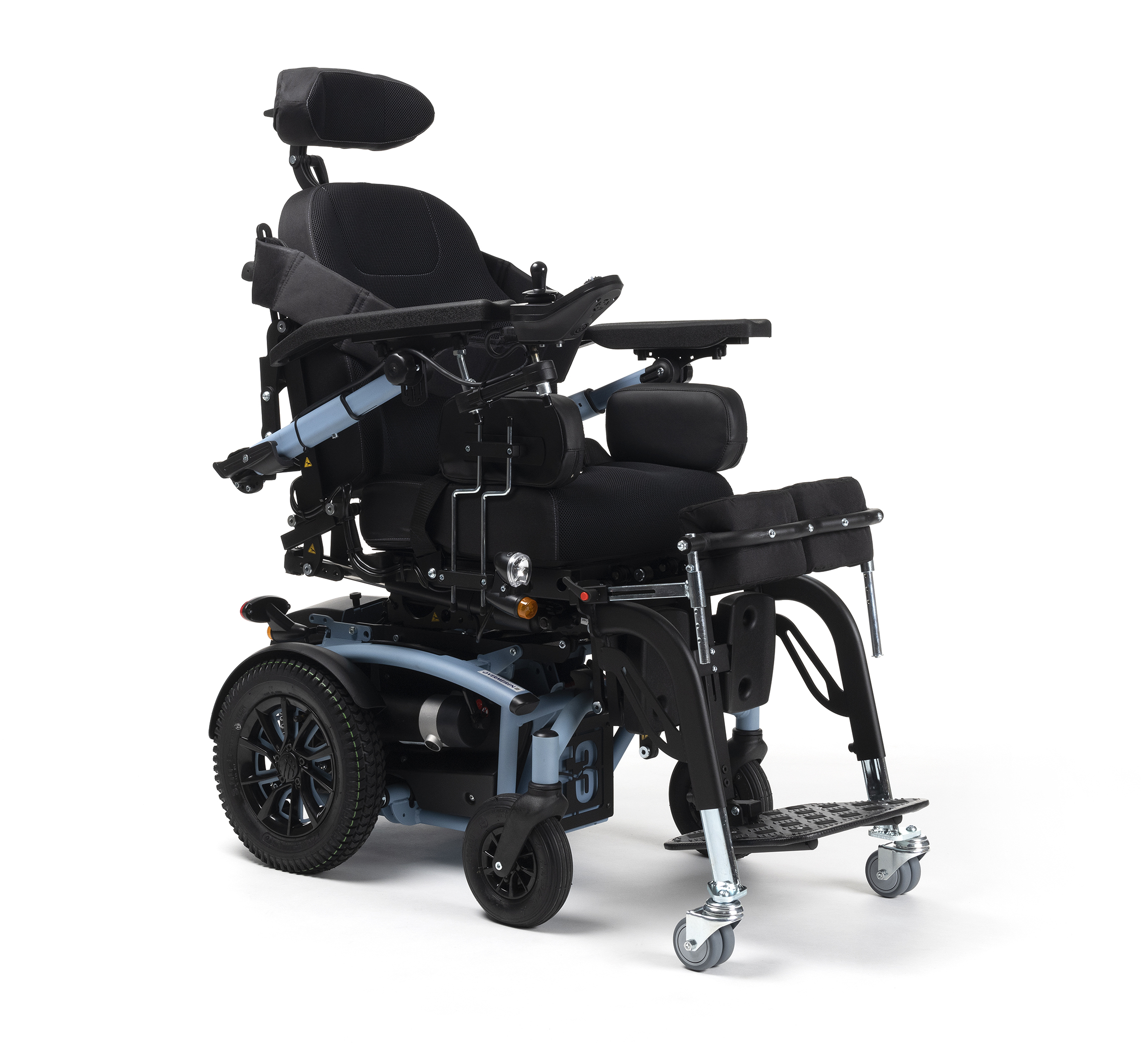

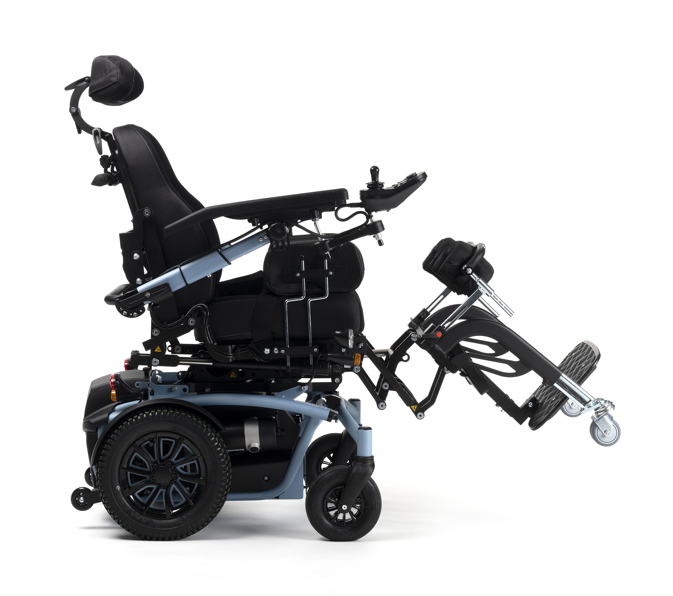

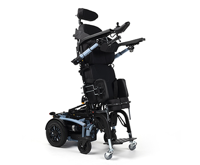

Because the idea of a rear drive chassis with a stander at the front is flawed. All the user mass would be on the small casters. In front of them in fact making the situation worse. I means some other way of taking all the weight must be found, like the extra wheels on this at the footplate.
It causes some inwanted consequenes. If you must have a stander best to use front drive chassis. Or at least mid drive. But however its done it is a compromise if you want a daily chair that also stands.
