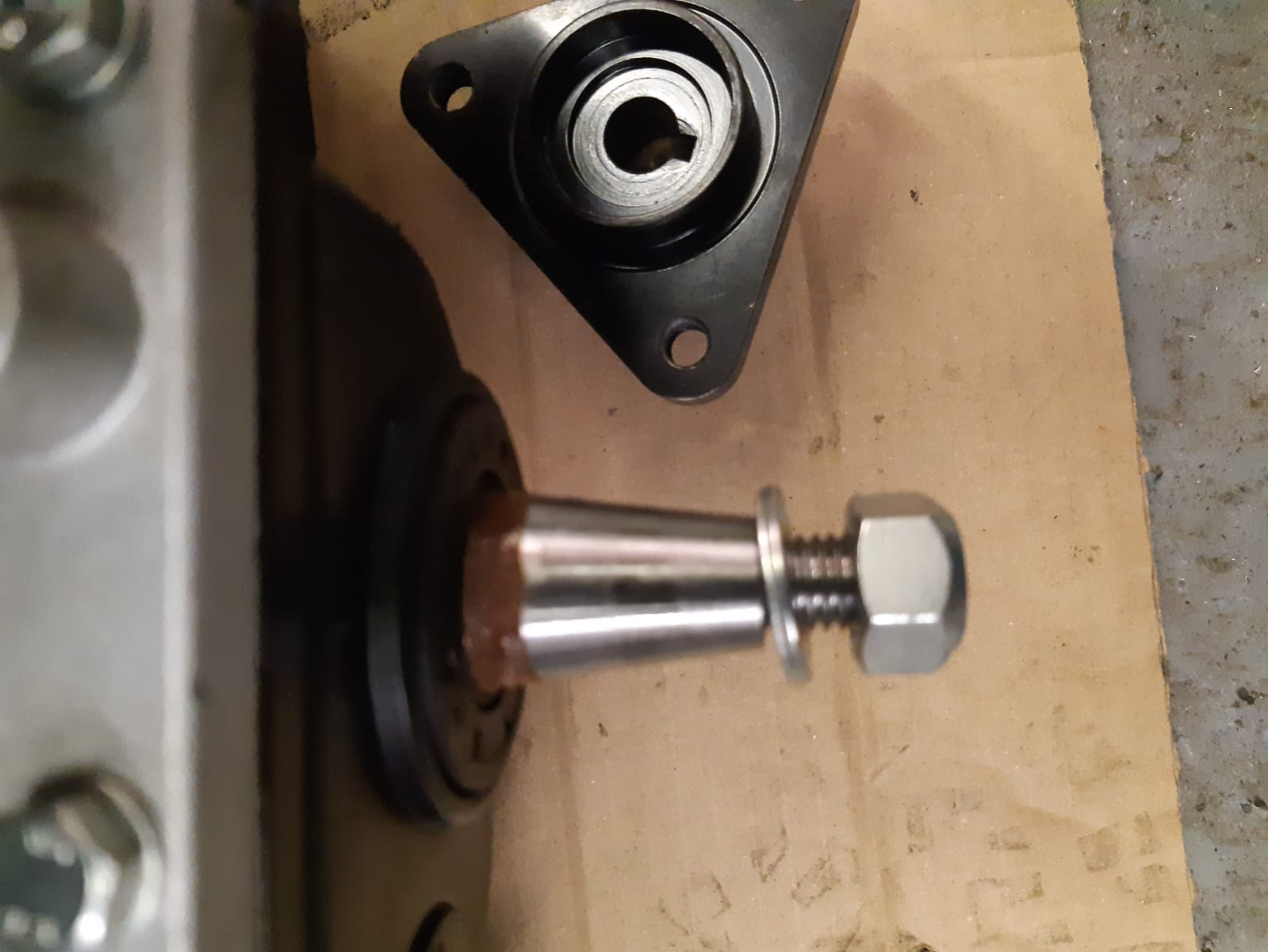

Postby wheelchairer » 14 Dec 2024, 16:38
Can anybody tell me what I need to search For on eBay to find some appropriate rear wheels that take a 3.00-8 tyre and will mount on this flange with 3 fixing bolt holes, please?

Its either a wheel from a sunrise Qxxx chair or from a Sunrise Jive, both have a different PCD, MY GUESS IS JIVE...
And I think the salsa 4 bolt hub fits too... And the 3 bolt ones are interchangable.
Jive bigger PCD
https://www.ebay.co.uk/itm/286178080407
Qchairs various Q300, Q500, Q700 ETC. and smaller PCD
https://www.ebay.co.uk/itm/166534712672

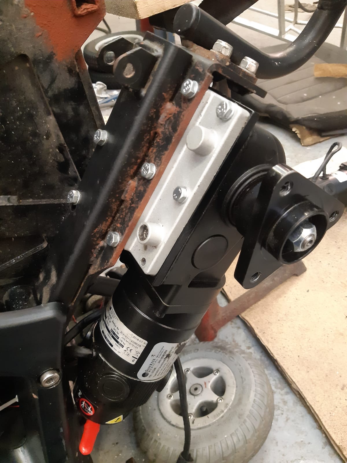

What is the chair?
Hopefully that motor isnt held on by the 3 6mm bolts I see :shock:

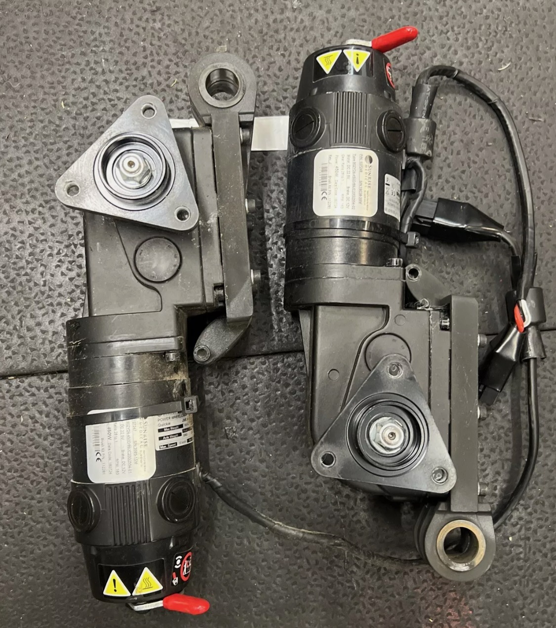

Postby wheelchairer » 14 Dec 2024, 17:40
https://www.ebay.co.uk/itm/167005193795
There are 5 new bolts in the picture. Had to modify the motors to fit to the mounting points.

Postby Burgerman » 14 Dec 2024, 17:47
What chair?
You want jive rims.
Important. Programming set 45mOhm compensation as they are 6mph ones. And equally importaant be sure to set correct brake voltage! Or big £££ issues ahead!

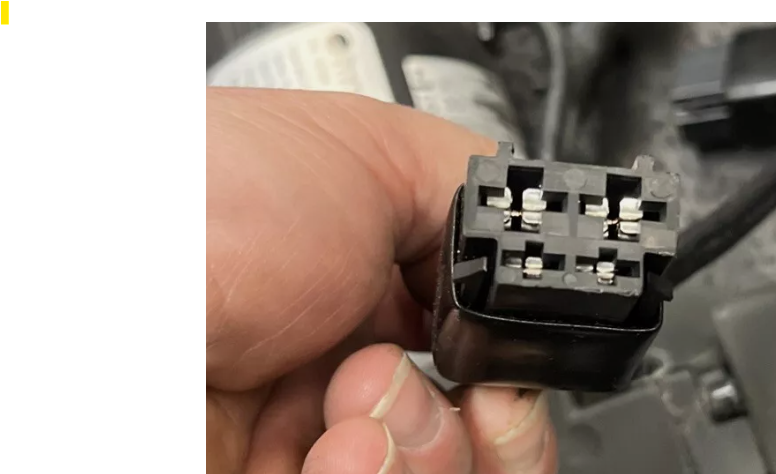

Postby wheelchairer » 23 Dec 2024, 22:08
they do say dynamic system only, will I be able to modify the cable for r-net, And use them?

Postby Burgerman » 23 Dec 2024, 22:44
Well if wrong, you can make an adapter or swap the cable ends.

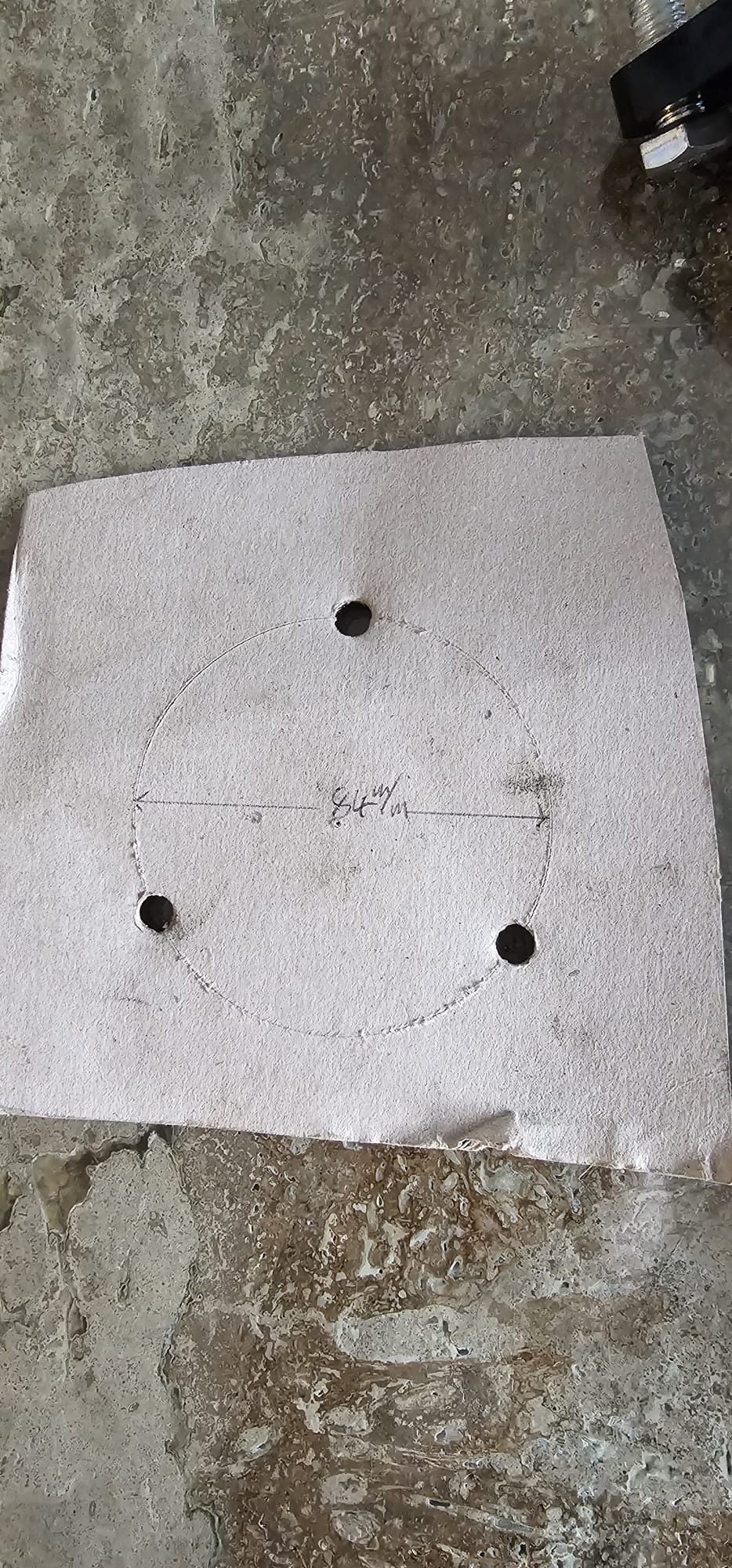

Postby Burgerman » 03 Jan 2025, 17:40
If the motors ARE actually Jive and the rims are actually jive then they do fit.
The Q chairs. have a smaller bolt circle so the bolts are closer together.
So is it the jive rims that were listed incorrectly or the motors? I suspect the 3 spoke wheels you have are really from a q700. Not Jive. And the guy selling is an idiot. They LOOK similar, they are not.
I would not expect the rims in the 3rd link to fit, smaller bolt circle.
The jive wheels in the photograph ARE jive wheels. The removable section is at the back. On a Q chair wheel its on the front. So what did they actually send?

Postby wheelchairer » 05 Jan 2025, 20:28

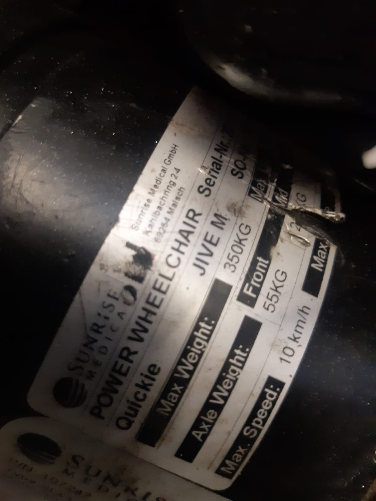

It takes me a while because I have to wait to about For the man at the garage who has my wheelchair and the moment.
The garage mechanic said that the ones in the 3rd link were smaller again than the ones in the 2nd link, but still not small Enough. The diameter of the circle that Links to 3 bolts is 84 mm diameter. So I'm even more mystified As to what to look for.
So this is a cardboard template of the 3 bolts that make up the wheelchair wheel hub.
It is a picture of the hub of the motor.

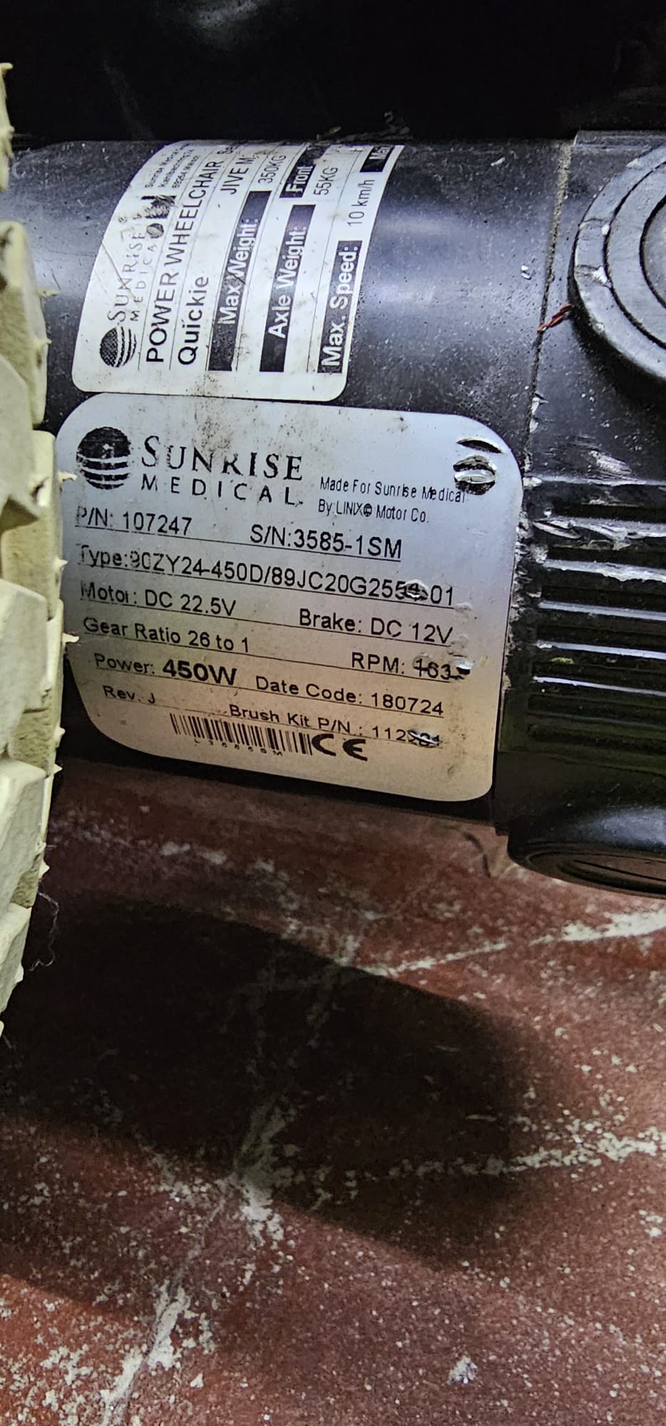

Postby wheelchairer » 05 Jan 2025, 20:47

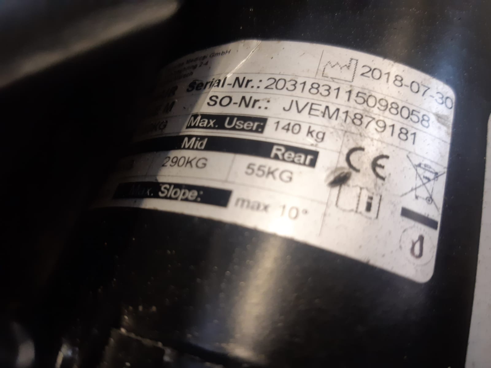

Just spotted these from the mechanic.

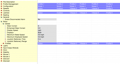

Postby Burgerman » 14 Jan 2025, 14:09

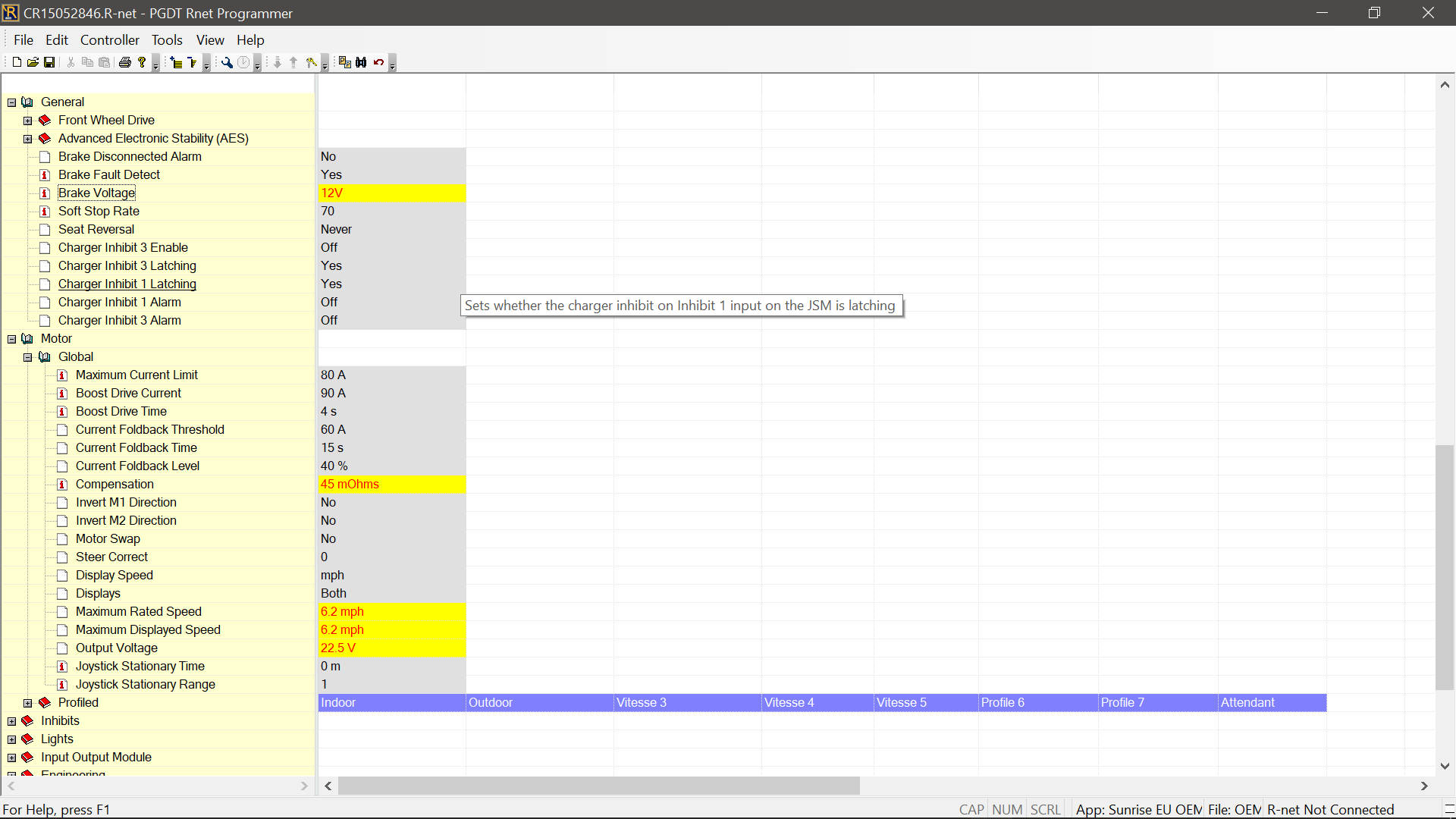

The seller is probably an idiot. Never personally saw a dynamic system used on one of these. But they WERE available. As a special built4me option. Jive 6mph I think?
Read brake voltage off motor label. 12 or 24. If they came from a sunrise chair they will almost definitely (probably!) be 12V brake.
Set that in programming. Be sure that it fully releases. Loud click, motor can freely turn.
Set 12V
Set 45mOhm in motor load compensation. Save to chair.
Set yellow fields as below:

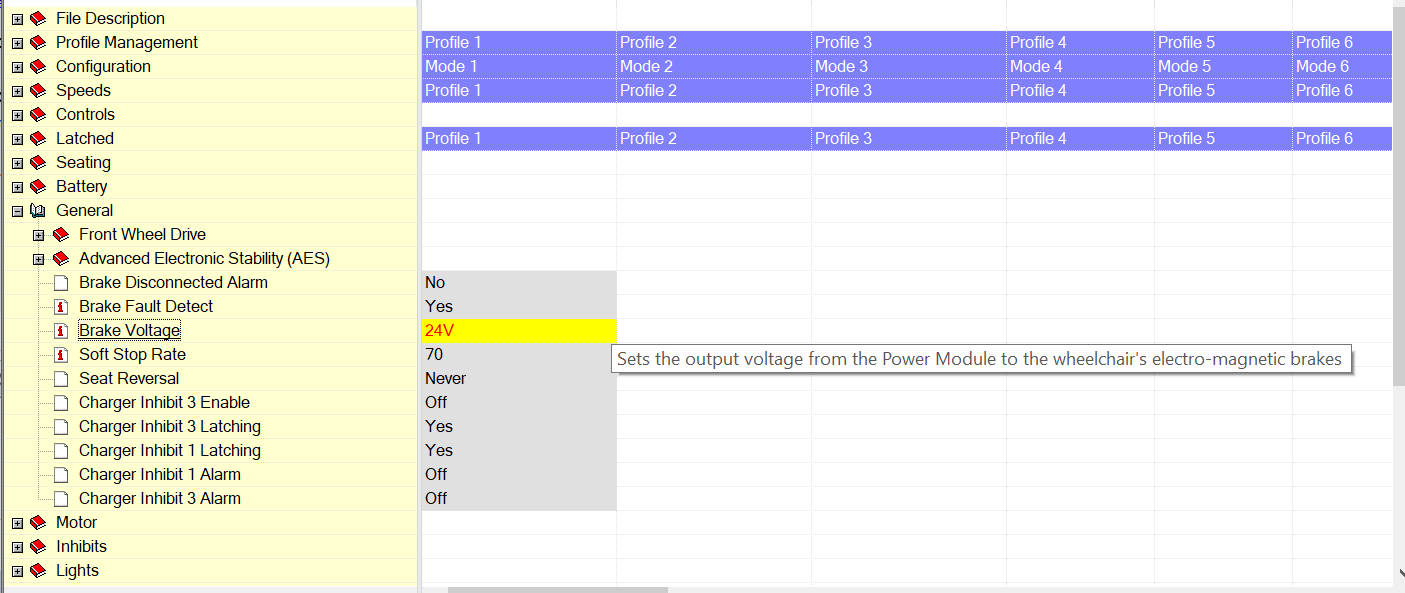

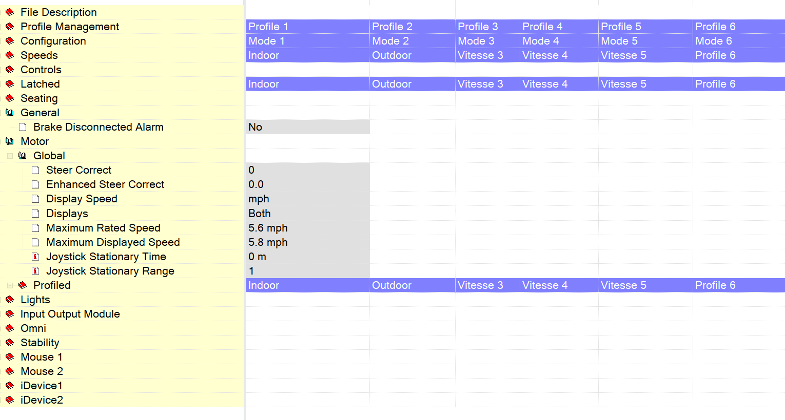

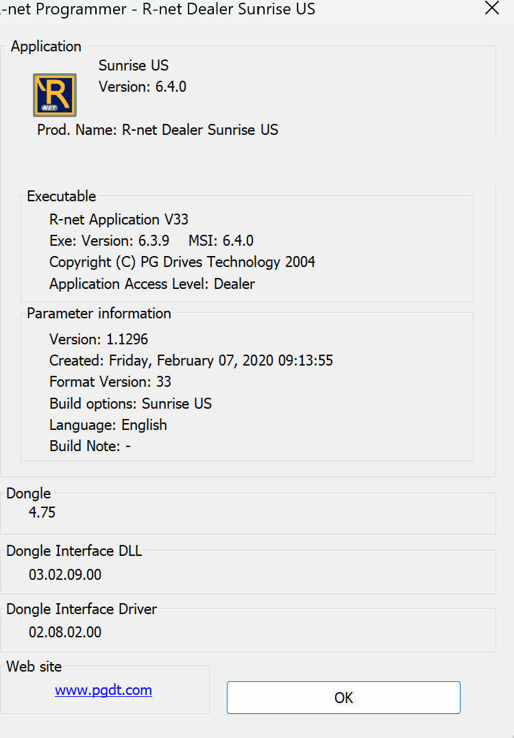

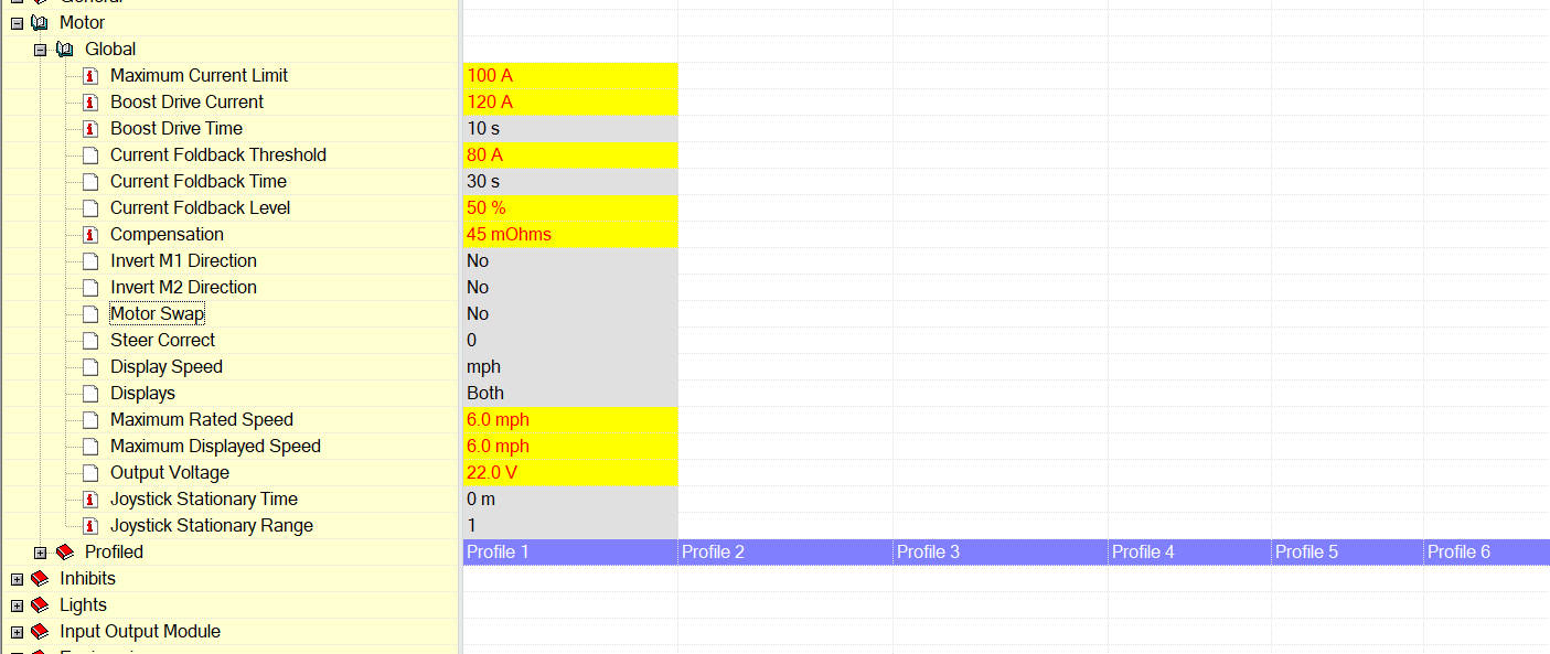

Postby wheelchairer » 17 Jan 2025, 15:48
Yes you are right, they are 12 V.
I've attached my r-.net system file, because as you can see from my picture it doesn't have the same options as you. Is there anything I can do?
This is the sunrise dealer software

Postby Burgerman » 17 Jan 2025, 18:36
Because you are using a dealer version which really means "very limited version" with all the important tech stuff removed (to save you from yourself)...
PM me, the things you need to change are visible to me...
Your power module is the 90Ah (80A really with a couple of secs boost to 90) rather than the 120A version. Should still work OK.
Your MOTOR load compensation is set to a too high 60mOhm so the chair will be very "snatchy" and unpleasant...
You voltage is set to 24V and so wll soon burn the brake coil and $£££$$ hanged , set this to 12V brake.
I changed the things on YOUR file that you need to change as shown below in yellow!

Postby Burgerman » 17 Jan 2025, 18:39
Here is the changed safe file for you new motors.
It is possible it may turn the wrong way or forwards and back be reversed etc but thats easy to change. Theres no convention for motor wire polarity.
Seriously I am surprised you can hit a doorway with those turn settings.
But I left them alone.
12V BRAKE 6.2MPH 45MOHMS COMPENSATION.R-net

Postby Burgerman » 18 Jan 2025, 14:02
I added a profile that allows the thing to steer properly at every speed. TEST it dont change anything!
I also changed the following items in yellow, below. And added a 10% compensation increase and a 10% torqe reduction to the new 3rd profile only.
12V BRAKE 6.2MPH 45MOHMS COMPENSATION ADDED PROFILE.R-net
test this before making any changes!!!

Postby wheelchairer » 26 Jan 2025, 22:21
Yes I did have to reverse the joystick to, like with the directions of the motors. And I still need to change the direction of the seating and standing control in mode. But the main problem is it's only doing 3 mph on profile two,1.5 on profile 1, and something similar on profile 3. I only use 2 profiles when I set it up myself, indoor and outdoor.
So will you have a look on the settings you sent to me, and see if you can help with this speed issue Please John.
Steaing wise yes it feels very good. It's a bit hard to judge because I can feel there is more weight on the front casters(Making them fit has took the rare of the frame a tiny bit higher), so I've had to pump them up to the maximum 35 LBs.
C4/5 tetra
wheelchairer
Posts: 478
Joined: 29 Mar 2021, 18:34
Re: EBay search name rearwheel 3 holes 3.00-8
Postby Burgerman » 26 Jan 2025, 22:37
WHAT EXACTLY did you do? Theres several things and ways to do that incorrectly!
You must not reverse joystick. Only MOTORS.
Has it changed?
Now I am confused.
Is this one that you have "reversed" the joystick and not reversed the motors? If so then it will go very slow!
If not then I dont know what you are doing...
You only need ONE profile. With 5 speeds. And everything set correctly for the slowest speed, and the highest speed.
If theres more than 1/4 to 1/3rd the chairs weight on the casters it will never work propely.
Right REINSTALL this. Change NOTHING at all.
Try moving forwards, TELL ME EXACTLY what it does.
Then try a TURN IN PLACE move joystick right. Tell me EXACTLY what it does.
Dont fix it. I will fix it PROPERLY and repost it here.
(4.33 KiB) Downloaded 79 times
