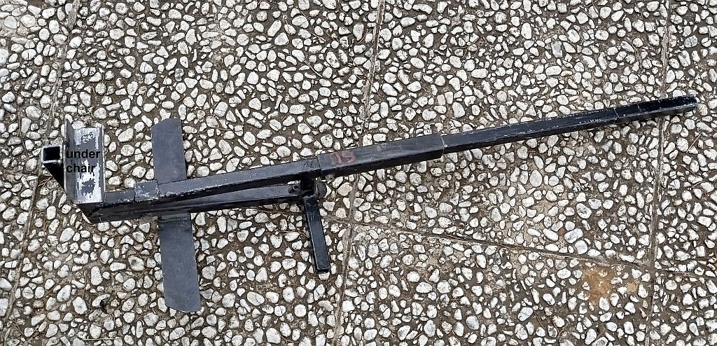

Here's a photo of a jack I made from some scrap steel. The part that says "under chair" is placed under structure near the drive wheels and the long arm is pushed down so that it goes over center and the chair is raised.

LROBBINS wrote:Here's a photo of a jack I made from some scrap steel. The part that says "under chair" is placed under structure near the drive wheels and the long arm is pushed down so that it goes over center and the chair is raised.
this invention cannot lock in place right? it is just to lift but does not stay in the air correct?

Re: OMG!how prevent dog leash to stuck in the axle and solut
Postby Burgerman » 03 Jan 2025, 01:09
Yes it stays i the air. Its an over centre device.

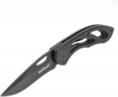

I have a bag on my knee. Serves 2 purposes. Keeps my knees together. And keys, cash, verious medications, cards, extending magnetsm phone, etc. And an extremely useful knife!
These are on eBay or Amazon for 10 uk pounds and are very well made. In the UK we have knife laws too. This is not technically legal for normal people to carry. Since the blade locks open. That is unless you have a legitimate purpose for doing so. Well we do. I have been trapped in electrical wires, hoses, and all sorts of things over the last 27 years. This could be life threatening if you happen to be in a place where other people dont frequently go. So we have a valid argument to carry one legaly for the job of freeing yourself exactly as this thread describes.
I see it like this. Would you rather die from pressure sores or exposure or freeze to death. Or explain your circumstances to the judge...
https://www.amazon.co.uk/dp/B07CT2W5Q2
So I have one of these in that bag on my knee:
Not sure how you can lift with that and leave it up in the air. Anyway i cannot solder nor cut metal but it is a nice piece of tool
