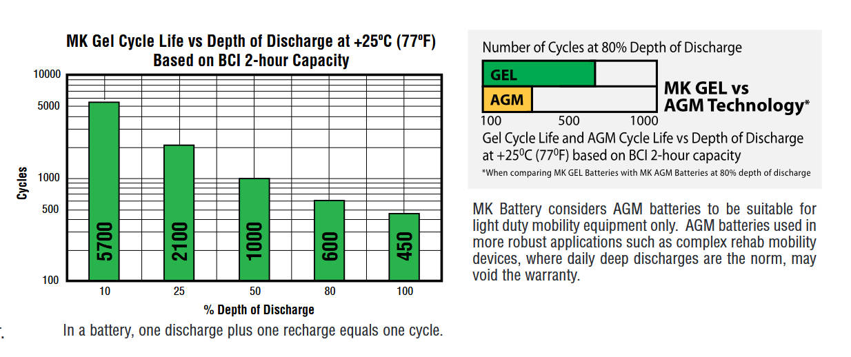

MK gel versus MK AGM mobility batteries.
This is why GEL batteries are a bit more expensive. And a lot longer lasting!

And the lithium 230Ah cells I have are 4000 cycles even if discharged 100%.
And 8000 cycles at 80% depth.
And that only happens if you go 80 miles per day! Which is pretty much impossible. cheers
Even if you did 40 miles every day, thats 10k (or much more) cycles... Or 30+ years.
Thats a simply huge difference.
