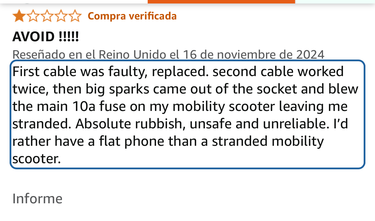

That kind of chargers were my first option but I read they can be dangerous. I found this comment on Amazon: https://amzn.eu/d/j0vde8x
