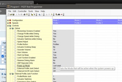

I have manufacturer level dongle and all the r net software and programming knowledge. What settings do I need to change to make the chair when powered down and power it up again to start back up in the last seating setting e.g. stand as it’s sit to stand chair if that was a last used setting grave and reverting back to lift which it does currently..

If this doesent do that which you probably tried already I honestly dont know. I would need to experiment, maybe reorder channels or something.
