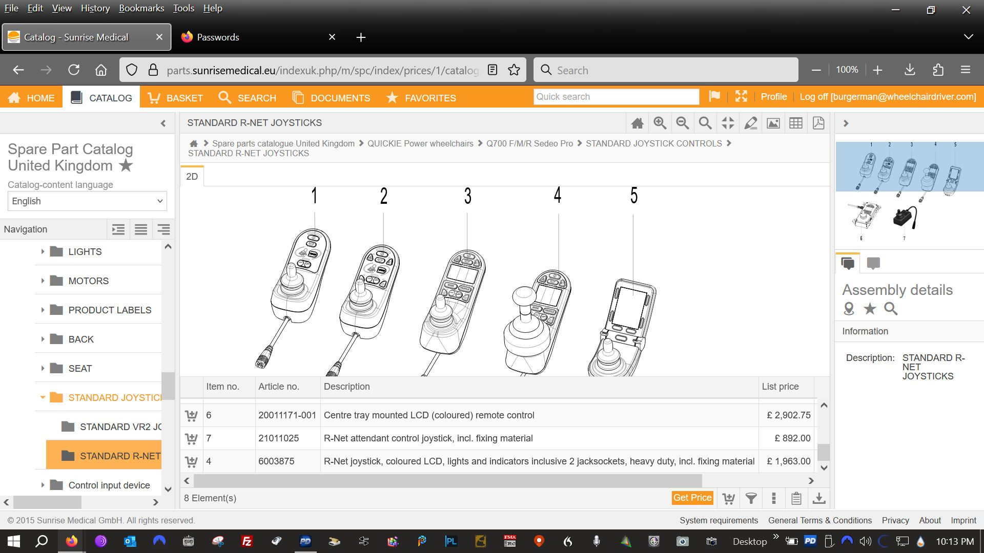

Postby Burgerman » 14 Aug 2025, 22:18
The joystick that is fitted to 4 on this screenshot can be bought seperately I think.
And swapped in to an existing pod.

Postby Burgerman » 15 Aug 2025, 10:18
I think that the HD one used in the no 4 joystick will replace the JC2000 one directly. It would be great for your purposes.
Not 100% sure abou the fit. Maybe PG will tell you. Explain the situation.
