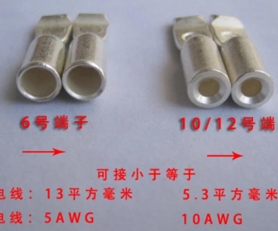

As for crimping thise weedy thin plated soft copper ring terminals well I just do not think thats good! Dip one in some road salt for half an hour and leave it outside for a year. Then use an impedance meter across the joint. It will be terrible.
And the thin copper is so soft that no matter what you crimp it with you could pull it off the end. Especially if you wiggle it side to side as the strands walk... Not enouh strength in those terminals.
If you really cant be bothered to solder, then use much heavier crimps.
Heres an example. The 2 on the left are too flimsy to crimp alone. The one of the right is heavy walled, that can be crimped permanantly! But hydralic crimpers and dies needed.
Posts: 71098

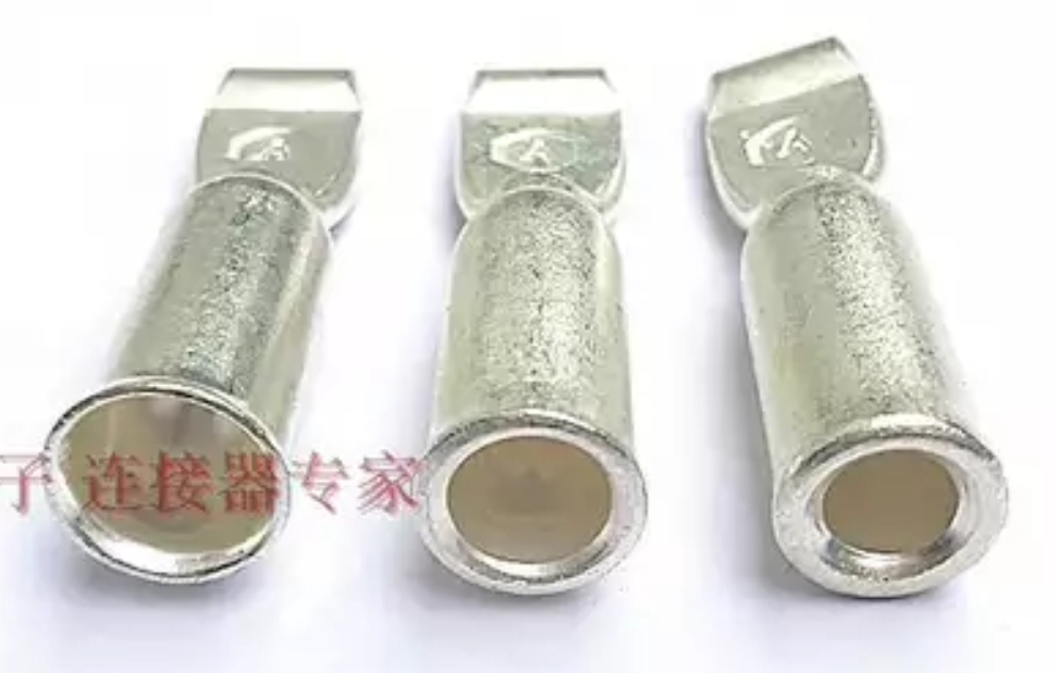

Re: Cable size crimp size for prismatic cell links?
Postby Burgerman » 20 Aug 2025, 12:45
Heres some that are heavy enough to solder, and some that are just weak...
See the wall thickness differences. The ones that are just made from flattened copper tube are great if SOLDERED. But far too weak if only crimped.
The cast ones with thicker walls CAN be safely and pernanantly crimped with the right tools.
If you can find any...
TWO on the left? WEAK! TWO on the right, safe to crimp!
Left? WEAK... Middle? Borderline. Right? Safe to crimp alone!
Bare copper, thin weak terminals like this cannot safely be crimped alone. Worse they will generate a few mV across anything not copper you bolt them too and screw up cell balance readings.
Weak thin ones like this made from soft copper tube are FINE if SOLDERED!
Posts: 71098
