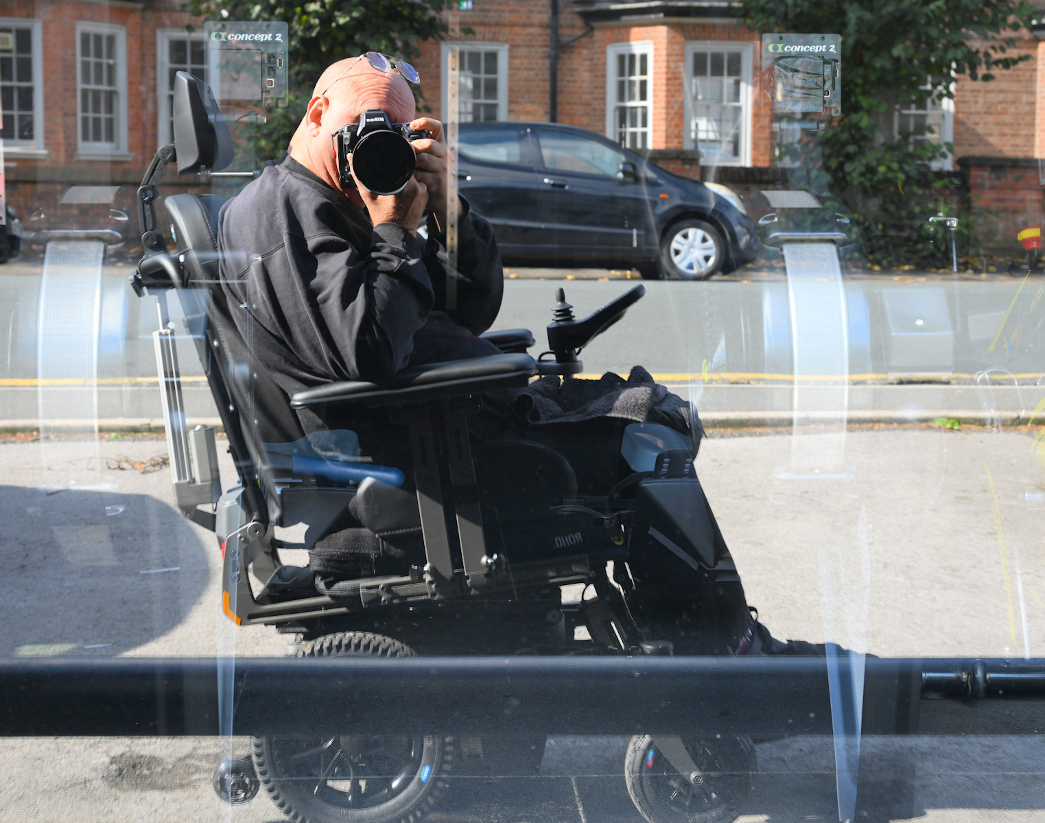

When you spent half your week at work (emap publications, perf bikes, mcn etc group testing bikes and dyno testing etc at bruntingthorpe, the weekends drag racincg them with 4 or 500 horsepower it IS 2nd nature. You really dont think about it. The only difference between front wheel off the deck by an inch or a foot is the throttle, regardless of which of the first 4 years you are in. Its the thing that stops you opening the throttle more or flipping it. So it really does just become a part of controlling the bike as you accelerate. If the front comes up an inch, thats fast. 6 inches, thats too slow as you have to keep closing the throttle or up it comes. But when you close the throttle you lose boost and the nitrous and it goes rich, bogs down so you try not to... You soon learn how to hover it 1 to 2 inches max to get the fastest times.
As for less traction in reverse in a chair that is also true. On Rear Drive. Think about where the CG position is. Imagine a point where your belly button is. Draw a line down. On level ground on a correctly configured chair, this should be around 2/3rds to 3/4 towards the rear drive wheels. So they have most of the weight.
As you face down a slope the centre of gravity or more accurately centre of mass (draw a line down vertically) is now more over the front casters. And theres little mass on the rear drive wheels. As you accelerate in reverse up that slope the CG pushes the front casters down, and lifts the rear drive wheels. Making it ever worse. The exact opposite to a wheelie. The weight tranfresr in the wrong direction.
The real problem in a chair is that almost every rear drive one has seperate swing away foot riggings. These MUST give clearance between your heels and a fully 360 degrees caster fork. So your feet are ahead of the caser wheels. If you have a hacksaw, a hammer, and some mind over metal, you fit a centre mount footrest. This allows you to move the seat back as your heels now fit in between the caster wheels at least to a degree. Now the chairs isnt rediculously nose heavy, steers better, is shorter, and you do not lose traction so easily in reverse. It o longer feels like an oil tanker.
My rear biased chairs are all this way. Heres the Dietz one... With seat moved back, and that tilt angle is fully lowered too so that it is rigid and not weak as I drive and not "wobbly"... Almost all the weight is on the drive wheels. Its tips back going UP a ramp! The high anti tip wheels dont save it!
So you hit ramps or anything likely to make it tip, flat out and decelerate up them to keep the front down. Just "feel" whats right...
Reflection in window...

If you have seat tilt you can also move the CG rearward for going backwards up a ramp by tilting the seat.
Re: Back wheel balance with an electric wheelchair?
Postby Burgerman » 04 Sep 2025, 17:35
That true for a single case reversing up a ramp. At least a little. But the chair still feels about a mile long indoors and steers terribly. You lose rear wheel traction even on the flat in shopping centres or smooth surfaces as the rear has less mass on it and needs much more "effort" in order to steer the front way out ahead with all the weight on it.
The real answer is mave seat back. But that will result in a much more tippy, shorter easy steering chair. Which is the whole point of course!
