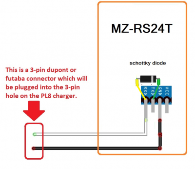

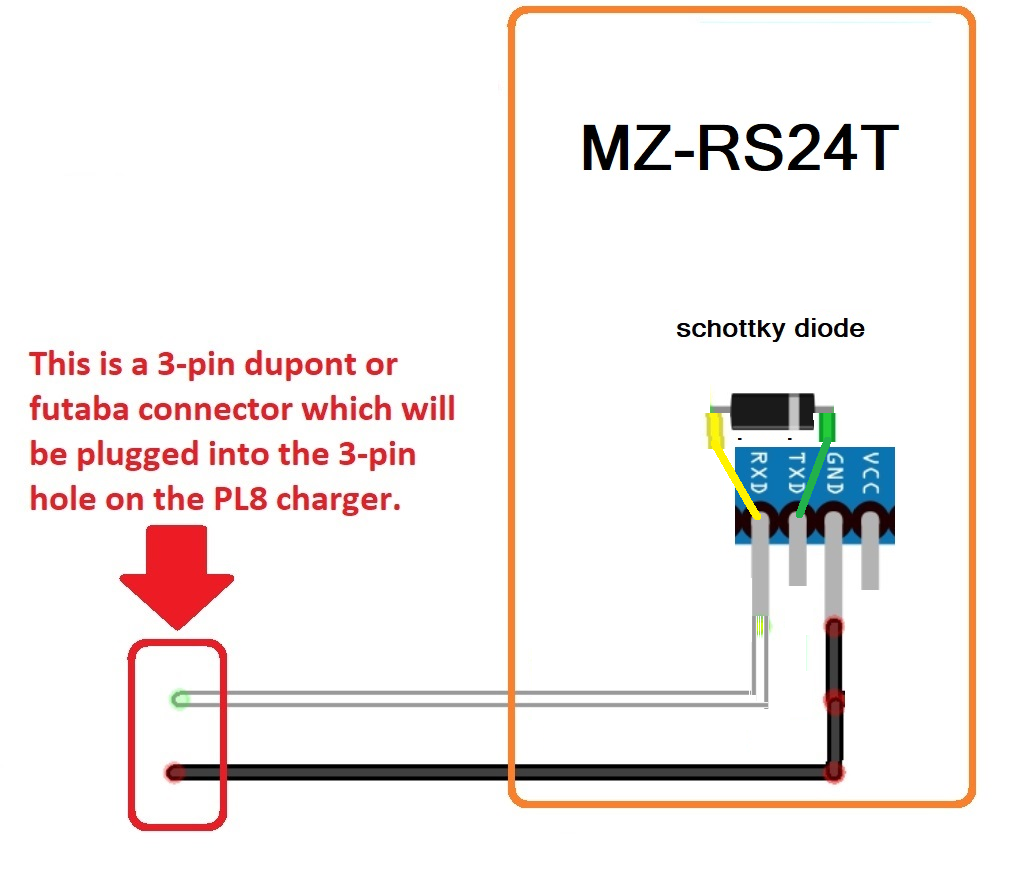

Ah so if I wanted to make a spare one myself...
I need to buy a FT323RL serial converter adaptor.
Then solder a male serial connector (that plugs into PL8) onto them 6 pins.
Then I just need micro male to male USB A cable.
Have you got a wiring diagram for the solder connections?

Re: Damaged FUIM3 - repairable?
Postby shirley_hkg » 06 Sep 2025, 13:36
Thanks to woodygb.
Posts: 4656

Postby Scooterman » 07 Sep 2025, 07:32
Thanks Shirley but I'm bit confused as the PL8 plug has 3 wires and diagram only shows 2 :problem:
Postby Burgerman » 07 Sep 2025, 09:22
Shos just ground and signal wire used.
Posts: 71096
Postby Burgerman » 07 Sep 2025, 09:26
Burgerman wrote:Make sure its opto isolated or bang goes the charger or PC...
If you use that, the PC is grounded via the ground wire in the wall.
The PL8 may be powered by a grounded connection in the wall.
So if theres any voltage difference under load or if its tied to ground at any point you will have 30A or more trying to go doen a USB cable... It can take out the PC or the charger...
Posts: 71096
Postby Scooterman » 07 Sep 2025, 09:26
So is GND and RXD wires all that’s needed?
How about TXD, shouldn’t that have a wire for writing preset to PL8?
Postby Scooterman » 07 Sep 2025, 09:30
Ignore my above reply I posted it while you were posting. I don't really know what I'm doing.
I don't think I will make one up, I've got the Revolectrix one and Shirley's one, that'll be enough for now.
And if in the future I need another one, I'm sure shirley would make another one for me.
Thanks for your's and shirley's help anyway :thumbup:
