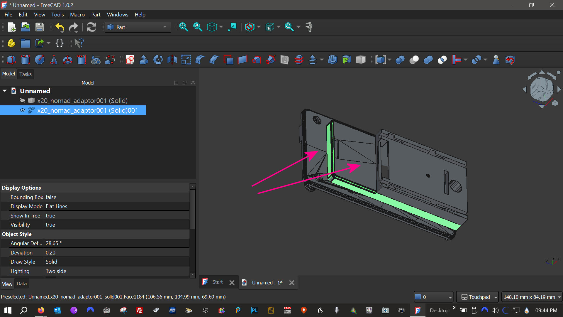

But I downloaeded a part that works. But it needs what I would have considered a simple modification. That is until I tried. 3 hours later and my head hurts...
Can anyone edit a 3MF or 3mf file and remove a bit from it?
Theres a screenshot. The parts in green, all the way around need to go! Theres two arrows, those surfaces need to end up level/flush with the green raised part gone! So the whole thing will end up that much thinner. The rest of it is perfect.
So a band a few mm wide, all the way around, 360 degrees.
Because until I spend many hours learning how to do this stuff its impossible! And I need it printing in something that doesent get soft when warm so PET??
And if anyone wants to print a couple off for me thats great too. I will compensate time and effort! Paypal.
Thanks. Or is it impossible? Password 123 if it asks...

This is the best I could do with prusaslicer. Two cuts, delete the middle and then moving both together

Postby Burgerman » 03 Sep 2025, 16:34
I spent many hours trying to do that!
As far as I can tell, thats perfect.
Thanks! Now to get a print! Any recommendations?

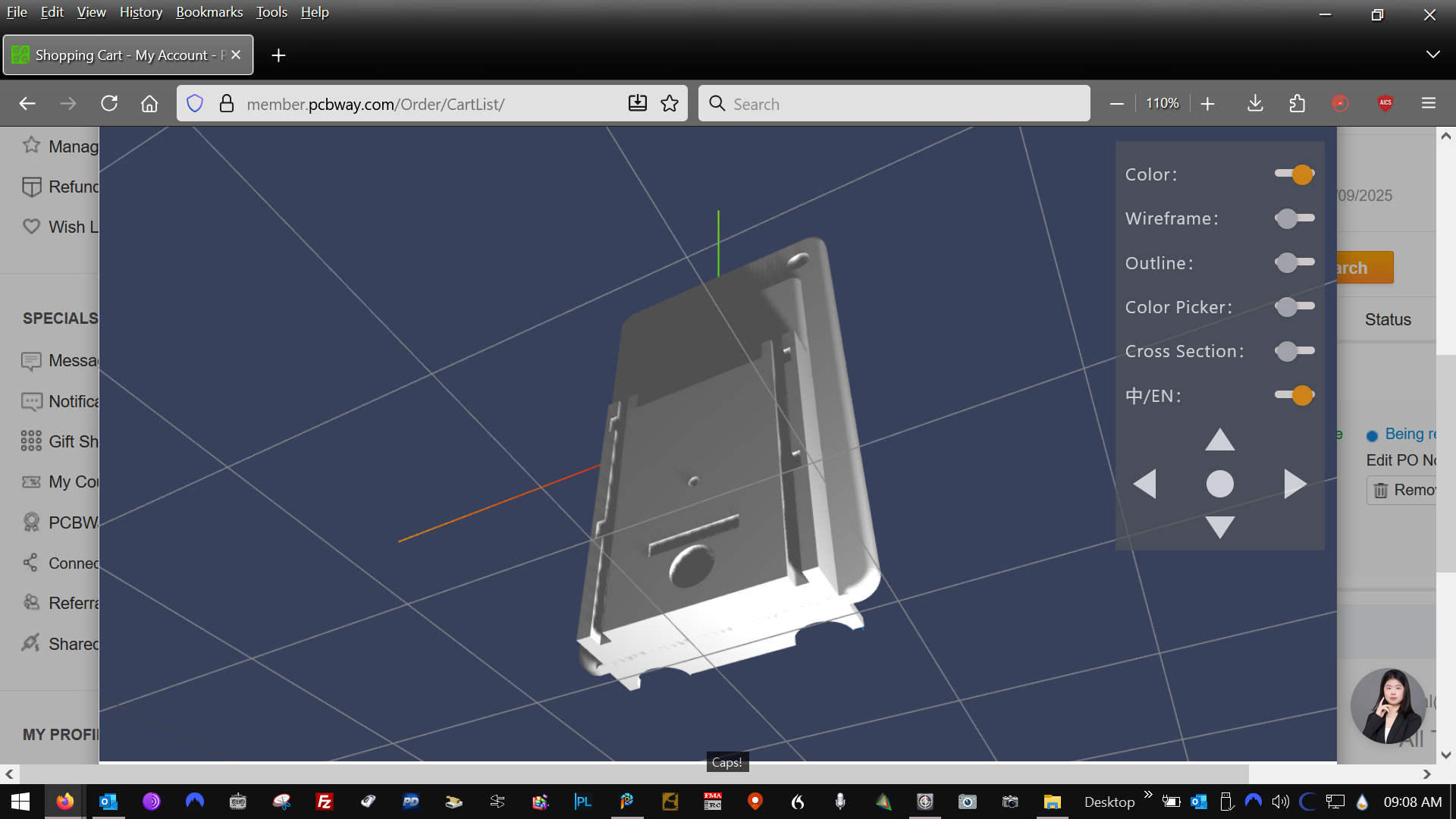

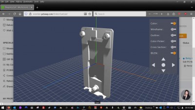

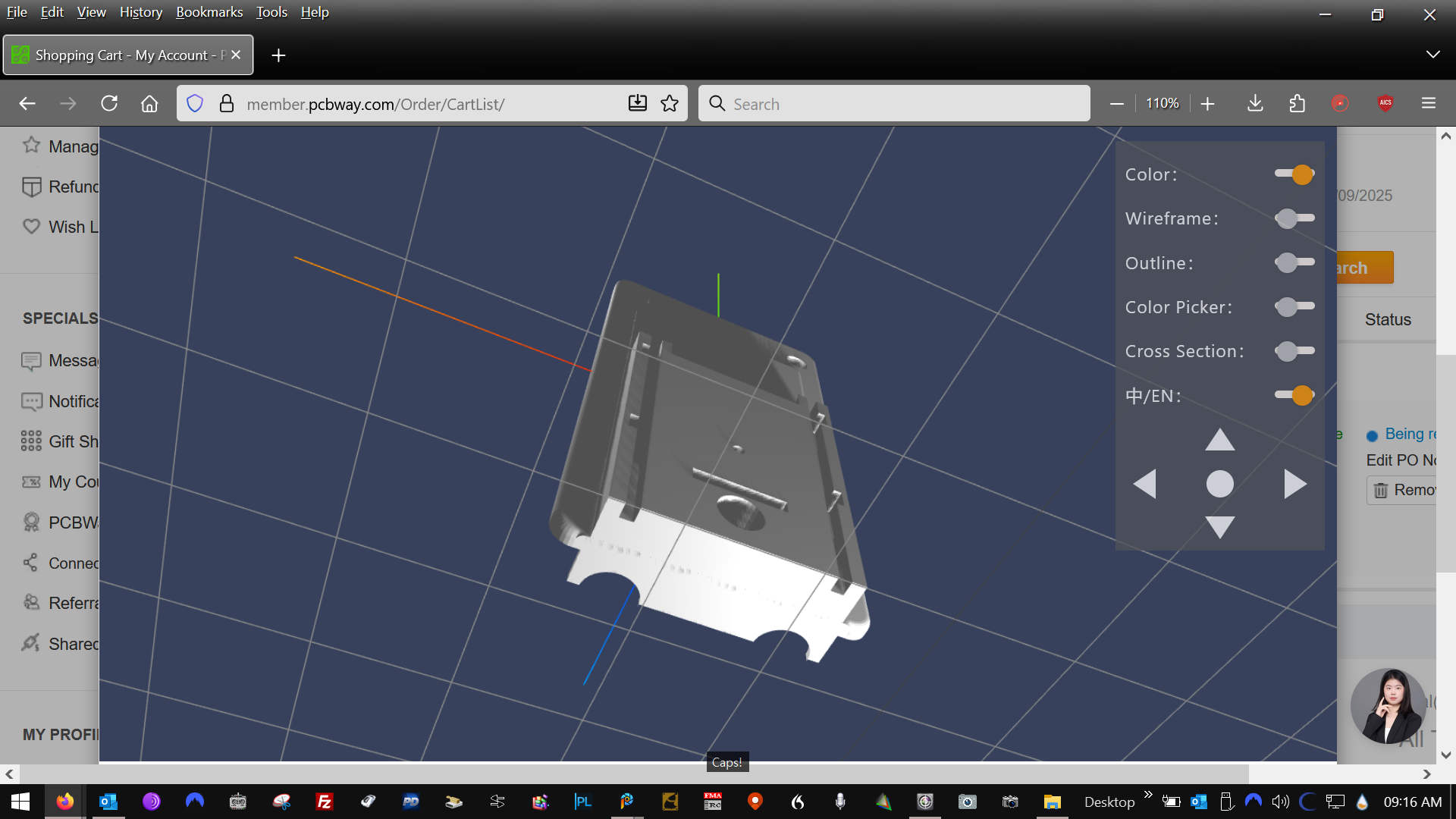

Postby Burgerman » 26 Sep 2025, 12:00
Watch!
https://www.youtube.com/watch?v=w1XqOZsFPrY
I just ordered that part in aluminium 3D printed. After talking to them, and looking at a few 3D prints its the only sensible way.
3D plastic printed parts are not strong, not dimensionally accurate, and seem to be a printer looking for a purpose. So I wont be buying one...
Because I can get these bits printed in metal or CNC machined at sensible prices. Will photograph these all when it arrives.
Posts: 71096

Postby Williamclark77 » 27 Sep 2025, 19:28
I look forward to seeing those. They've gotten to the point that unless you do a lot and need quick turnaround there's no point in buying your own machine.

Postby Burgerman » 27 Sep 2025, 19:38
They can do stuff that you just cant at home. Not only that but if prepared to pay fast shipping 3 days to your door.
I am not, used cheap china post! (3 dollars instead of 33) but its that slow boat...
I looked online at some of their stuff. The metal printed stuff is very "grainy" like its made from sand. Way prettier than the ridges from plastics. But I have a file and some abrasive paper... And want it black anyway so it will be rattlecan satin black!
Its not even expensive. Well ONE is. 2 gets cheaper. 5 is not much more than 2. And so on. And then you win on shipping
If this part fits well, I trim it up and finish it well, spray black, supply 3 stainless allen screws then I suspect I can sell 20 or 30 a year. Is it worth it? Not really! Its a small volume part. But I might try it.
