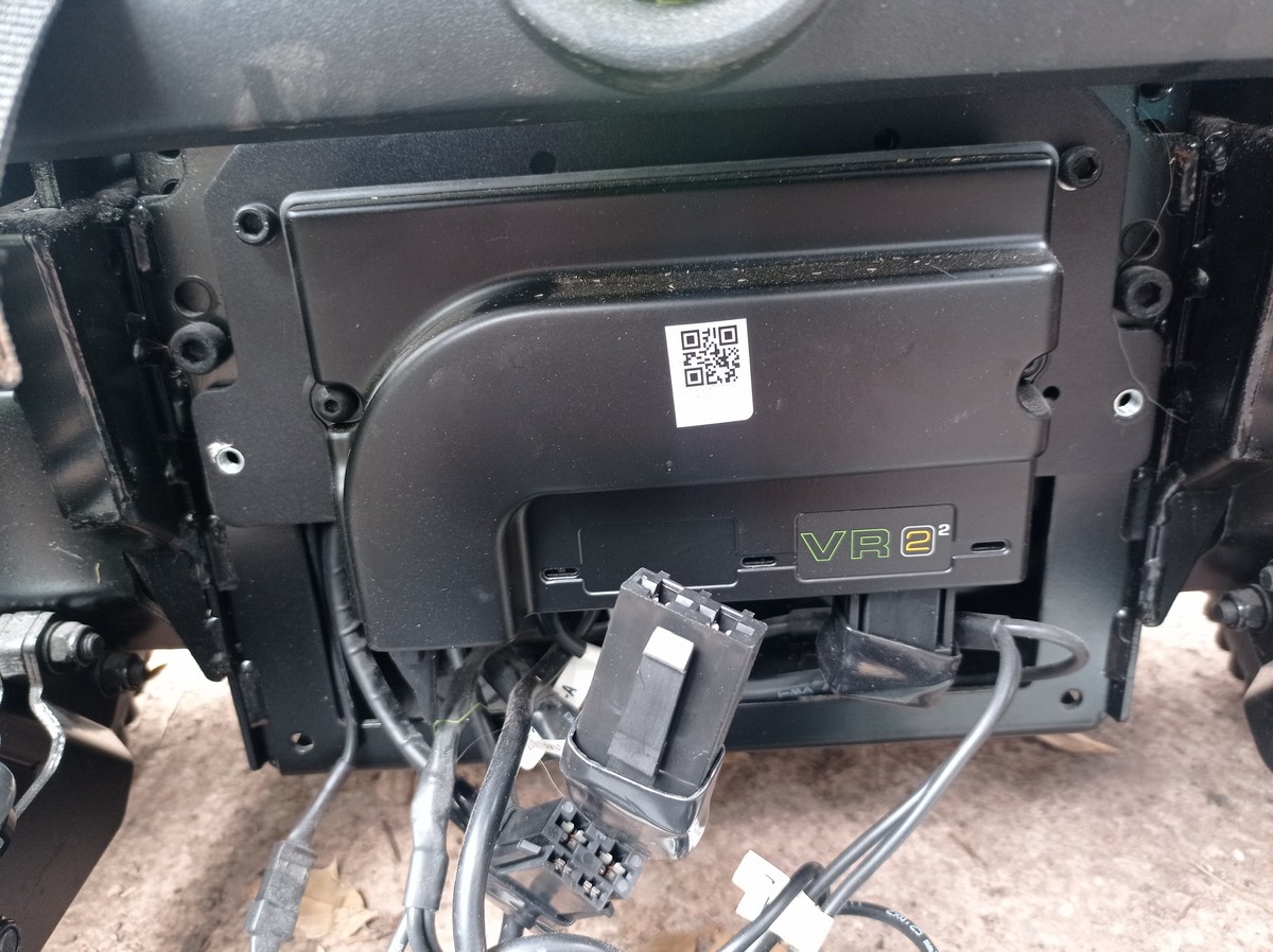

Hi all,
I made a USB cable to program my new(to me) chair, but when trying to use it, I keep getting "comms inactive", I've tried using the different software versions that I can find, with no luck.
The weird part is that when I try to program my other vr2 chair (Karma Blazer 2), it works perfectly... czy
I've checked the joystick cable by meaturing continuity between the xlr port and the cable that goes into the controller.
I tried removing the vr2 from the other chair and was going to see if I could still program it through the q500 joystick, but the battery/motor connectors do not fit? The q500 vr2 itself is different and even the logo says "VR2 2"?
The chair was apparently built in 2023 if that helps.
Has anyone had any luck getting "comms active" with one of these "VR2 2" controllers please? If so, which version of the software was used please?
Thanks!

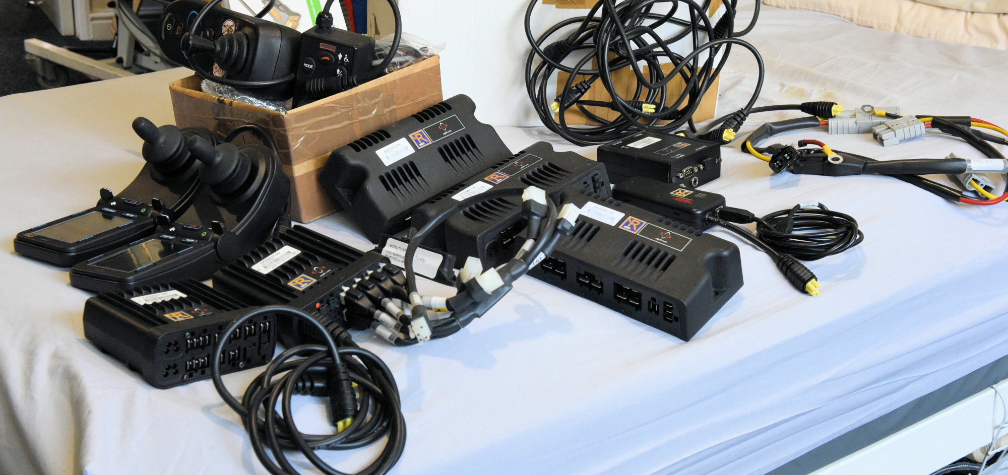

Postby Burgerman » 11 Sep 2025, 01:46
If PATIENT and you learn to fish eBay and other online forums well, you can get silly cheap R-Net stuff. When its avalable its like buses. Make daft offers and wait!

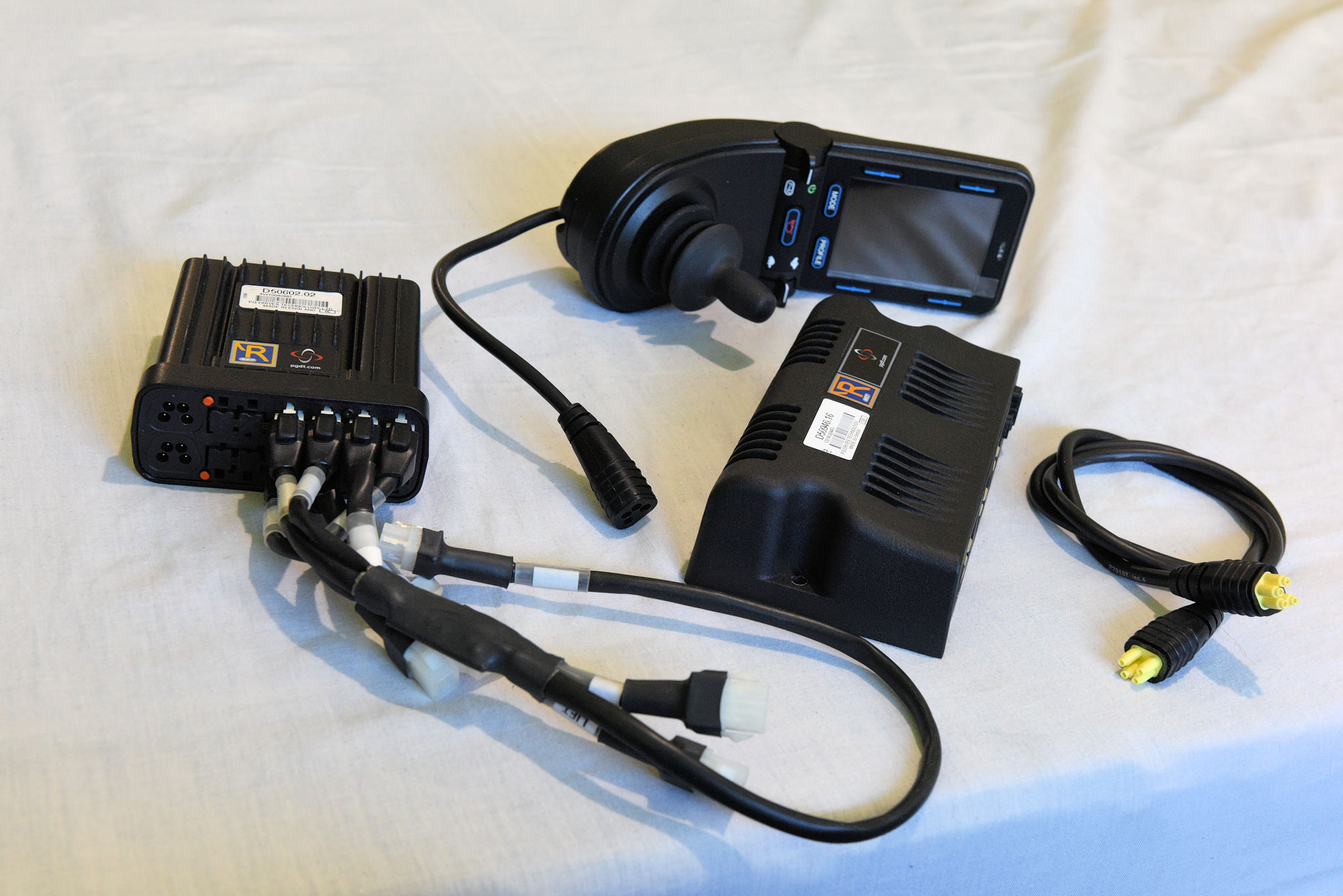

For e.g below is a seating module (does 6 actuators, and lights) as well as a 120A power module. He through in 2 bus cables too. For £50... As good as new. Not even dusty.
And a brand new joystick. Never been out of its box, still with screen protector. Says £100 here, but he accepted 80.
SOME of the rest. Theres about 2 more complete systems not shown here.
All of this stuff combined was under 1K total. It took a lot of fishing. All joysticks are brand new. The most expensive ones were the CJSM2 ones, £125, £125, £150. The rest was all around the 40 to £50 mark.
Here is 3 CJSM2 colour joysticks, 3 120A power modules,
3 seating actuators, and a load of other cables, and joysticks etc.
A Part of my spares collection. The whole lot is either brand new (joysticks all are new) or as new. Or taken from new chairs broken for parts etc. The lot was under £1k
And thats enough to fully equip 3 full rehab full house powerchairs from the ground up.

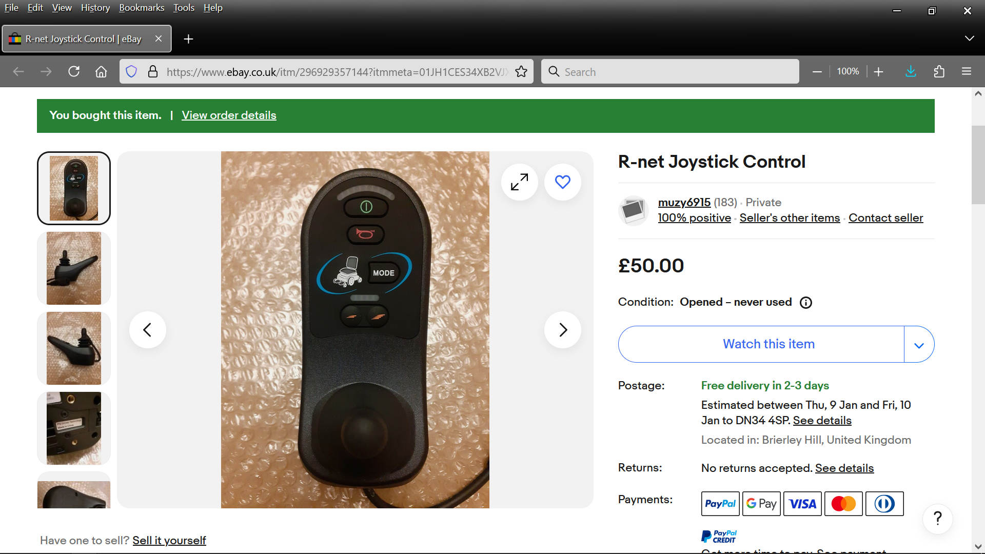

It is basic! It can replace ANY of the other joysticks as a backup, plug and play.
Its also completely new, and he accepted my £40 offer and added a free bus cable...

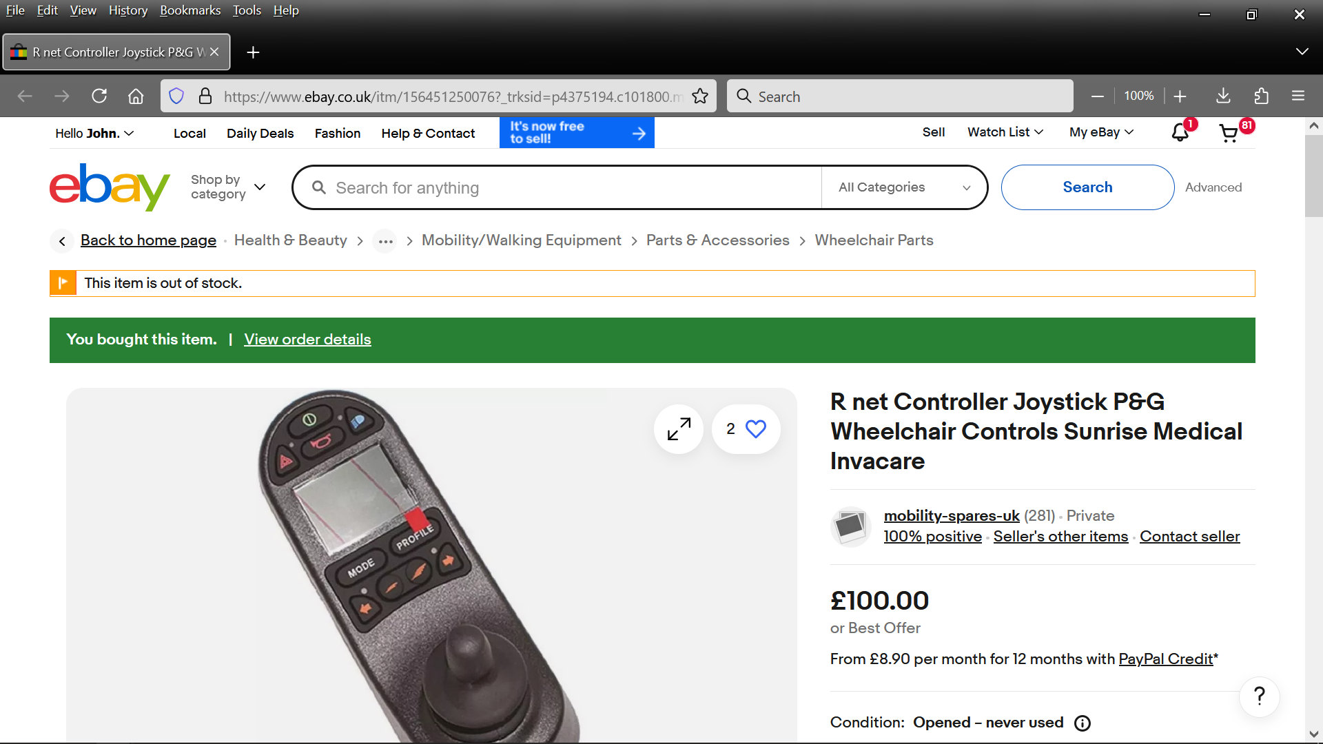

EVERYTHING needed here for a full rehab high end chair (£175):
Full system. With 6 actuators, lights, all loom parts.
CJSM2 joystick £125 new.
120A Power Module + ISM6-L seating module + cables £50
Total, £175... Seriously.
For a full complete rehab powerchair all power functions with the besto ptions available.

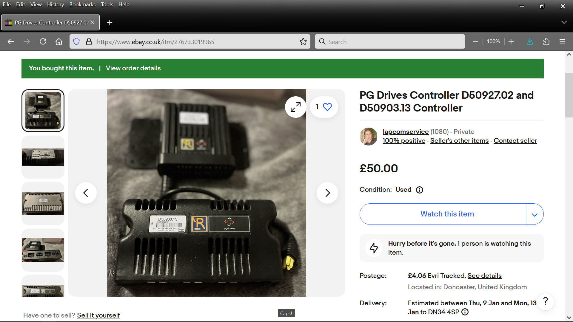

The result of all of this is that I now have EIGHT complete high end R-Net systems either on chairs, or in boxes all bagged, pre programmed and labled as spares. And a few spare modules and joysticks and cables on top!
That will see me out. I am 65.
It means that if anything fails, I am back in action straight away.
It means that I have plenty of swap out options, to fault find!
It means that if R-net, the last remaining non locked down system, becomes locked, then I will still not be going forwards even if I have to swap a system out!
It means I can buy any old cheap new or ebay chair wih a less than great control system, or a locked one like curtis instruments or linx etc and just swap it to R-Net for cheap! And then EBAY the pride/dynamic/low end/locked systems for a profit... And end up with another better chair!
Options...
The LOT and there is a lot, was sub £1200 over 10 years of watching. Plus that ESSENTIAL programmer!

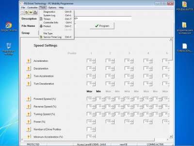

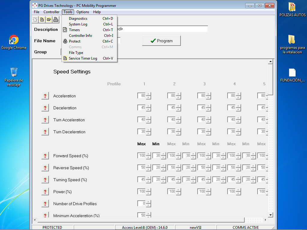

Postby REPARACIÓN SILLAS » 11 Sep 2025, 14:18
Good afternoon, we have the OEM and dealer version 14.6.0 of PG Drive for PC programming installed on a laptop and a PC. The cable is an original PG Drive, and now, after years, it doesn't recognize the COMMS.
We deleted everything and restarted the machines, and it's still the same. We did it as administrators, the ports are working fine and up to date, the devices recognize the cable, but we can't find the solution.
Have you experienced the same thing? We appreciate any feedback.
Gabriel and Tomas.

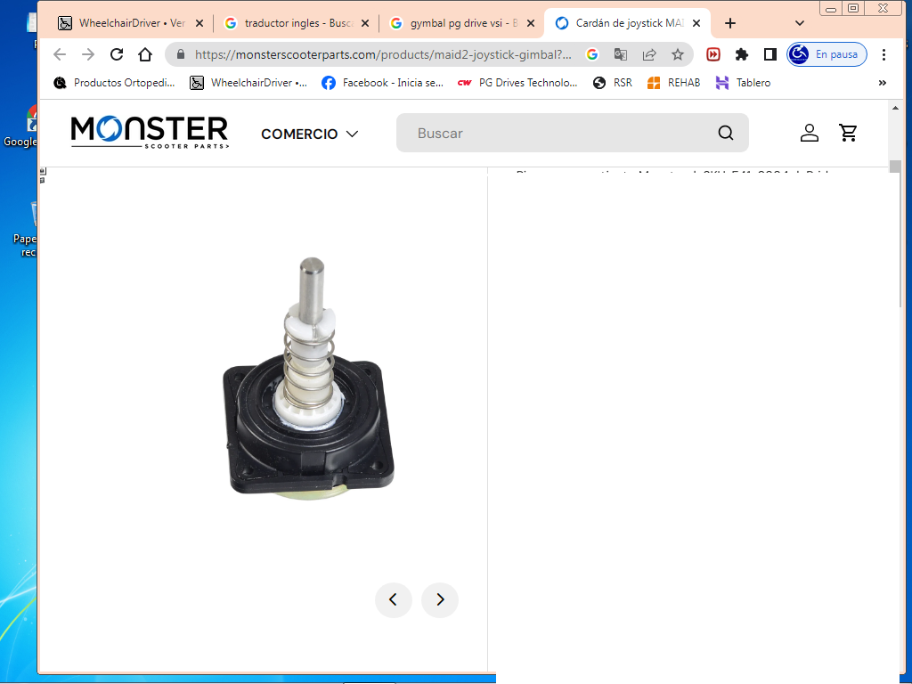

Postby REPARACIÓN SILLAS » 11 Sep 2025, 18:42
Potty wrote:Well another problem, which may or may not be related to this.
When I first got the chair and started to use it(using lead batteries) I noticed it had a 7 light fault code appear (Possible joystick trip), turned off and on again and it worked. Happened a couple of times over those few days. Earlier I was out and it happend 4-5 times within about 10 mins.
I plugged in another joystick, thinking maybe the joystick was faulty, to test programming it, still did not work with any of the versions of software.
Wondering if the controller could be faulty? Or my programming issues and fault code 7 are seperate and there is an intermittant issue with the joystick/joystick cable(maybe pinched at some point)?
You can also check the data cable and even the gym ball, which may be dirty or have poor contact. Sometimes we see the problem there, replace those components, and it's solved.

Postby Potty » 11 Sep 2025, 19:43
REPARACIÓN SILLAS wrote:You can also check the data cable and even the gym ball, which may be dirty or have poor contact. Sometimes we see the problem there, replace those components, and it's solved.
Thanks for the reply, by "gym ball" I asusme you mean at the base of the joystick? (I've not yet had one of these apart) :thumbup:

Postby REPARACIÓN SILLAS » 11 Sep 2025, 20:28
Sorry for the translation, obviously I don't speak English...
I'm referring to the joystick.

Postby Burgerman » 11 Sep 2025, 22:25
Just clicked!
Gymn Ball. Gimbal.
Posts: 71100
