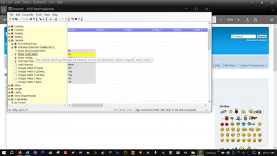

Interested to know how to program Rnet to work without parking brakes connected, and is the chair still holding on incline / slope when you release joystick. cheers

Theres is a section that allows its error to be turned off.
So then just remove the brake. I never tried this but thats supposed to work!
On a slope it will roll slowly downhill when you release the joystick. To a degree motor compensation will try and slow it. But it will roll...
If for some reason the power cuts off, fuse, BMS or whatever or if the controller fails, or a user turns it off, it will roll very freely! And get quite fast. Into traffic probably.

Postby Burgerman » 19 Sep 2025, 07:23
Above. Not advisable...
Brake is needed or char is not safe. A curb cut for e.g will allow a chair to roll on into the road.
You can balance it on the joystick to hold it still for a while if skilled, but that heats up motors and controller. It will at some point overheat and shut down and you roll down a big slope anyway. But a motor that is stationary with current/torque going through it doesent cool. It needs to spin to stop brushes burning and to cool via airflow inside the case.

And why its not a good plan to set that warning and error detection to OFF in the R-Net software. You can. But dont! hanged

I just turned off error checking on brakes. It's a chair to go out so there's always someone nearby. I'd never go down a hill with that crap anyway. It's so light that a small bump you flip. It's perfect to go shopping, restaurants, etc. Anything outdoors I use my actual 400lb chair.
