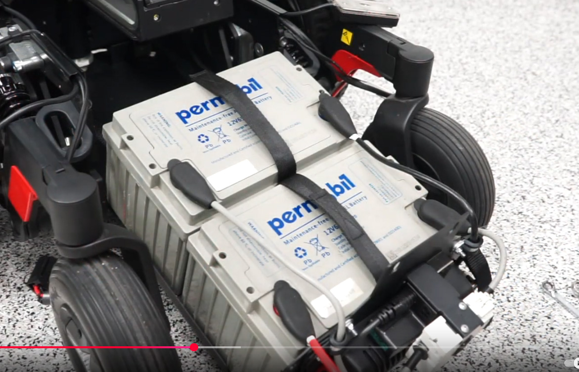

Postby fordragon88 » 01 Oct 2025, 06:25
I was considering switching to lithium (LifePO4). I found a local battery assembler, but he doesn't know how to properly connect the battery to my wheelchair. Could someone explain to me, for example, the Permobil F5, how to do this correctly?
photo from internet, youtube video
fordragon88
Posts: 23
Joined: 19 Sep 2025, 20:27
Re: Permobil F5 – Battery Size and Alternative Controls
Postby Burgerman » 01 Oct 2025, 08:17
If this battery assembler has any clue at all about what he is doing then how to fit a 24V battery to anything is OBVIOUS and simple. The fact that he says he doesent know how tells you all you need to know about him. Run away.
Theres 2 batteries connected in series. Like every 24V system in existence.
The only thing different to the drawing is that theres a simple breaker or fuse in that link between the two batts.
I suggest that you find someone else that is competant. Or DIY.

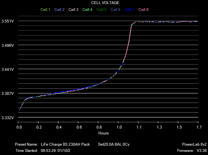

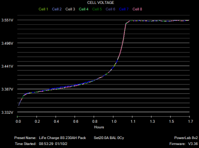

Heres a charge graph... Showing all cells perfectly balanced as they charged.
