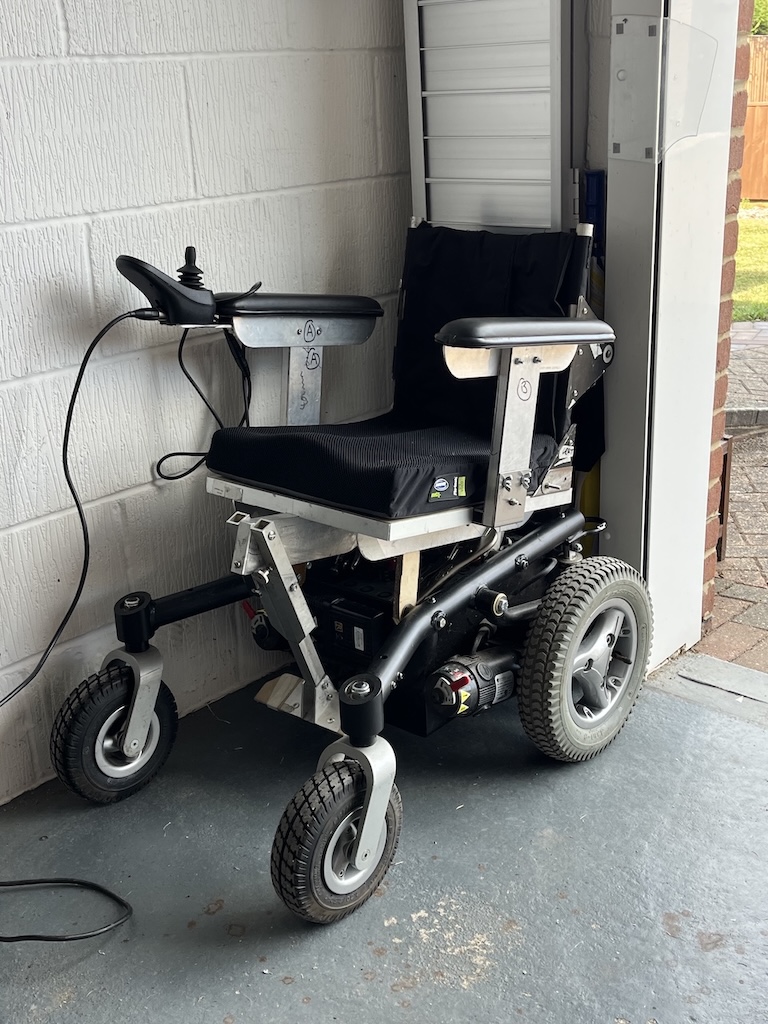

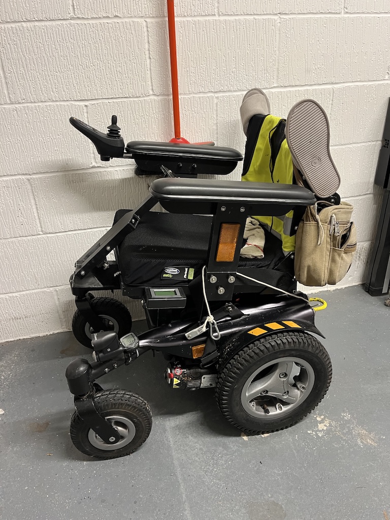

This is a sunrise salsa/jive R2 rover sourced for me a few years back but only just got round to modifying. It had rigid thick seat back, swing away foot rests, and tilt. But fortunately I only need a power chair for outdoors mobility, I use walking frame and manual wheelchair indoors. So I don't need rehab seating.
I already have a salsa/jive R2 with custom seat, etc but wanted a backup chair. They're both the same spec 120A r-net and 4-pole 6mph motors and BM's programming.
The old one has 150Ah lithium, this has 230Ah lithium.

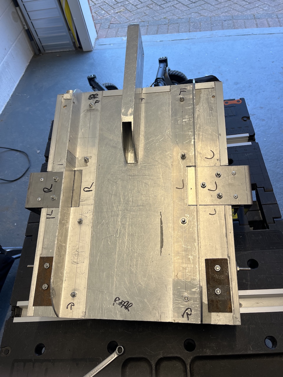

The seat base is 20mm hardwood ply sandwiched and bonded between two sheets of 1.5mm aluminum. The rest of it is 6000 series aluminum. It's plenty robust enough for my weight 52kg.

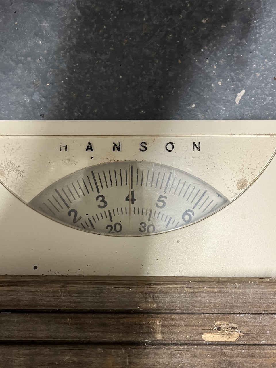

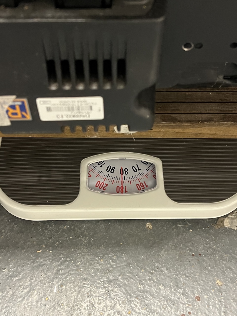

Anyhow I decided to weigh chair on two sets of bathroom scales with decking board across each one. Lifted front wheels onto scales/board, jacked up rear and slid scales board underneath then lowered so chair was sitting on both sets of scales. Total came to 106kg
I was surprised it is that heavy but I suppose everything adds up? The lithium pack is 39kg + Motors + Wheels + frame + battery box

Probably a trivial amount on the large scale, but that seat base sounds over-built... I have a couple of my project chairs that use what looks like 1/8" ~3mm aluminum sheet on the seat frame, and do just fine. The seat frames do have some cross members that help w/ support, but not that much....
