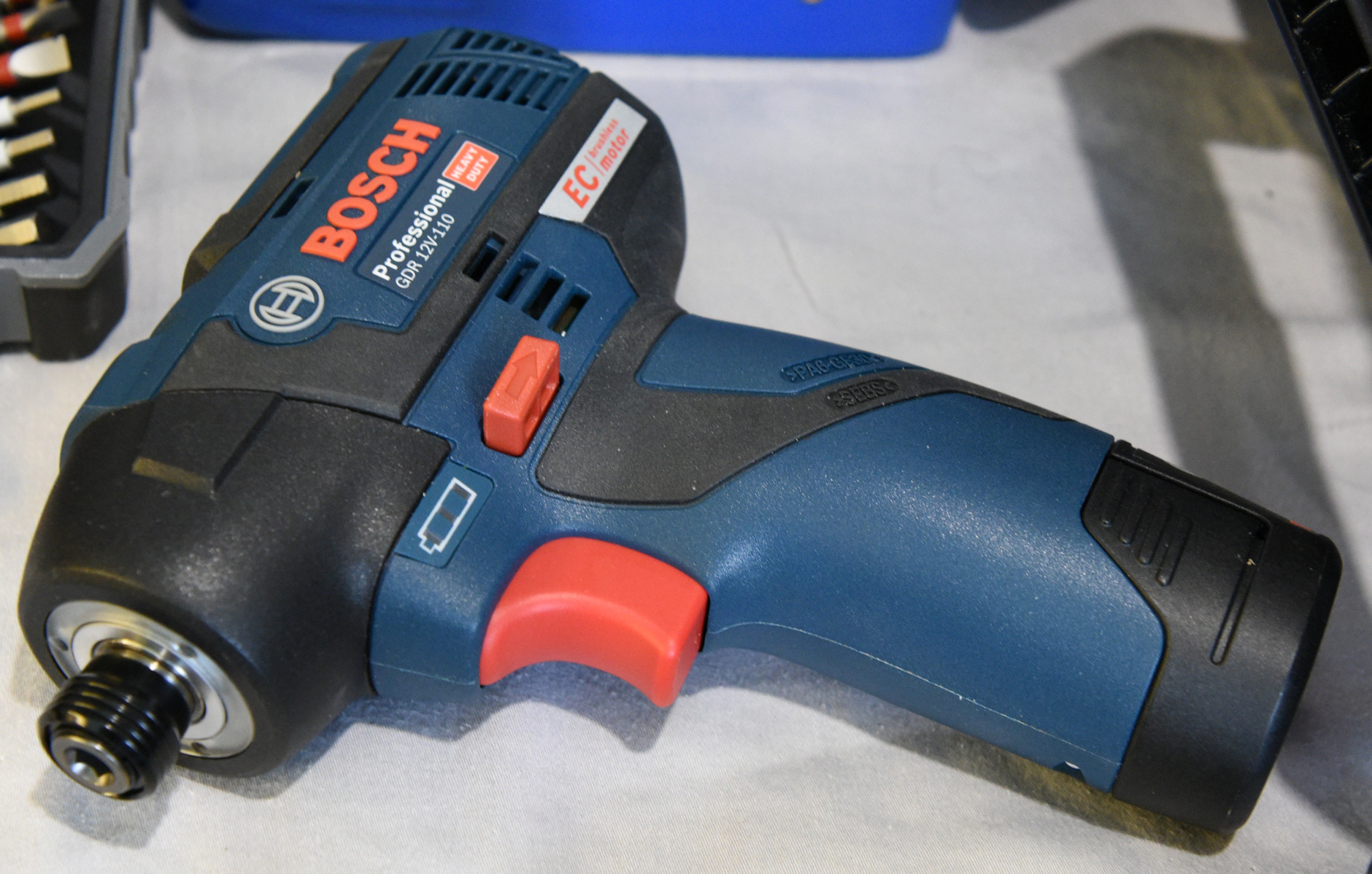

For e.g to strip and work on anything easily and quickly you need a powered recoil free wrench! Works on screws, bolts, allen deads, etc.
Like below.

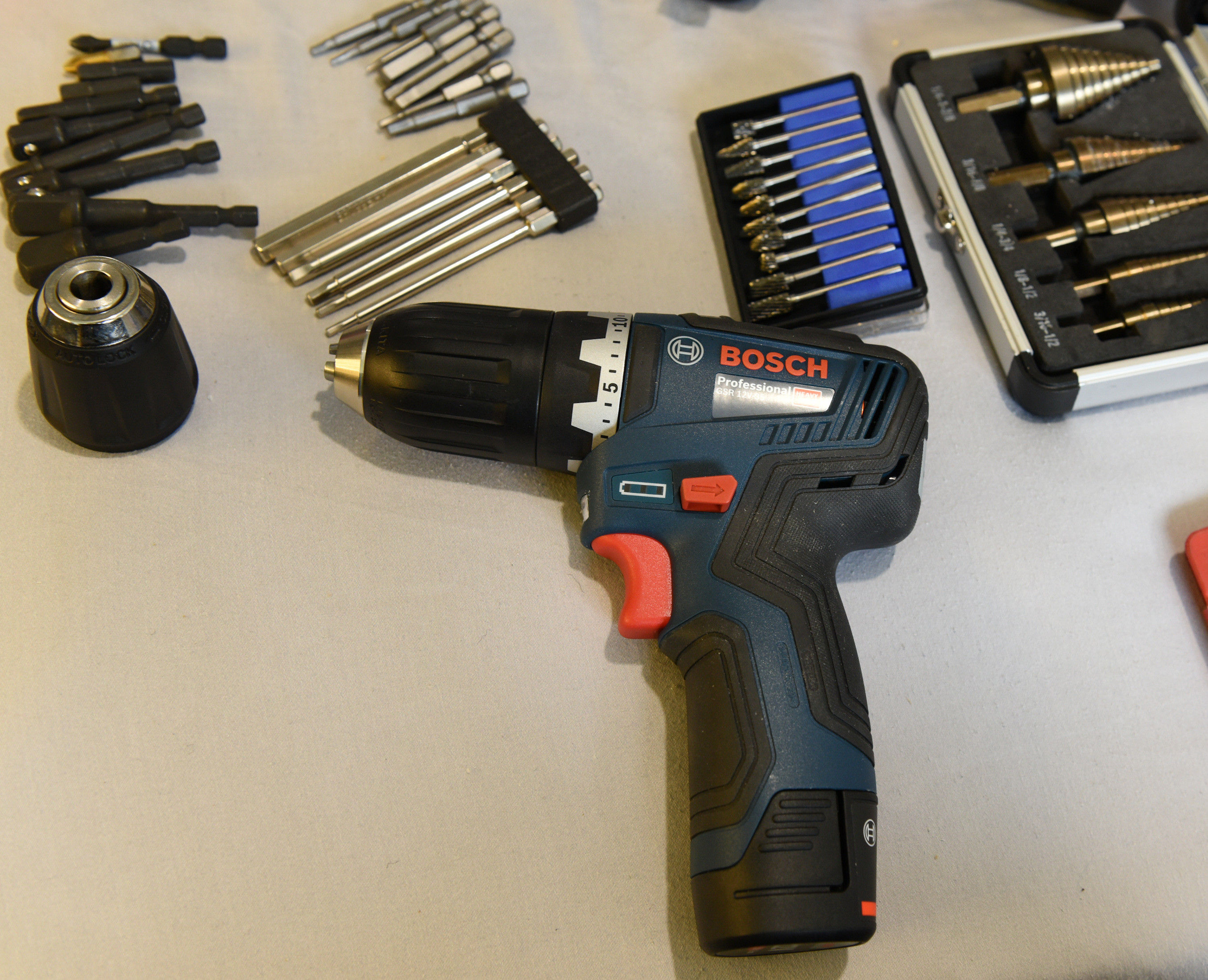

Below is a drill, with a half inch chuck, so that you can fit larger drills into it, and the big orange hole saws etc. And taps to thread holes. And so on.

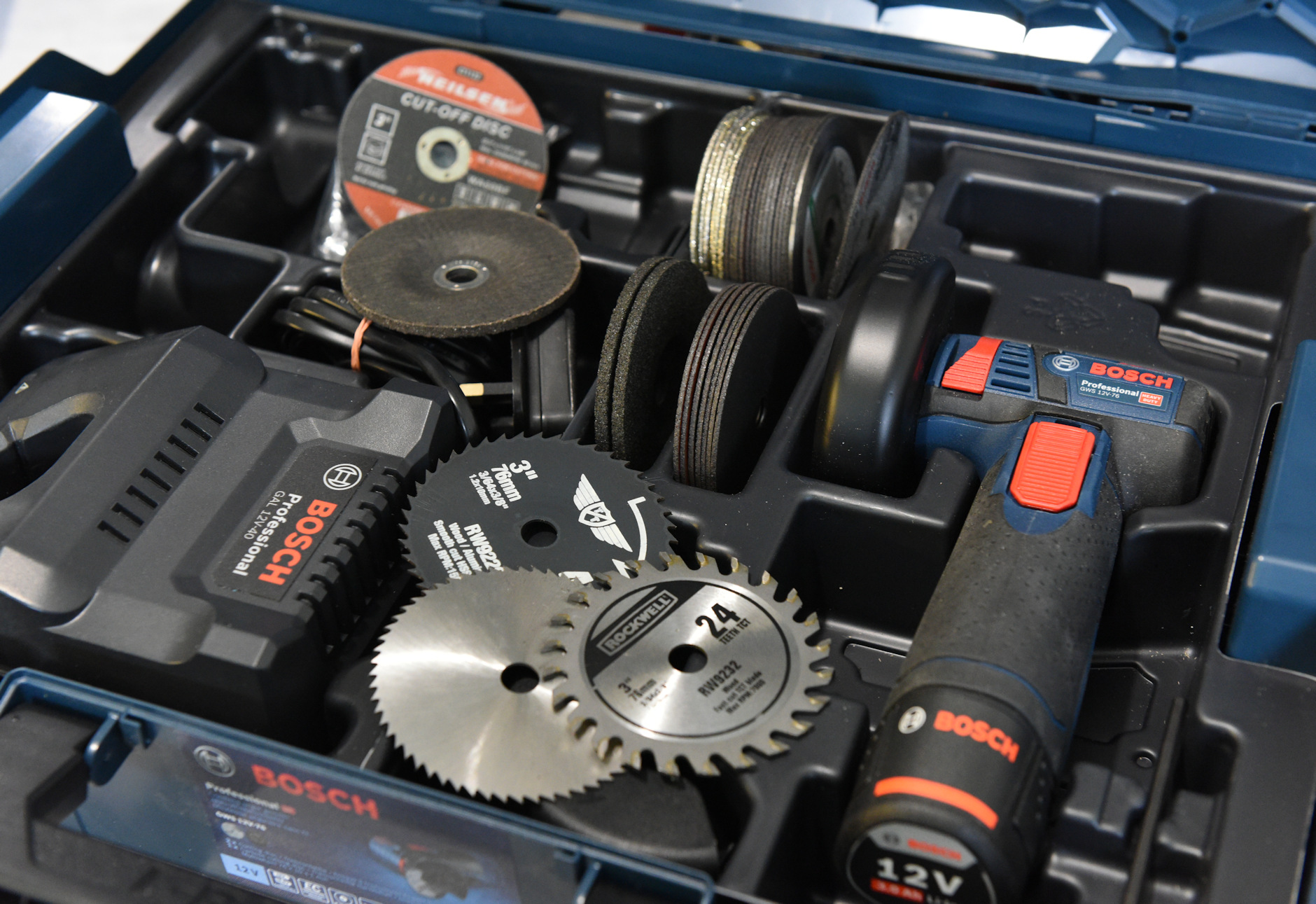

And we need to grind, cut, and strip paint etc too.
So a tiny 12V grinder...
WITH adequate blades, polishers, grinding wheels etc.

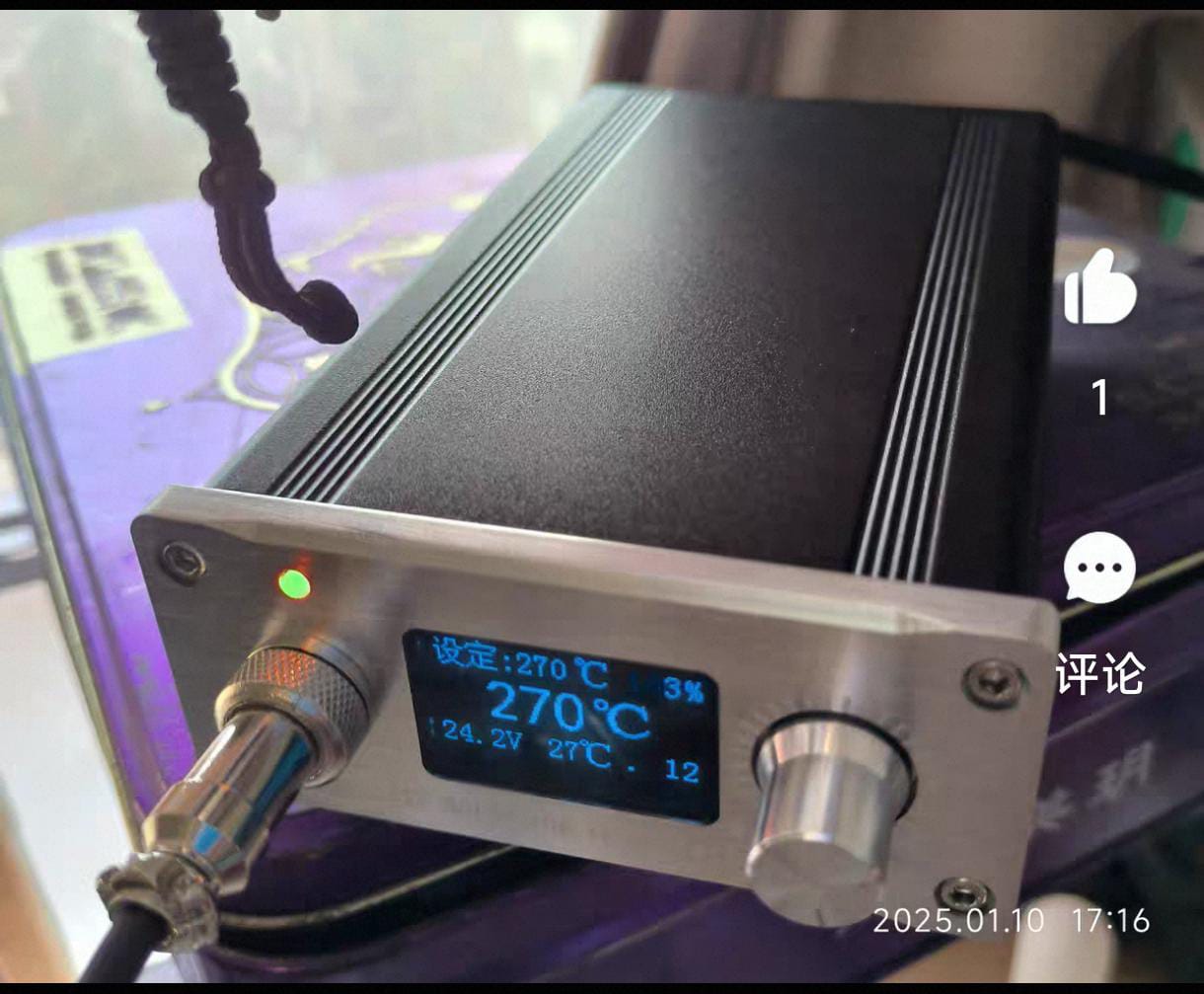

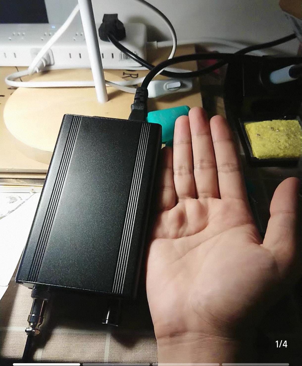

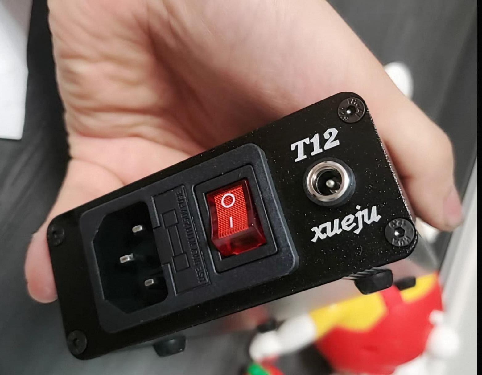

I want to upgrade the solder station. The one like in the video is not sold here. I only find GVM T245 (130W), ESD T210 (75W), OSS T12-X (72W). GVM and ESD are advertised using Japanese electronic components. OSS is a little cheaper. Can you recommend which one should I choose?
Posts: 1259
Re: Soldering
Postby shirley_hkg » 05 Nov 2025, 03:56
Genuine JBC C245 tips are expensive, while clones are still need to be better.
I suggest T12. Save money for more tips to suit various applications.
【淘宝】大促价保 https://e.tb.cn/h.SpYsHhKU0TFzhiO?tk=Uuepf6ix54a MF278 「雪驹电子白菜白光T12电烙铁 数显恒温焊台c245\936全兼容自动休眠」

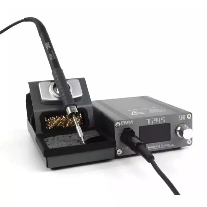

Theres a newer version, that is a little better. More bench freindly! Still same 245 iron, same JBC tips, same 200 watts.
And I just ordered one.
https://www.aliexpress.com/item/1005006172847327.html
Ordered the 220v, 245 handle, 3 tips... With a massive discount day. Which has gone now. Still cheap though.
So if its any good I will sell my Hakko one to pay for it! If not then I will sell his one!
(Any offers? Complete with many tips, and clean and unmarked hakko).
Being disabled soldering is much harder for us. It means we can move stuff around, reach for things, etc. When I do this I need magnifying glass, help, etc from a carer! And I drop everything. And end up doing soldering from my bed laid down as its the only way I can have any trunk stability and so use both hands at once to hold stuff! Seriously. Carers are essenial!
And ordered 2 geniune non chinesium tips. A 5mm wide one for connectors. And a horses hoof type 2mm one for hobby stuff which is small.
Its cheaply made, but it looks very effective in that it rapidly ramps up power as needed. So it can solder heavy stuff, connectors etc as well as small things. 200 watts and rapid temperature control response.

New iron arrived.
Its great. The temp control is very rapid and because it can do 200 watts (250 peak) it can solder unfeasably large cables and wires.
The tips it comes with are really designed for circuit board or SMD stuff. The whole iron is tiny and short compared to the hakko one I am used to. Thats good. It can show you graphs of power and temperature. The tiny 3 soldering tips it comes with cannot transfer much heat unless you have a few skills and know how to get the solder to do that for you...
It cant transfer more than about a third of its power this way though. So I ordered a couple of larger tips...
Other than that I definitely recommend, with the 245 handle.
https://www.aixun.com/downloads/t320%20 ... ual_en.pdf
AiXsun T320 good balance price v capability.
I updated its firmware from 1.12 to latest 1.14 although cant tell any difference!

Postby shirley_hkg » 22 Dec 2025, 07:17
Burgerman wrote:One of the BIGGEST advantages for us being disabled is that it automatically turns off power and cools the tip when you put it back into the holder. That means that we dont burn off the flux, oxidise the tip while we are struggling to position something. Then it heats back up super fast. The alternative that I do now is try and reach to turn off the solder staion. Thats easy if you are not disabled... Much harder when you are! So this is automated. No more black irons!
youtu.be/-ug7rLdOWto
This is surely a very disability friendly feature.
How much did you pay for it ?
Taobao has one that's similar. £40 I guess.
https://youtube.com/shorts/YNItJ1JTBus? ... fIPkzIKqw0
Re: Soldering
Postby Burgerman » 22 Dec 2025, 12:41
That link no working for me?
I used this iron on some very small circuit boards and surface mount components. Its a small, light and short iron, and I have many different tips. This makes it much easier to do super fine and small stuff compared to the older iron.
I soldered a few test connectors too. Some huge ones, and heavy cable. It is a 200 watt iron. And its temperature heat/power up/ stability is superb. I can easily solder big heavy connectors too. Although I use much bigger tips for this. All in all, this iron is highly recommended!
I now have around 8 different tips. From tiny to ones that look like a small hammer! As well as cutting blades, and a wide/thin one for doing many contacts at a time on a microchip. I like this iron!
