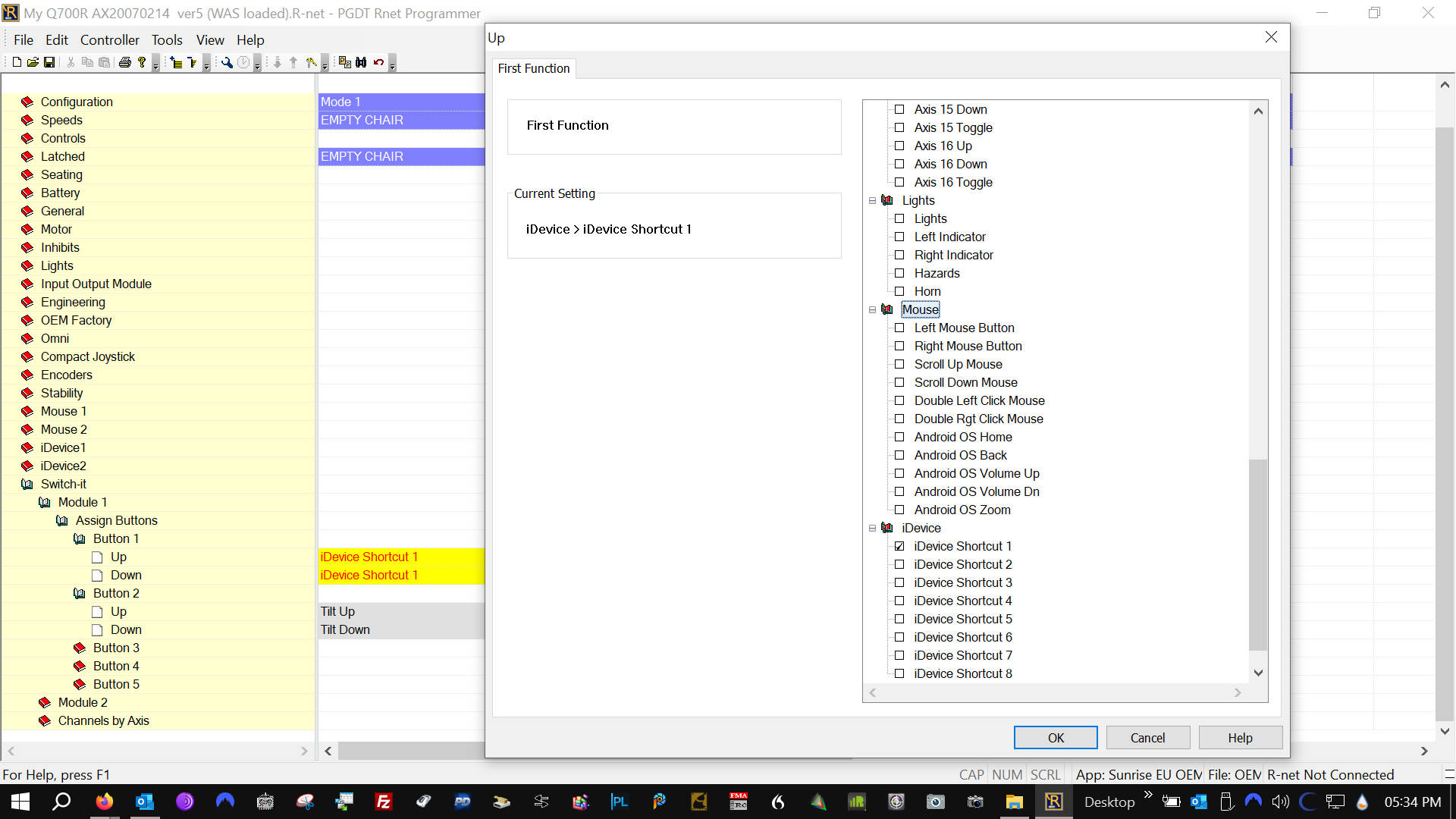

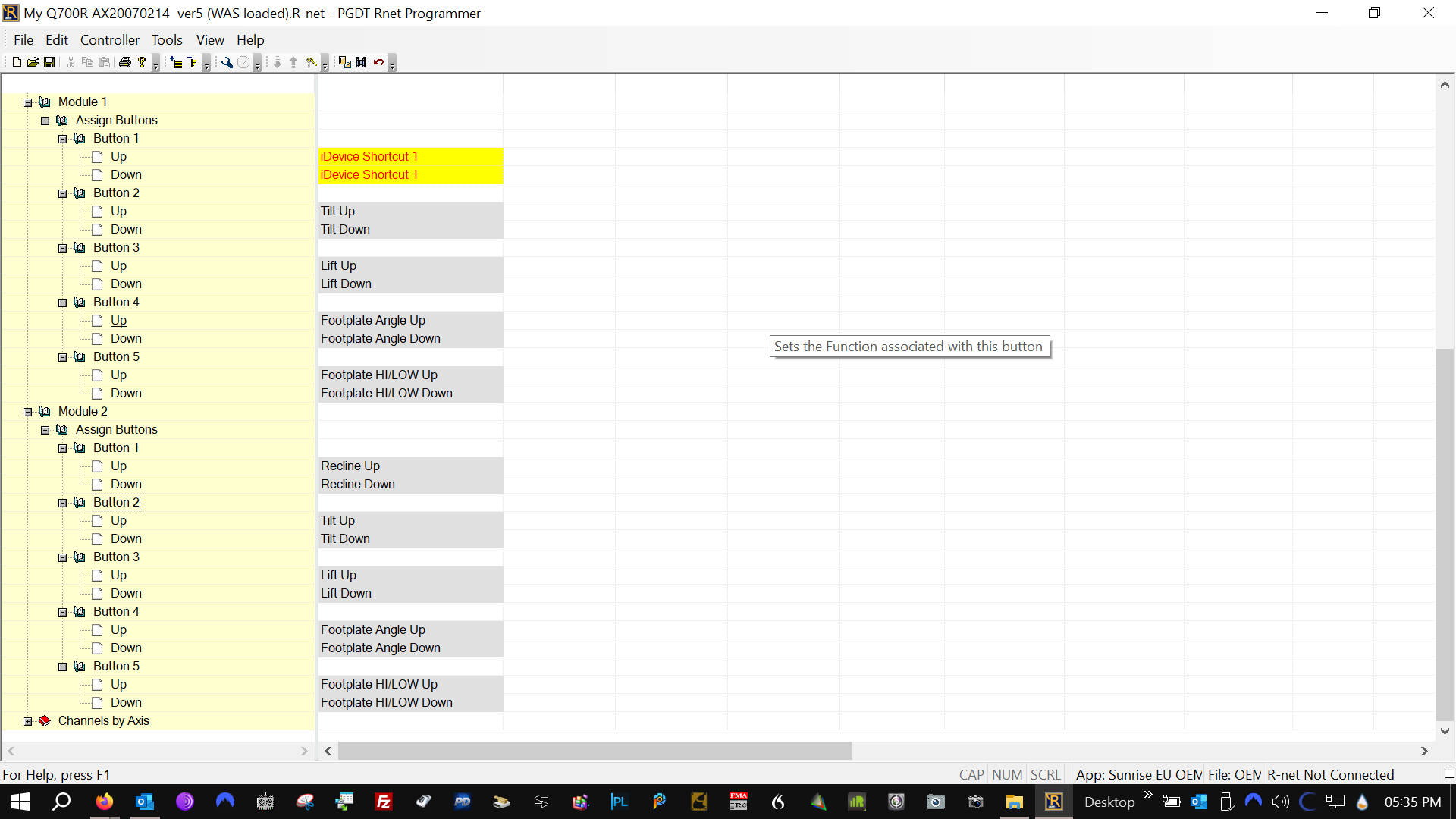

Remember that the Switch it system should work on all R-Net?
And even more importantly that you can use 2.
Each one has 5 switches (and so 10/up down) these are voice command too. And 10 seperate functions. So with 2 units you would be bankrups and have 20 in total.
Now its unlikely that you need 20 seat controls, especially as you can combine them (so legs/recline can work as one for e.g. These 20 functions are highly mapable.
You cound use it to work your TV or computer. So TV channel UP! to get away from the BBC or Volume down. Turn the lights on. Whatever. Anything that the comprehensive infra red system or BT allows. Also too much other stuff to list regarding control, profiles, speeds etc.
To make it work on non sunrise chairs you would just add the following file to your chair.
add switch-it stuff.Rnss
Add to chair.
(4.69 KiB) Downloaded 11 times
Shows some of the options.
