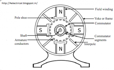

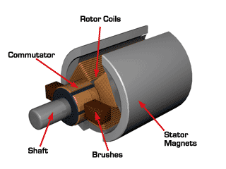

Heres whats in your motor.
The magnets and iron cores attract each other.
The 1st is what you see on a small motor in a "toy" or something cheap. With 2 poles and three iron poles and 2 magnets, 2 brushes. A two pole motor. The 2d one is whats really in your motors. There are many iron sections. And 2 or 4 brushes, and 2 or 4 corosponding magnets.

4 pole is same as 2. Just uses FOUR magnets, and has FOUR brushes, and double the number of activated windings at any given time.
So its literally 2 motors in one casing...
You FEEL that as twice the magnetic pull. Or twice the strength of that magnetic pulse. You HEAR it for the same reason. The motor wants to turn in distinct strong 90 degree phases. 1234 per revolution.
Unlike a car or bike engine with 2 or 4 cylinders they all fire at the same time! But twice as often.
As for precision in small spaces the 4 pole is actually BETTER not worse as it has more torque and so ignores extrernal forces like casters positions or carpets etc. You may FEEL the individual magnetic notches but positional accuracy is truly better. As long as your chair is programmed properly and motor compensation is set high enough and turn acceleration/decel is set high enough. Like all 4 min, max, acc and dec to 100. And Torque is CORRECTLY set to match compensation.
Why? Because theres twice as many "notches" per motor revolution that the motor wants to settle into. And many hundreds per wheel revolution.
At which point its millimeter perfect and totally predictable regardless of carpets, casters etc.

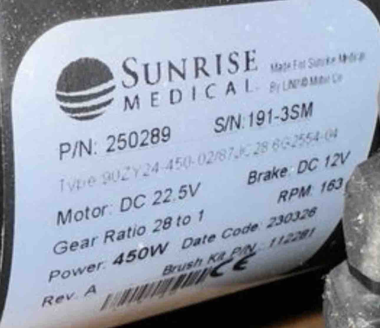

My chair gets 9km/h not more. I have 12,5” rear tyres. I tried another q300r with 14” tyres and the same motors and the speed was the same. I also tried another q300r with 2 pole motors and it reached 10km/h.
My motors are 163rpm and the 2 pole motors are 175rpm.
Not logical. How are you determining speed?
12.5 + 12% increase in diameter and rolling distance is 14 inches... So it will be 12% faster approx. In reality about 9% because of the following...
Also that rpm figure at 22.5V is quite useless. It tells you only rpm per volt in a free running unloaded motor. Real speed OR RPM depends on load, actual voltage reaching motor, and losse which is determined by motor impedance, battery or wiring impedance, rolling resistance, so tyre diameter and even pressures, your and the chair weight, CG position, how level the surface is, temperature of motors, batteries and battery type as well as programming. Remember a bgger wheel increases load all else equal by 12% too.
For e.g a lower impedance motor may have lower free running rpm, but will respond better to compensation, will automatically draw more current as you load it anyway, and will slow less under rolling loads. But may/need a lower impedance battery or controller/wiring to do so. Or that battery voltage falls more under a load at the motor terminals.

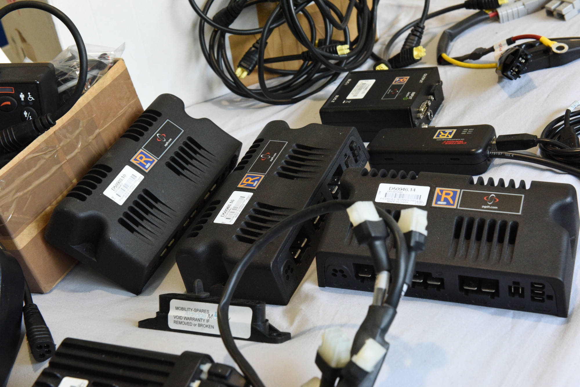

If you really want faster you need a set of Motor P/N: 250292 and 250293 and a 120A power module with good low impedance battery. Correct programming.
If you prefer torque (curbs) you need the motors you already have with the 120A module and programmed properly.

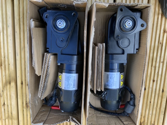

These... On my shelf!
Posts: 71089

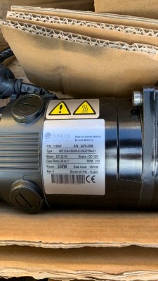

Postby Burgerman » 08 Mar 2026, 17:27
Yes I know. Different part number again! These are JIVE motors. And 35mOhms.
They are a replacement service part for the 45mOhm AMT ones below on my bed!
Theres a lot of different motors.
